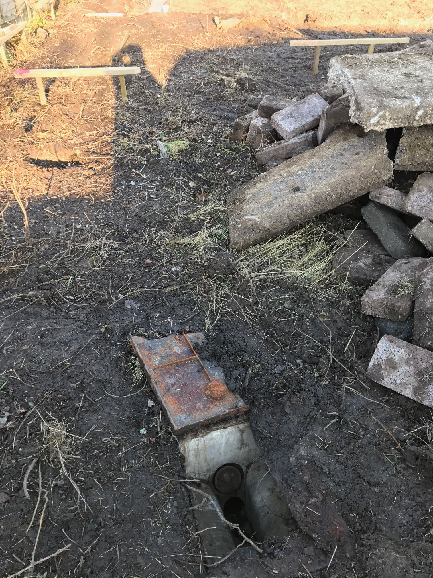

We started site clearing and upon removing a whole load of spoil/brambles we found this concrete box sitting to the south-east of our plot:
As you may know from a previous post, I was quoted a bit of cash to get connected to main sewer as we are going to have to run about 10m from boundary to the manhole. My groundworker believes this may be a previous sewer connection (we have no history of what was previously built on the plot, all we know it had some outbuildings where the elderly owner use to keep his plants/garden. We are having a CCTV survey done on Friday to see where the pipe leads, we are hoping for some good news as this would save us a new kitchen :D:D
Would anyone be interested guess what this may be?

Just now, PeterW said:

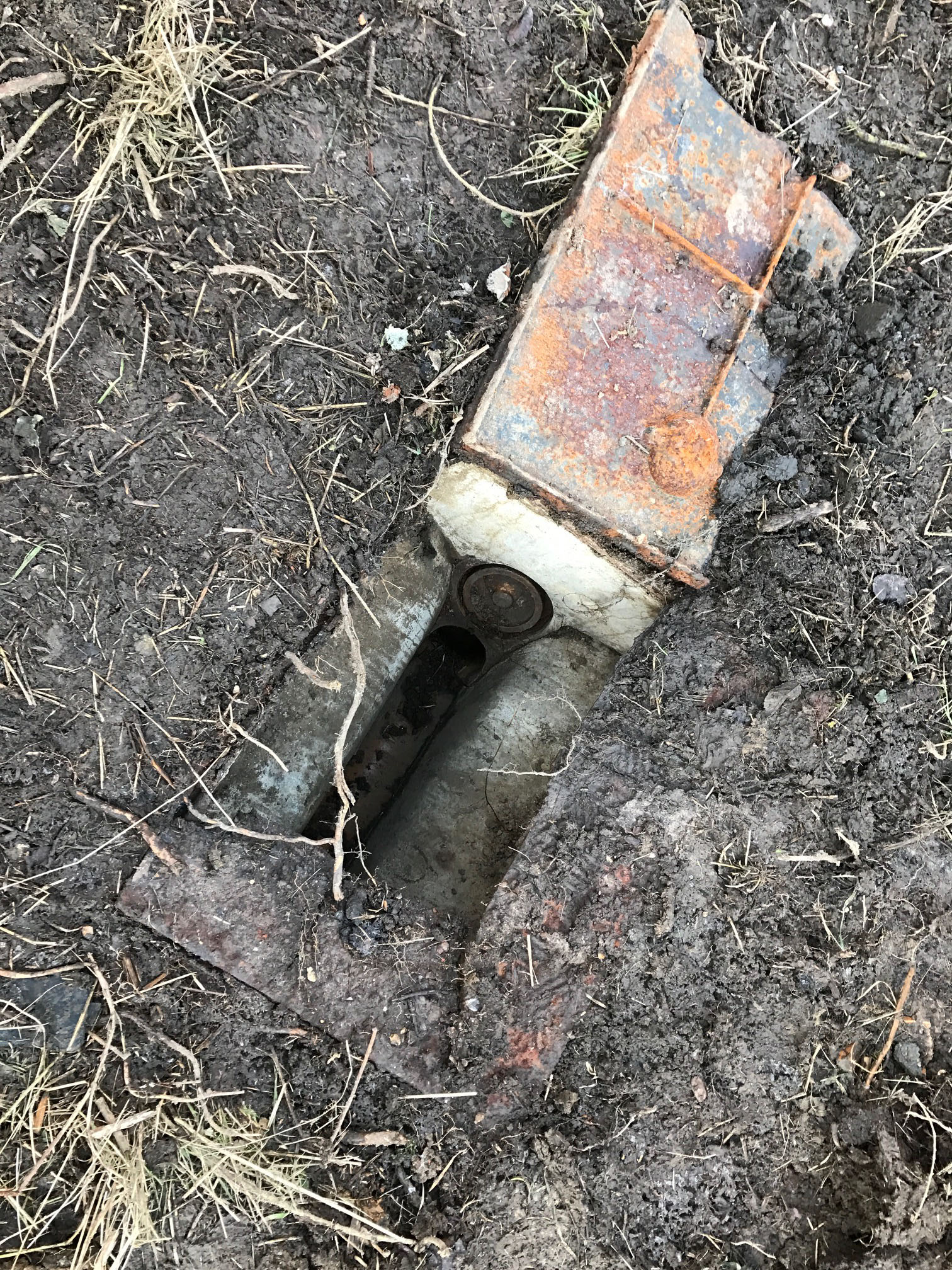

It's an interceptor running to a sewer, most likely the end house on the run.
Well it depends ..!!
That cast plug looks shot to bits so good luck getting it out ...
cctv is fairly pointless unless you know where it goes but what I would do is put a camera in it to start with - break out the plug if you have to as the drop bend will be full of #%€< and then get hold of a signal gennie ("mouse type") and use a CAT to follow it too.
It could save you thousands but only if it's in the right place and only if your sewerage provider say you can connect ..!!
have you done a drainage survey of the area as part of the planning ..?? It should show up if it is still active.
(mouse gennie is also known as a sonde....)

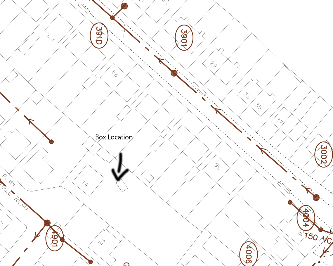

No drainage survey. We have made no application for sewer connection yet since we found this. I do have a sewer map from the authority responsible (Southern Water), here is the location of the box

Put the hose pipe down it and leave it running, if the water runs away you might have a sewer connection! Maybe talk to the neighbour and ask if there's a manhole in their garden, of so take a look down it and see if you have water running, turn the hosepipe off and see if it stops.
Sewers tend to run  in straight lines, if I were a betting man I'd bet it the interceptor connects to the sewer to the left on the plan above.
If it's a working sewer connection you're quids in.
You do need to figure out where it goes, wouldn't do to find out later it that it's been blocked or it comes up in someone's garden. Lift some manholes and chuck some dyed water down the one you found and see if you can figure out where it's going that way. I'd still have the survey done as you need to know the condition of the pipe.

Looking at that map if it goes anywhere then it is through the garden of No.14 and down the back of the houses.
If that is the case then SW would have had to adopt that sewer over the past couple of years under the private sewer scheme - notionally they could ask you for the full cost of connection to that point (it's their sewer now) but more likely they will roll over and just charge you the infrastructure charge for a connection and be done with it.
