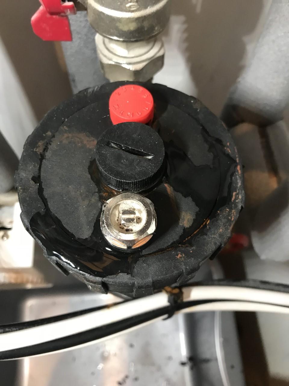

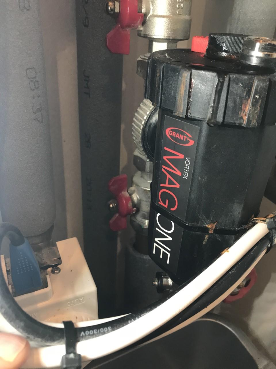

Anyone know of these? Asking for someone on another forum. Apparently leaking around the black cap on top which I take to be the magnet:
Pretty sure on my IntaKlean2 you can remove the magnet without causing a leak like this. Maybe an O ring gone?

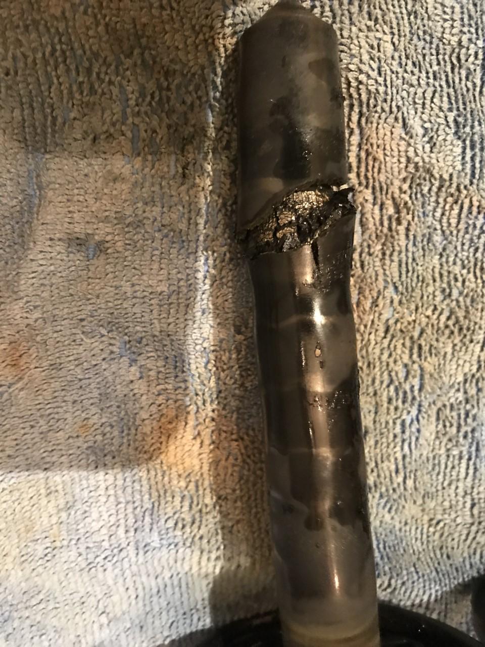

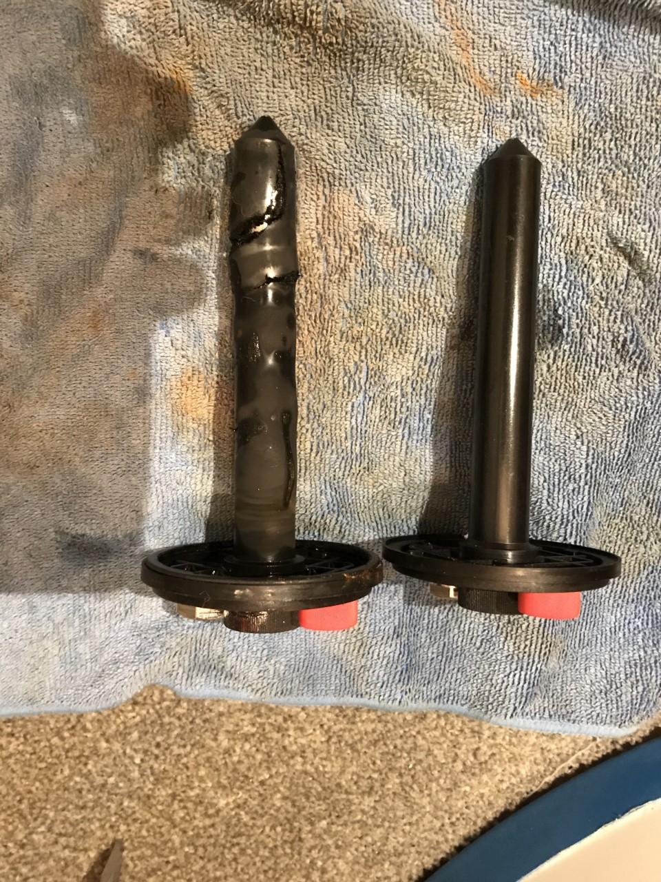

Problem found. The casing round the magnet has disintegrated. Thermal trauma from an overheat / kettling occurrence or something in the water?
