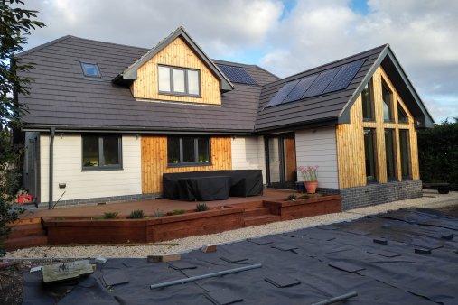

out of interest, did you use one of their designs or your own? Would love to see any pics if you have them!
Hi Helen, I think we were probably a slightly unusual client for Scandia Hus. I'd designed the house as none of their 'standard' designs met our need. The house was totally designed around my wife's needs (due to health, stature and mobility issues) and it was for these reasons in part that we didn't use SH's preferred window and MVHR partners. They were very supportive and great at turning my vision into working drawings. They also suggested some minor but worthwhile amendments (that I'd probably never have thought of) which we really appreciated.
By comparison to most Scandia Hus properties it's also fairly modest in size (165m2 chalet bungalow) so I'm not sure how relevant it would be to your project, but I'll see if I can dig out a few photos.
Edited to add:
We only contracted SH to supply and erect the timber frame. Groundworks and all work beyond the erection of the timber frame was managed by me, calling in specialist trades as needed, but also doing a fair amount of the work myself. I know SH has started offering a 'turnkey' package more recently.
