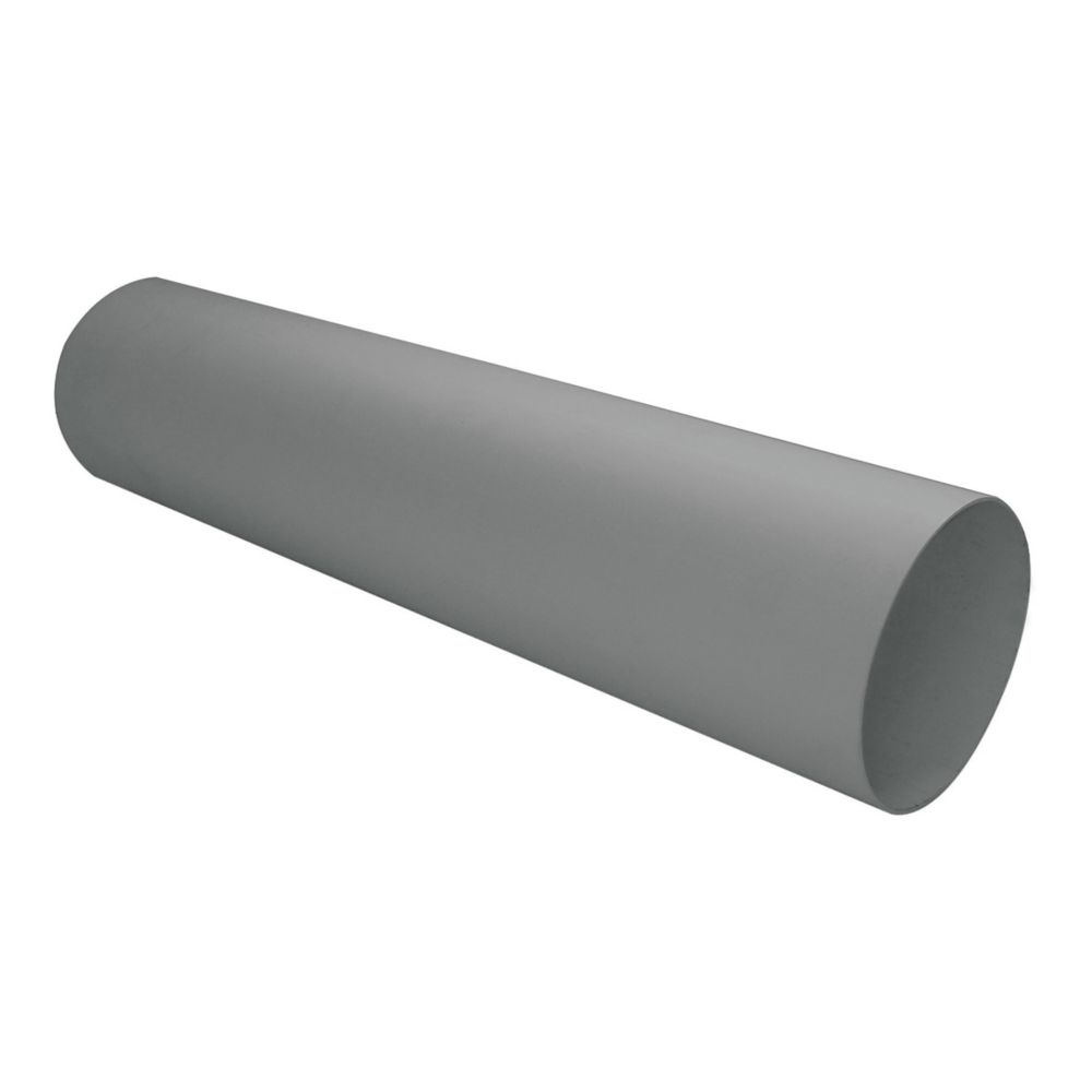

MJNewton Posted November 20, 2020 Share Posted November 20, 2020 (edited) Either solid or the somewhat confusing name semi-rigid: Solid: or Semi-rigid: In all cases the interior is smooth (or relatively smooth in the semi-rigid case) and thus minimises flow restrictions that would otherwise occur with flexible ducting. Edit: I've just re-read that you've got a 'small MVHR' unit... how 'small' is it? I've also just spotted that whilst you've got two vents that's all that's intended on being used? In which case perhaps the 'proper' approach I describing above might not be quite so important and flexible ducting would suffice (like it would with, say, an inline bathroom fan extractor). Edited November 20, 2020 by MJNewton 1 Link to comment Share on other sites More sharing options...

Randomusername Posted November 20, 2020 Author Share Posted November 20, 2020 (edited) 4 minutes ago, MJNewton said: Either solid or the somewhat confusing name semi-rigid: Solid: or Semi-rigid: In all cases the interior is smooth (or relatively smooth in the semi-rigid case) and thus minimises flow restrictions that would otherwise occur with flexible ducting. I’ve got some short lengths of the plastic solid 100mm - can I use a short section as a joiner onto the flexible ducting? There will only be short runs so I’m not sure that flow restrictions will be too much of a problem? Edited November 20, 2020 by Randomusername Link to comment Share on other sites More sharing options...

MJNewton Posted November 20, 2020 Share Posted November 20, 2020 (edited) Perhaps choice of ducting is less critical in that case, and if flexible ducting is acceptable then obviously that flexibility will be to your advantage because it can be clamped down on to the odd-sized vent using a jubilee clip. Edited November 20, 2020 by MJNewton 1 Link to comment Share on other sites More sharing options...
