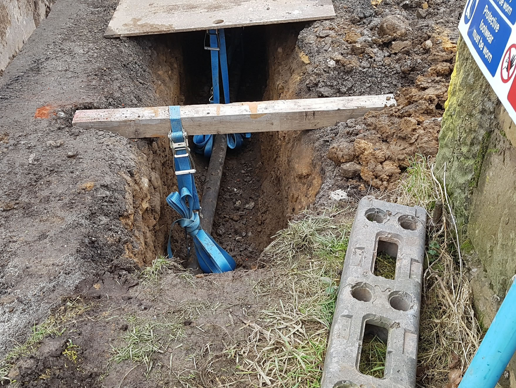

Mine is on Saturday. We are just digging round the water pipe now and suspending it so that the vibration has less effect.

3 hours ago, recoveringacademic said:
[...] We are just digging round the water pipe now and suspending it so that the vibration has less effect. [....]
like this....
pipesupported.thumb.jpg.a94374c13d656c7b3a062e3529e94c3f.jpgsupport.thumb.jpg.713570fa0a2b75a8858fafcc94481dbf.jpg
