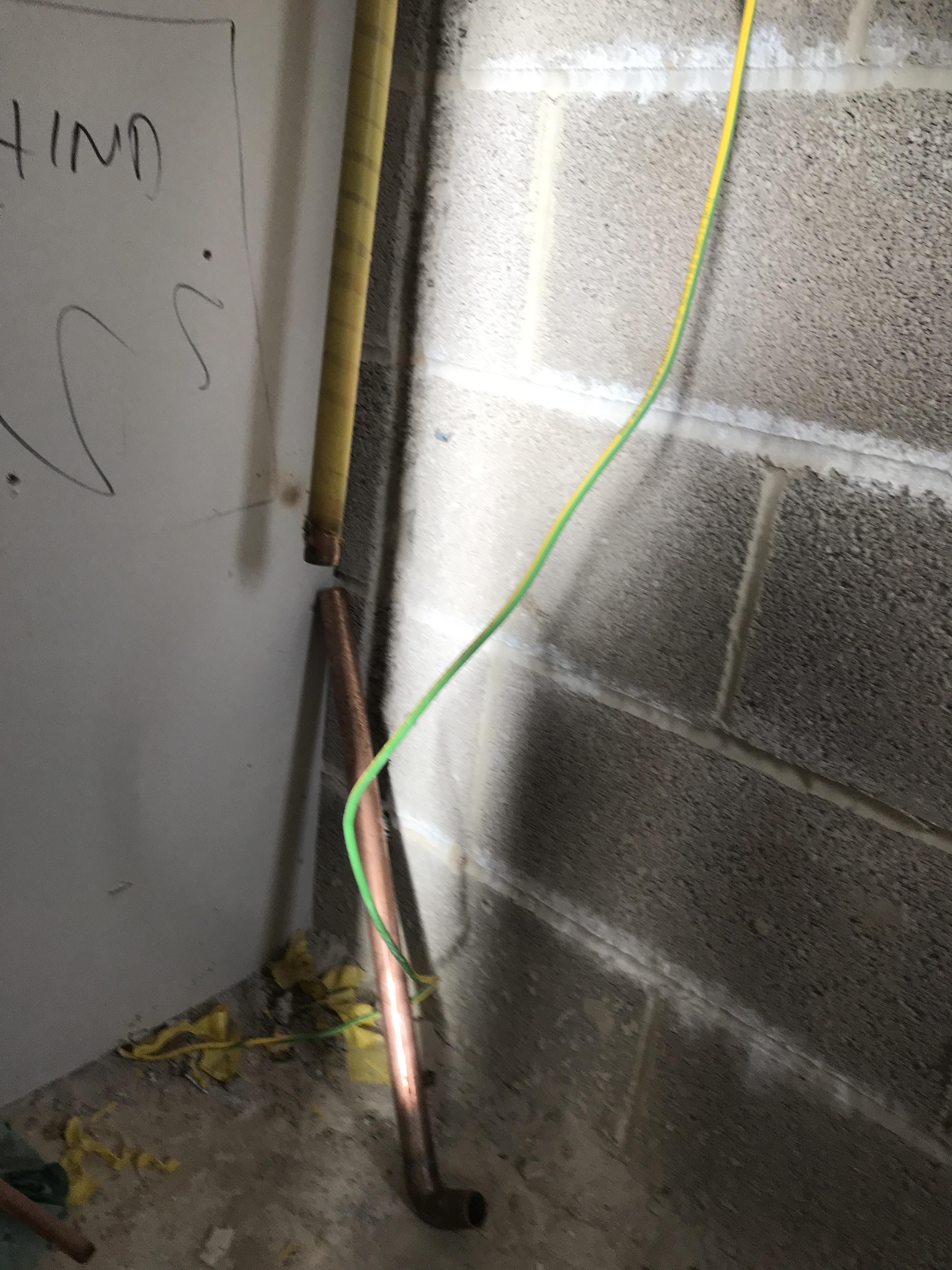

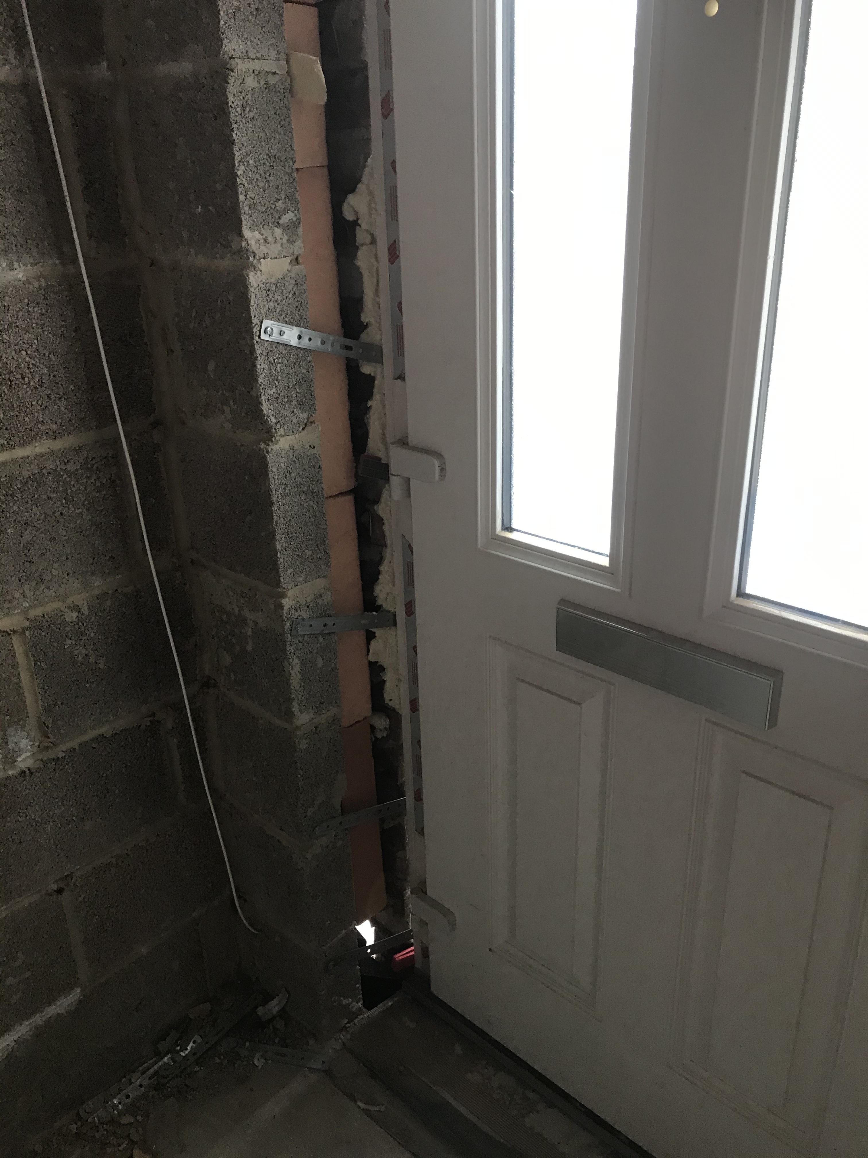

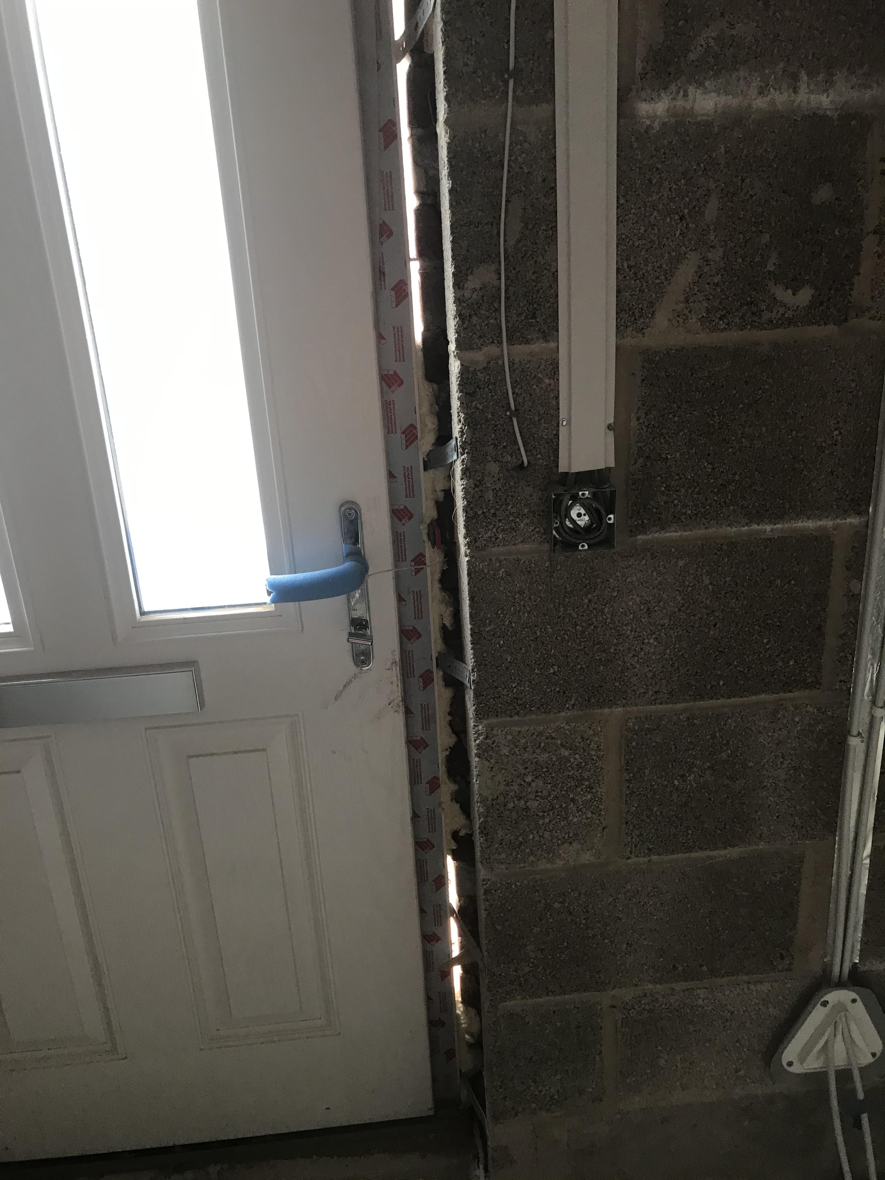

nod Posted November 2, 2020 Share Posted November 2, 2020 These design and build houses are scoring 2 on the air tests BC is ignoring many of the issues and there’s a lot Link to comment Share on other sites More sharing options...
Dave Jones Posted November 2, 2020 Share Posted November 2, 2020 shocking. not even an attempt at a cavity closer. Link to comment Share on other sites More sharing options...
nod Posted November 2, 2020 Author Share Posted November 2, 2020 The lads that are in there have rung me to say the site manager has been dogging them about making sure of a continuous dab For the air test I’ve just rung him and he’s not bothered They are air testing every property and they are all scoring the required two Air testing can be such a joke Link to comment Share on other sites More sharing options...
