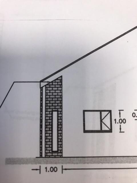

Hi.Is there any thermal bridging issues with an overhanging roof . Mine will stick out about a metre from The front wall.
I think not but just checking
Posted
No.

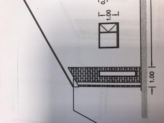

The only issue would be if there was going to be a room up in the roof and the floor of that was in the overhang but the drawing makes clear that's not the case.
Rotated to save necks.
