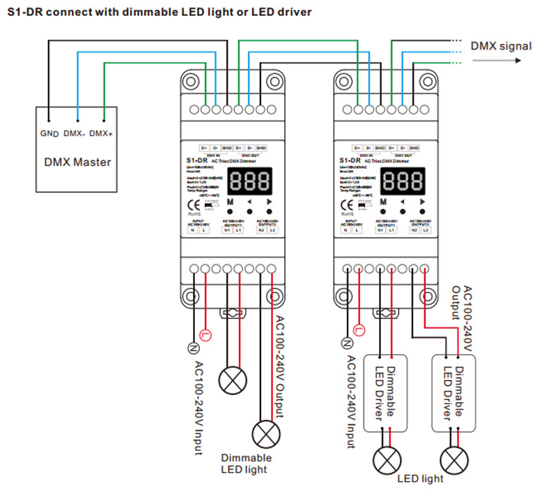

Can I also check please, is it correct that just these items are required for 230v dimming:
Loxone DMX extension
S1-DR AC Triac DMX Dimmer 2 Channel
Note the 240v triac dimmer you originally linked appears out of stock, but the one I linked here looks equivalent.

Yes that's the ones. They work fine, but have 1.5W vampire load each which over 16 adds up (and makes the cupboard quite hot). You can mitigate this by using a higher powered SSR to shut them all off when not in use. (Loxone makes this very easy to do).

On the Aliexpress S1-DR vampire load, how will Loxone know that a dimmer is not in use? When this is detected, you use a relay to break the 230v Live supply at bottom left on the unit labelled "AC100-240V Input""?

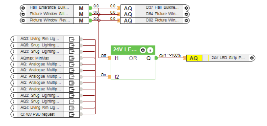

Loxone is driving the DMX dimmers so knows when any channel on it is set to >0 brightness, so you can split this out to a big OR block to say "if any of these DMX channels are non-zero, turn on the relay to power up the dimmer bank"
I use something similar to shutdown the 24V LED lighting power supplies when not in use:
 Yes that works fine.
One tip is as dimmers work by modulating the L feed, not N, I did figure out I could route the N from the LED fixtures directly back to the RCBO not via the dimmer, and then if I used a relay on the N terminal of the dimmers only it was only having to switch a much lower current (i.e. just breaking the current needed to power the dimmer internal logic, not the current needed to drive the LED fixtures themselves). This is a sneaky trick though (generally switching N is frowned on, right).

Thanks, @joth really helpful. I suspected it was logic in Loxone Config - this will save time and head scratching.
