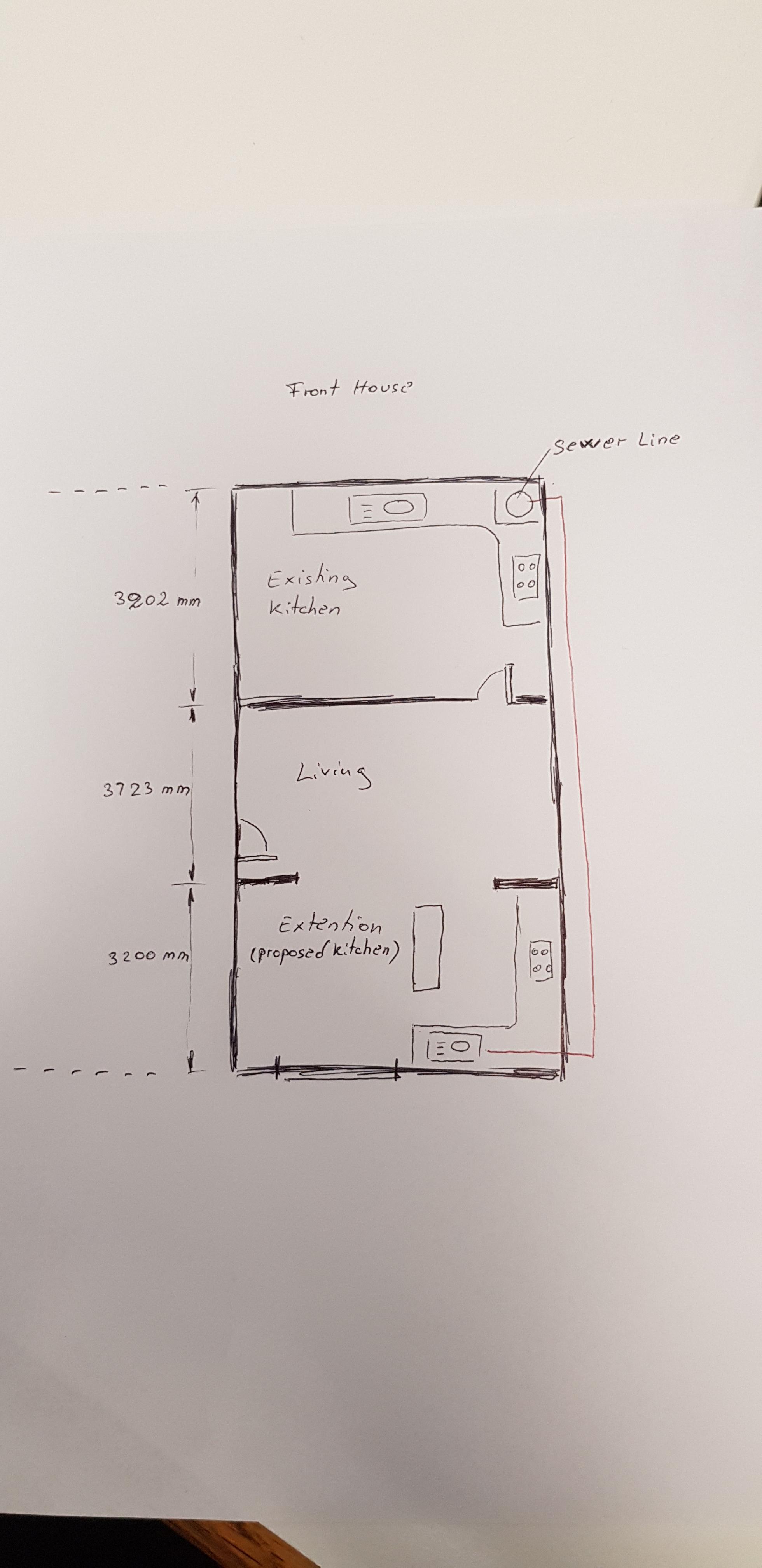

Roman Posted August 8, 2020 Share Posted August 8, 2020 Hi all, Please help with a suggestion what do you think will be the best option for my kitchen plumbing. I have in plan to build an extension and to move my kitchen there. The main issue is that the kitchen sink drain pipe I have to run it inside the ceiling using a pump or building a box near the side walls. From the new kitchen to the sewer pipe is a long distance approximatively 11m and the house is terraced house. Neighbours on both sides and I cannot go from outside. Is gone be a dishwasher and a washing machine connected as well to the same drain from the proposed kitchen. Link to comment Share on other sites More sharing options...
ProDave Posted August 8, 2020 Share Posted August 8, 2020 Do you have timber floors? If so it would be much better to connect lower down the stack pipe and run a new pipe under the floor. Link to comment Share on other sites More sharing options...
Roman Posted August 8, 2020 Author Share Posted August 8, 2020 Nope ....it is a solid floor . Link to comment Share on other sites More sharing options...
