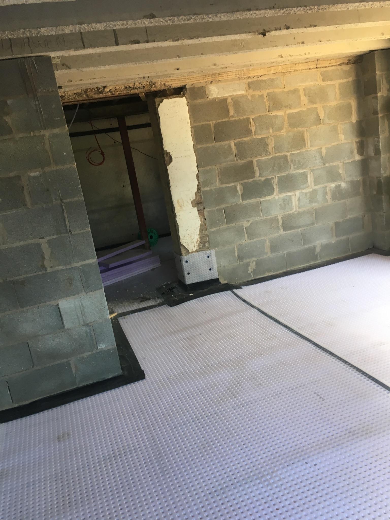

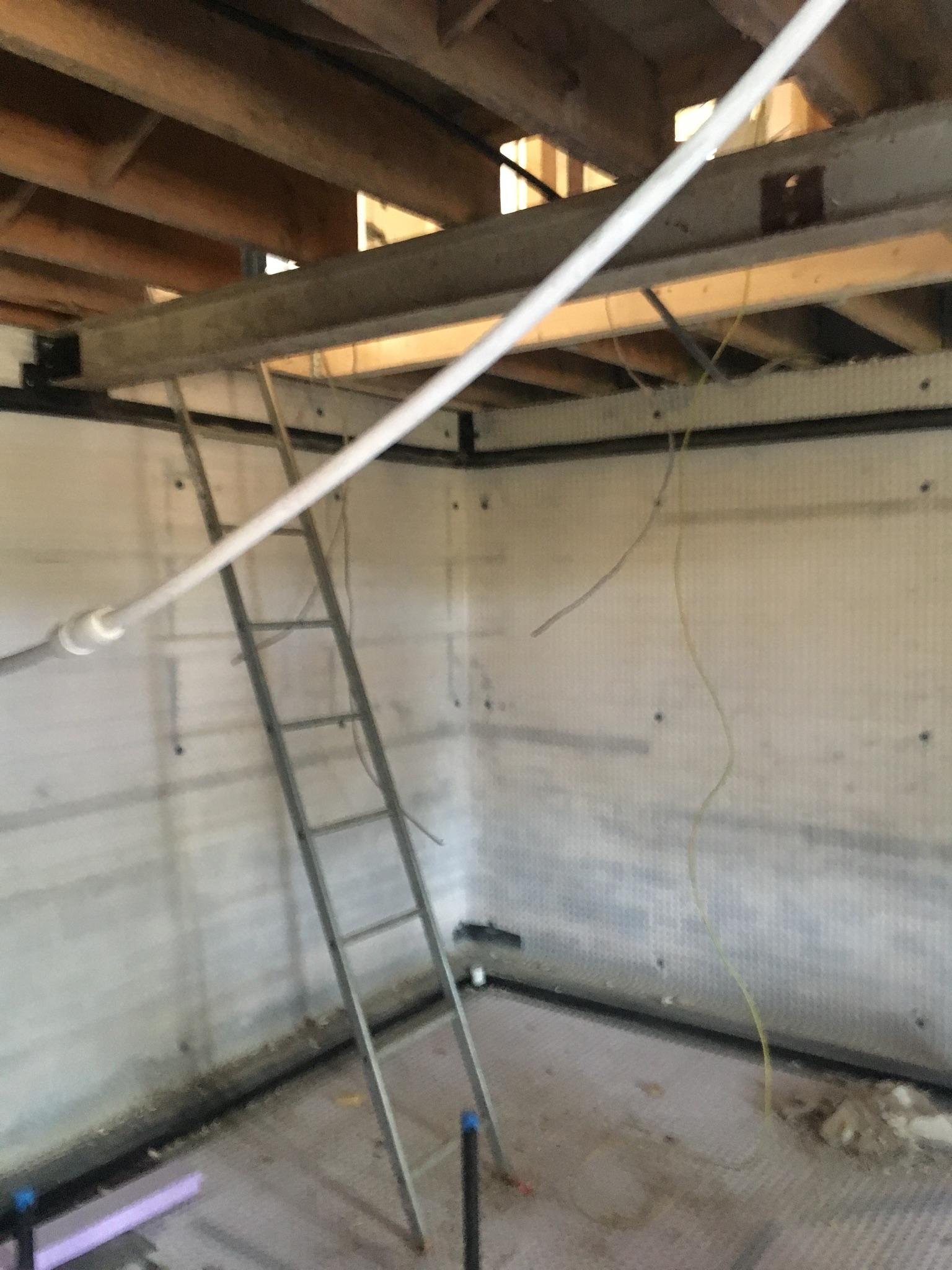

This is a cellar I did last summer
Similar to to your plan
With a perimeter drain around the edge

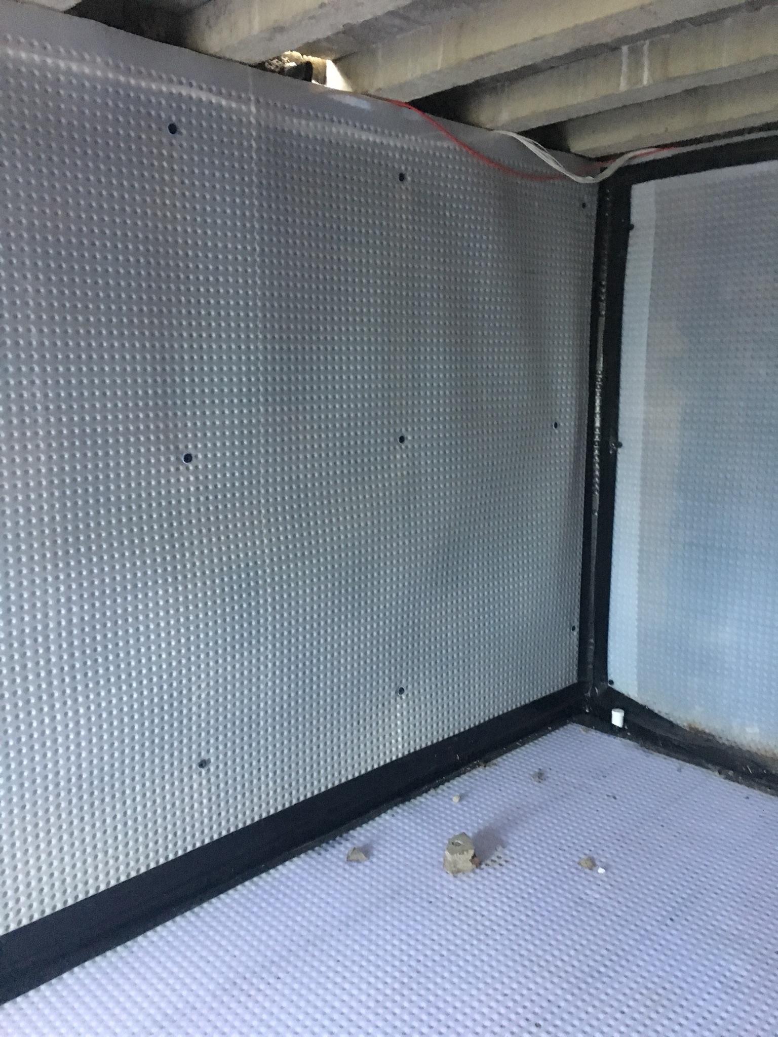

We use a 50 mil I stud stood 15 mil off the walls

Wow that looks a great job - do you think the gravel/sand/membrane/insulation/slab  idea will work not seen that before ?

The conditions should be nowhere near as damp as a cellar
Ive damp proofed barns like yours with a membrane and no drain

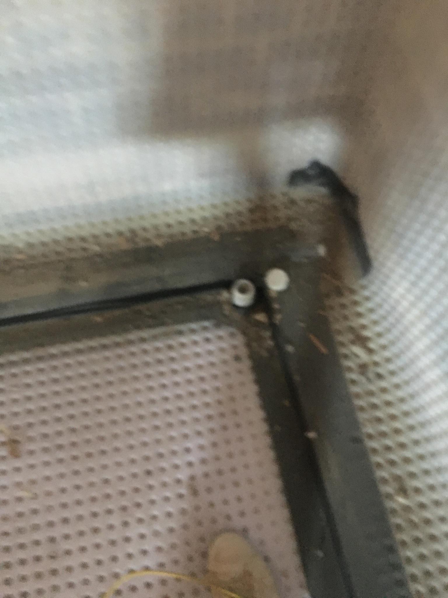

Remember to fill each hole drilled with sealer before knocking in the plug
Also your plugs should be set out with the dot and dab in mind
300 apart vertical 600 across
  Good luck
