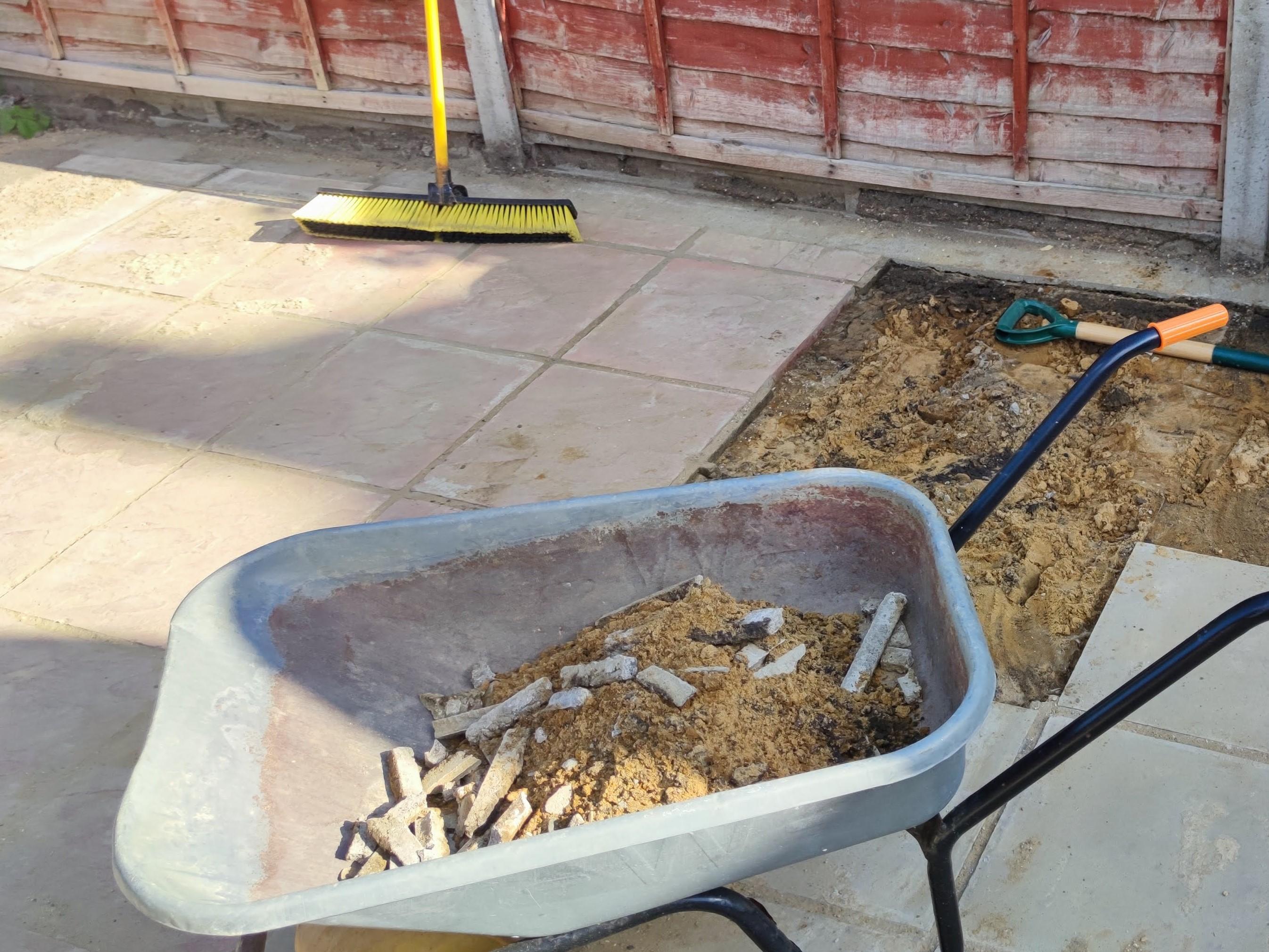

Would it be okay to do another round of weedkiller and then after 2 weeks roll the turf? Do I need to prepare the soil for the turf?
I have started removing the last layer of slabs, there is still some more sand (see picture). A very thin layer that is mixed with the soil (it is almost impossible to remove the sand without digging out also some soil). Do I need to remove it before installing the turf?
Yes weedkiller, then level ground and rake top 15mm so turf roots can get going and lay turf and water regularly unless you get significant rain. We haven't had a decent amount of rain in months.
Don't worry about a small amount of sand just rake it in with the soil.
