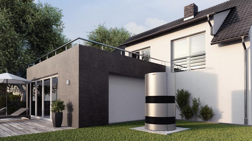

And if all else fails, "own it" -unapologetically  sling one of these in the middle of the garden:
Thanks joth! Yeah MVHR and even one of those inline cooling kits would be top of mind here. Anything noisy and anything that  would need some ducting towards the surface.
OK, I think you're on the same page around the position of the thing. I guess it might be helpful to get an idea of how tall these things are (to know where to let my windowsill start..)
I liked the idea of mounting it on a side wall above my head (so thats at 3m then.. :) ) but the problem is that the neighbour's garage is only 2m tall which means he will have a view of the thing. To be fair, the only side window there is a stair so maybe not a big problem for him..
The viesmann unit looks interesting.. although I am struggling to imagine (maybe I shouldn't..) why they call it attractive - rule 34 I guess.
