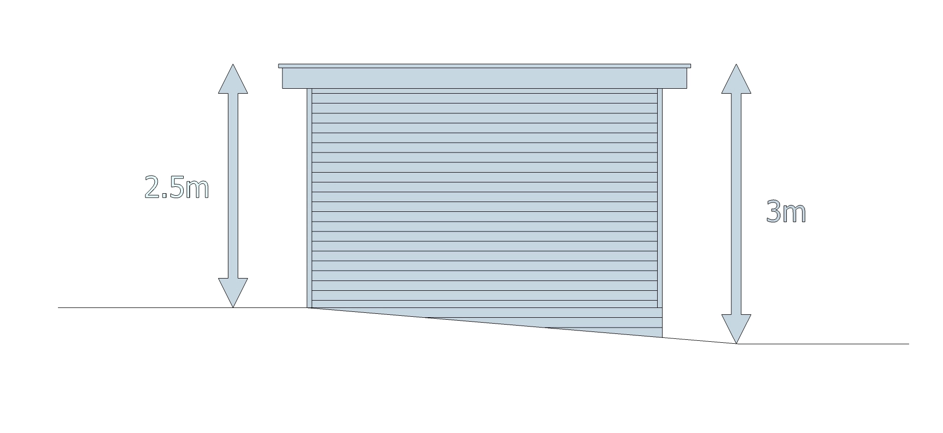

It has to be under 2.5m within 2m of the boundary. Elsewhere the eaves must be 2.5m but the rest can be upto 3m (for a single pitch roof) or 4m (for a dual pitched roof). So it might be possible to slope the roof down from the patio doors towards the boundary depending on layout. Is in the corner of the plot?
Edited by Temp
Also the 2.5m is from the highest ground level next to the building.  So in theory you can sink it into the ground on one side to achieve more height.  This is what we plan to do.
Another way of maximising height is by using a level-threshold.
