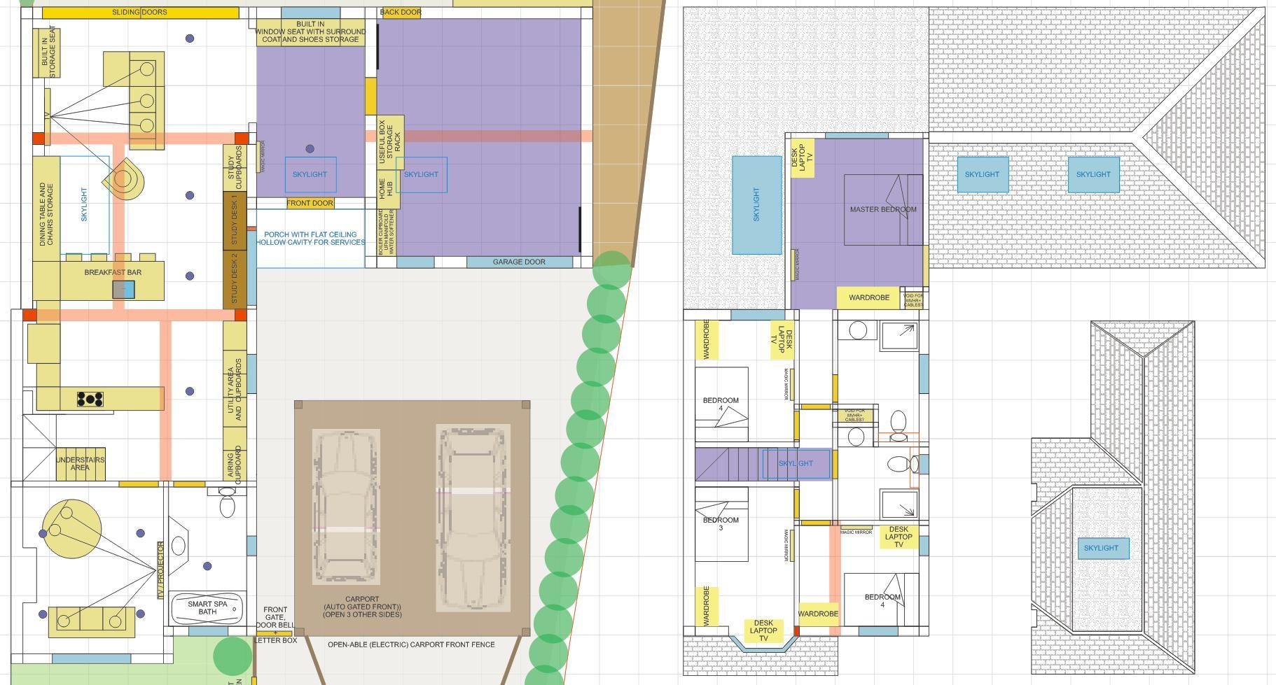

Hi all,
We are renovating our 3 bed 1930 semi detached (will become 4 bed).  It is as I bought it a decade ago, is a single thermostat driven central heating system.  The house is too warm in summer, cold in winter (varies by room).  Renovation will include solid floor with WFH, double/triple glazed windows, perhaps EWI, hoping with a precise builder and some air gap hunting from me we end up with a close to airtight envelope that I have the opportunity to manage.
Plan is to have MVHR (BPC have recommended a Vent Axia Sentinel Kinetic FH (310m3/hr) for my 180m2 footprint (130 downstairs, 50 upstairs)) for our fresh air requirements.
Have read most posts remarking that, should you be building an insulated home with a decent amount of glazing, piping for an air conditioner seems sensible.  I have seen single and split units, but I can’t find much advice for where to place the internal units so they are most effective.  Would just one upstairs and one downstairs be sufficient, or really is a split unit per bedroom and living area advisable?  If a unit per bedroom is overkill (certainly expensive), are circulating ceiling fans worthwhile at night for when bedroom doors are closed, as then presumably they not getting access to the air con in the hallway.
I assume there will be nights when the window being open won’t necessarily bring in cool enough air for a comfortable in-room environment.  Perhaps my children may begin to suffer from tree or pollen allergies as they grow up perhaps making open windows undesirable at night.  Plus the foxes scream in the streets most nights.  I would like the flexibility to have cool rooms without opening windows if possible without substantial cost.
The direction I am being persuaded by a tech friend is that comfort cooling with the MVHR would at least handle the night time cooling requirement to bedrooms, does anyone think this is accurate?  If it were, I might only have to provision for AC downstairs i.e. the daytime areas.
Also, for any air con solution (perhaps something like this https://www.appliancesdirect.co.uk/p/iqool-3ms9k9k9k/tcl-iqool3ms9k9k9k-air-conditioner), what home climate management system do people use?  I have been recommended Honeywell EvoHome, given you can thermostat 12 rooms / locations, but don’t think it is able to manage AC for you, you would have to do that yourself manually, or perhaps something like Home Assistant IO can manage your climate heating and cooling?
On the floor plans attached, please note the purple areas are vaulted, and the image of the main roof is not to scale.
Many thanks
JT

Can anyone say where they would place AC units on my house design?  How many and where?
Or are ceiling fans in bedrooms and living spaces the right approach?
Many thanks
JT
Edited by tanneja
Size is partly down to the volume of air that needs to be moved.
Location is generally in opposite corners, away from doors and windows.
The main problem is that air does not store much energy (1 kJ/kg.K), so to heat or cool 1 m3 of air, which has a mass of ~1.2 kg, you need to use 1.2 kJ of energy, plus the energy to move it, but that is very small in the scheme of things.
This page can be used to calculate how much power and at what flow rates are needed.
https://www.engineeringtoolbox.com/water-flow-rates-heating-systems-d_659.html
You just need to substitute the specific heat capacity of water (4.2 kJ/kg) for air (1 kJ/kg), and the density of water (1000kg/m3) for air (1.2kg/m2).
