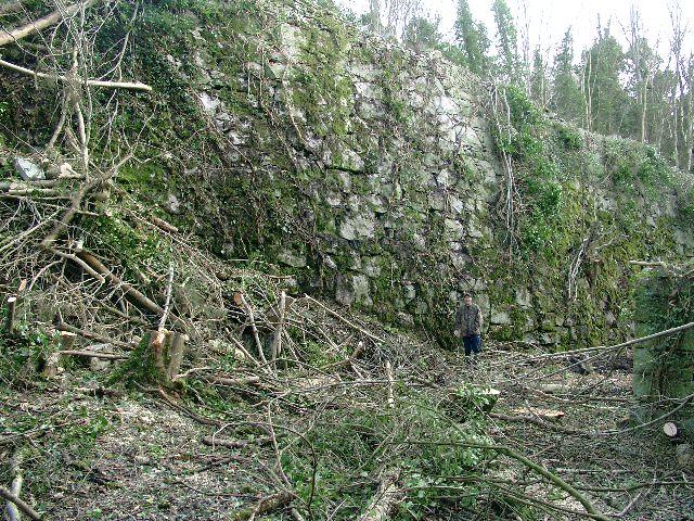

scottishjohn Posted April 18, 2020 Share Posted April 18, 2020 (edited) yours is very small compared to mine which was also built 150 years ago from dry stone blocks we have been tracking up and down it with a 14ton digger --you can,t even feel any vibration in the ground as digger passes you see the size of it look at the man at bottom he is close to 6ft tall Edited April 18, 2020 by scottishjohn 1 Link to comment Share on other sites More sharing options...
