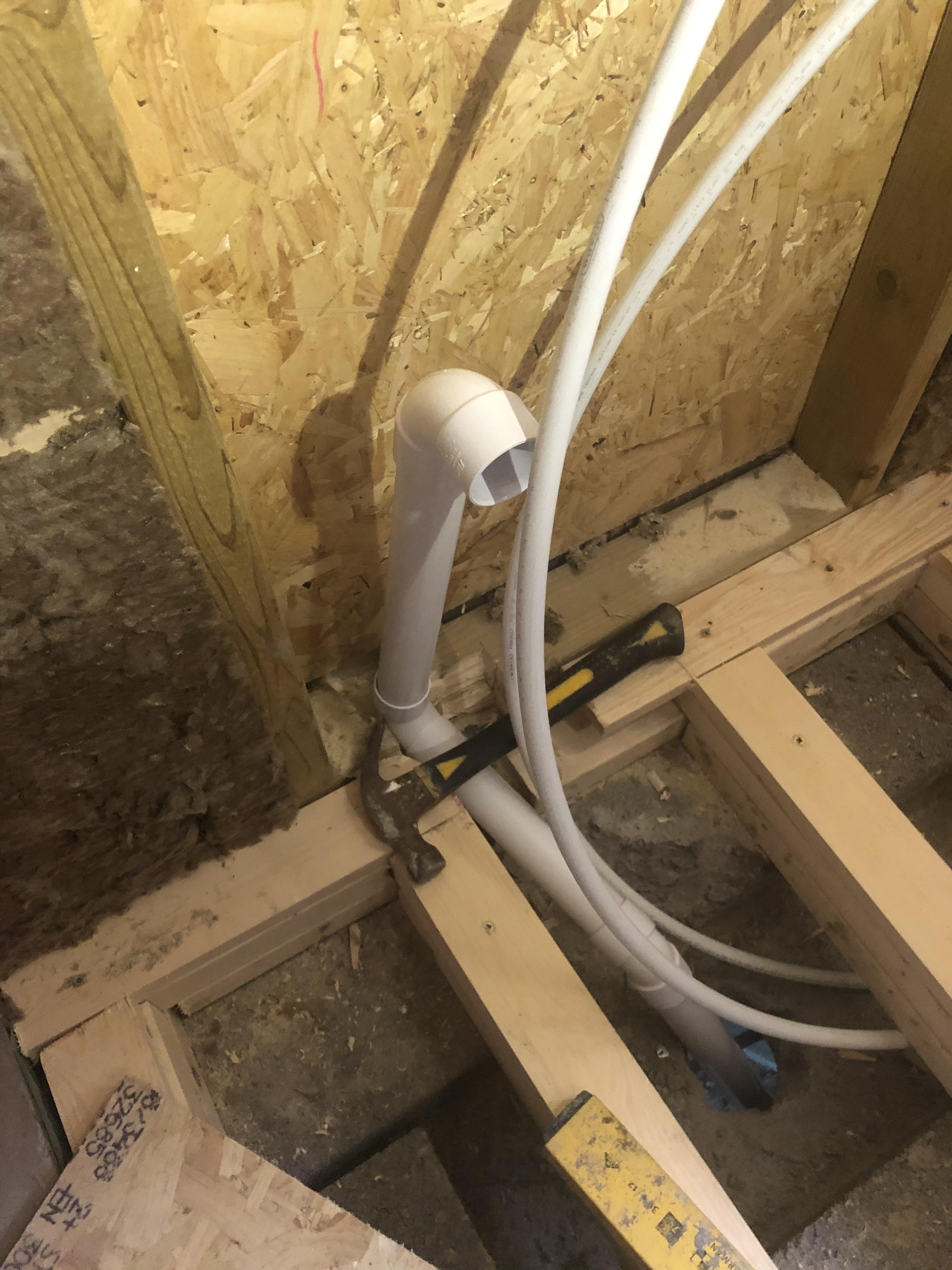

Pocster Posted March 16, 2020 Author Posted March 16, 2020 Just mocking up the basin waste . Hard not to use a 90 degree tee . Looks like linking white waste pipe ( left poking through ) into black soil might be fun . How far ‘around’ the soil pipe should the boss strap be ? - I assume as high as possible ??
