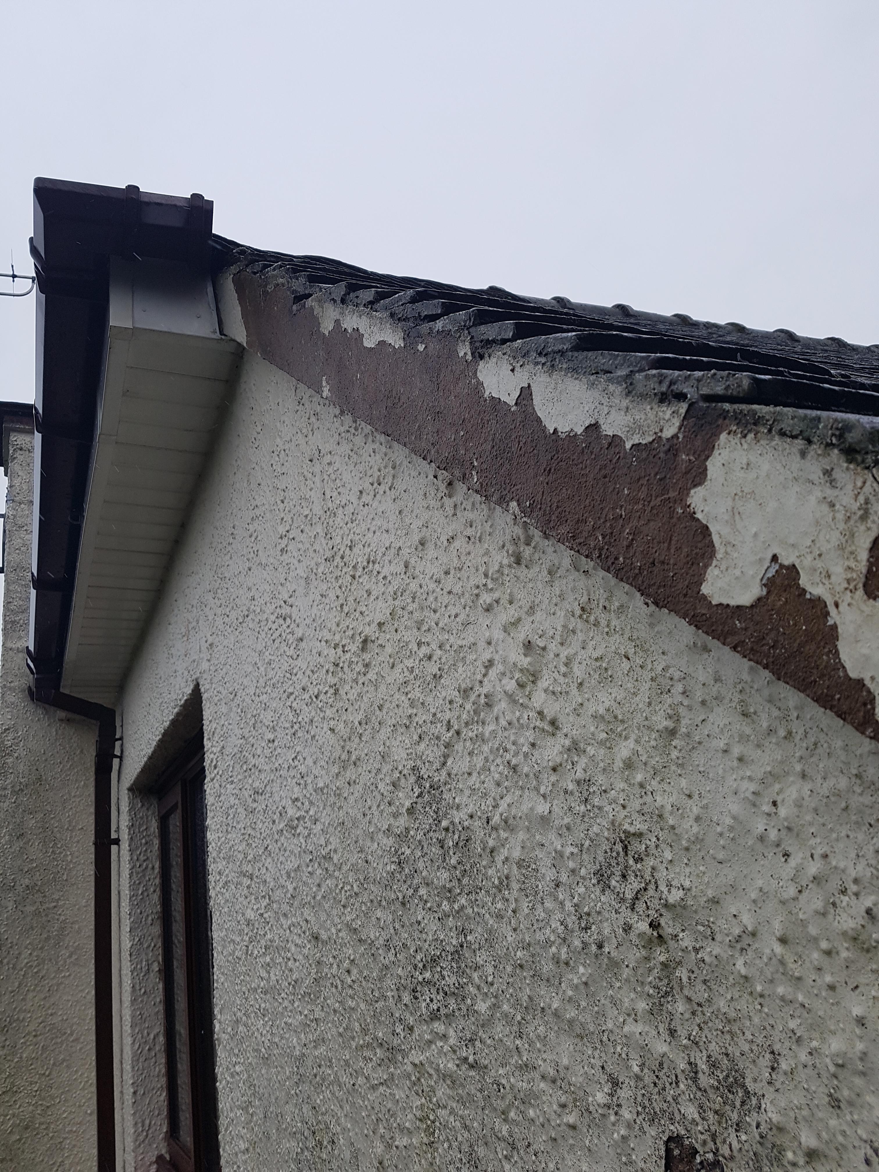

Moonshine Posted February 16, 2020 Share Posted February 16, 2020 On one of the most exposed walls of my house I am getting water ingress, that looks to start at the top, gets behind the render / paint at the top where it meets the tiles, then and into the wall The attached image is the verge, which I have taken the paint / render off, which was flaking at the top where it met the tiles acting like a rain funnel. Also of this was easy to get to off as it was coming away anyway The design of the verge isn't great as the tiles don't fly over the wall edge. Most dry verge systems I have seen are based on the tiles flying over the wall by some margin Simply this could be a upside down 'L' profile shape that overlaps the tiles by a good margin. Other thing I could drop box a put a batten down the existing masonry section that the dry verge would fit to, this could be a kind of 'C' profile with a longer top to overlap the tiles. Thoughts? Link to comment Share on other sites More sharing options...
Jeremy Harris Posted February 16, 2020 Share Posted February 16, 2020 We used the Kytun aluminium dry verge, which doesn't need much of a projection. Our roof is "slate", so we used the thinner version, but they do something very similar for tiles: https://www.kytun.com/c/tile-dry-verge/8 Link to comment Share on other sites More sharing options...

Moonshine Posted February 16, 2020 Author Share Posted February 16, 2020 12 minutes ago, Jeremy Harris said: We used the Kytun aluminium dry verge, which doesn't need much of a projection. Our roof is "slate", so we used the thinner version, but they do something very similar for tiles: https://www.kytun.com/c/tile-dry-verge/8 On looking at that, the profile seems to suggest it needed to go under the battens and more of a product to be fitted when built rather than retrofit Link to comment Share on other sites More sharing options...
Jeremy Harris Posted February 16, 2020 Share Posted February 16, 2020 Just now, Moonshine said: On looking at that, the profile seems to suggest it needed to go under the battens and more of a product to be fitted when built rather than retrofit The version we used fits above the battens and under and over the edge of the slates, with a drainage channel to ensure any rain that does flow over the internal edge flows down to the gutter. Being very thin aluminium, it is fairly easy to fit, although it has to be opened up and sprung over the edge of the slates. Link to comment Share on other sites More sharing options...
Mr Punter Posted February 16, 2020 Share Posted February 16, 2020 Kytun do retrofit ones as well. I guess you would need to fix to the render with CT1 plus mechanical fixings (stainless screws?) every 800mm of so. https://www.kytun.com/p/retro-fit-tile-dry-verge-alu-50mm-blue_black-24m/c08esbb Link to comment Share on other sites More sharing options...
