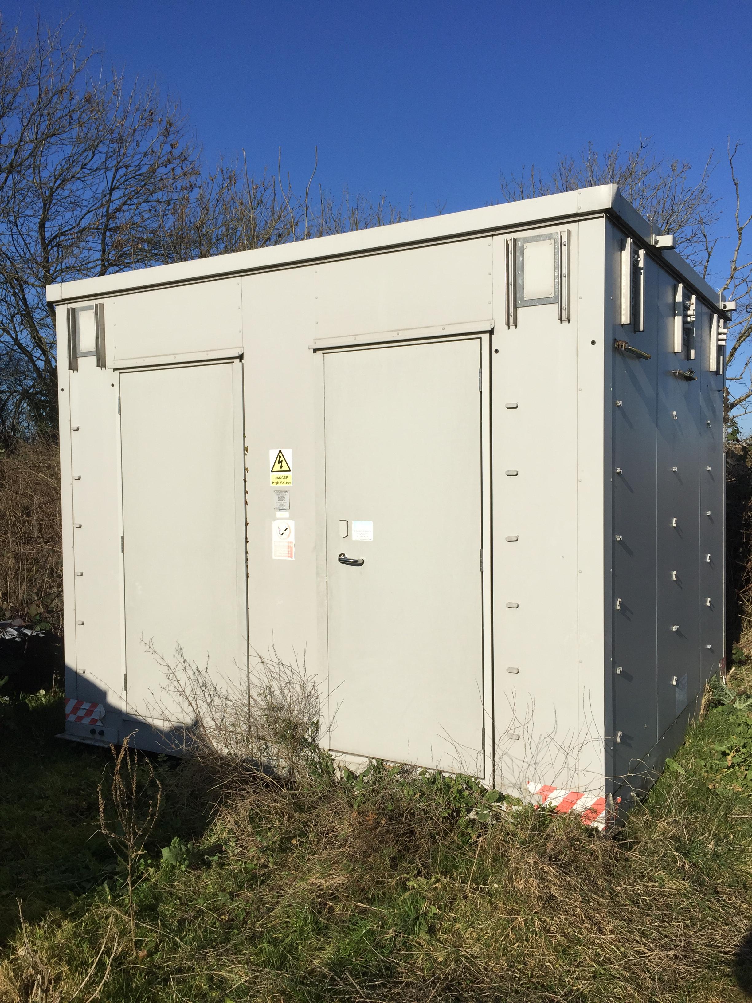

willbish Posted February 14, 2020 Share Posted February 14, 2020 I've been offered a piece of land to rent, somewhere I can put my cabin and the rest to be used as an allotment. There is an overhead Low Voltage power line running across the land and a telegraph pole close to where I would sit the cabin. Is it possible the DNO would allow a new connection to the cabin? I guess they'd see it as a temporary structure without an address, would this make it ineligible? My thinking would be to have a prepaid meter, on a tarif without a standing charge, exactly like I have on site at the moment. Link to comment Share on other sites More sharing options...
Mr Punter Posted February 14, 2020 Share Posted February 14, 2020 I don't see why you could not get a new connection. Expensive though. The meter and tariff will not concern the DNO. Link to comment Share on other sites More sharing options...
willbish Posted February 14, 2020 Author Share Posted February 14, 2020 Prices from £450+Vat and this should be as simple as a connection could be. I will make some enquiries with the DNO, but I'm wondering whether I'll have to say it's a business premises as it certainly isn't a dwelling. It might be the dog house though if I don't get off the internet on valentine's Day Link to comment Share on other sites More sharing options...
