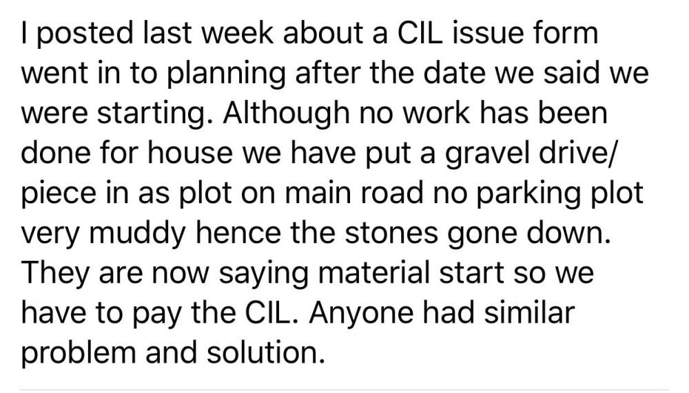

A post from Facebook shared with permission. Councils seem to be on a mission to find any reason to disallow a CIL exemption. This is another example where the plot owners laid stones at the entrance to stop mud getting on the road.

Also what happens if someone tidies up a plot with full PP before marketing it? Are the new self builders who purchase the plot laying themselves open to having purchased a plot where a CIL exemption is disallowed from the get go on the strength of a bit of tidying up of the plot being considered a ‘material start’.
Surely a material start should be what’s needed to lock in PP by making a proper start and I doubt that gravel at the entrance would qualify.

Turns out that there was an original PP, they got a CIL exemption for that, sent the commencement form in, dug a trench and laid the stones. They then decided to change the house design so put in a brand new planning application that was passed. A new CIL exemption was applied for and they sent the commencement form in but dated 3 days before the council received it so the council queried the start date. They hadn’t actually started anything at that point but the council claim that laying the gravel (before the new PP was even issued) is a material start. They are going to appeal. 32k at stake!
