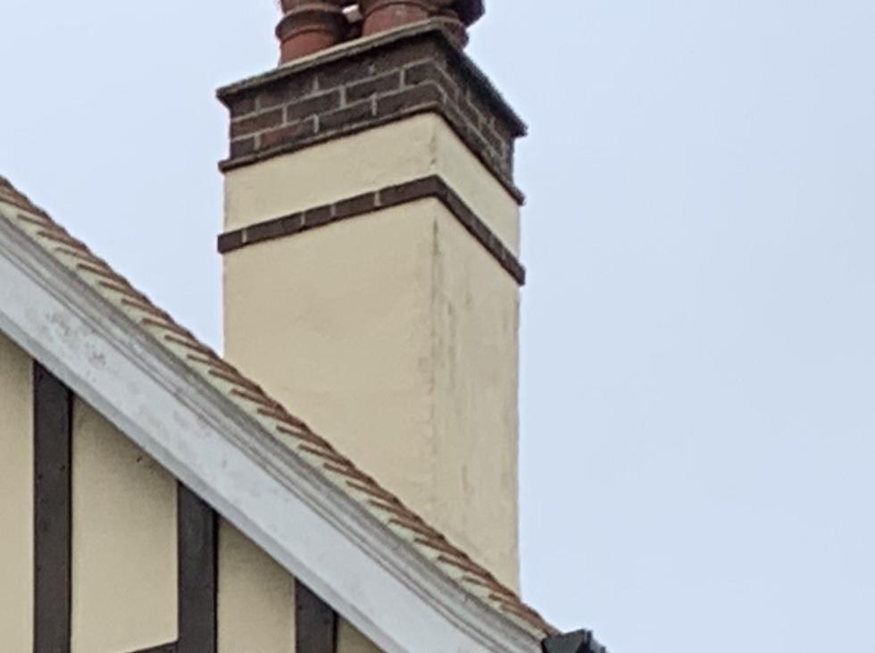

Robert Clark Posted January 27, 2020 Posted January 27, 2020 (edited) Hi Guys We have two chimney stacks about 1.5m high. They have painted render panels. We’re trying to make them maintenance free as we are doing away with painted render on the rest of our house, so are looking for ideas on how to achieve this. Would it be feasible to remove the render without damaging the bricks underneath? Any suggestions would be appreciated. Also I’ve noticed that the flaunching needs replacing. Edited January 27, 2020 by Robert Clark Added pic
nod Posted January 27, 2020 Posted January 27, 2020 It would be quite difficult not to damage the brick If the render is original the bricks underneath may not match the facing bricks 1
Robert Clark Posted January 28, 2020 Author Posted January 28, 2020 8 hours ago, nod said: It would be quite difficult not to damage the brick If the render is original the bricks underneath may not match the facing bricks In which case it my be that the stacks will have to be re built. The render on the rest of the first floor is being replaced with tile hanging. So leaving the chimneys as they are is not really an option
