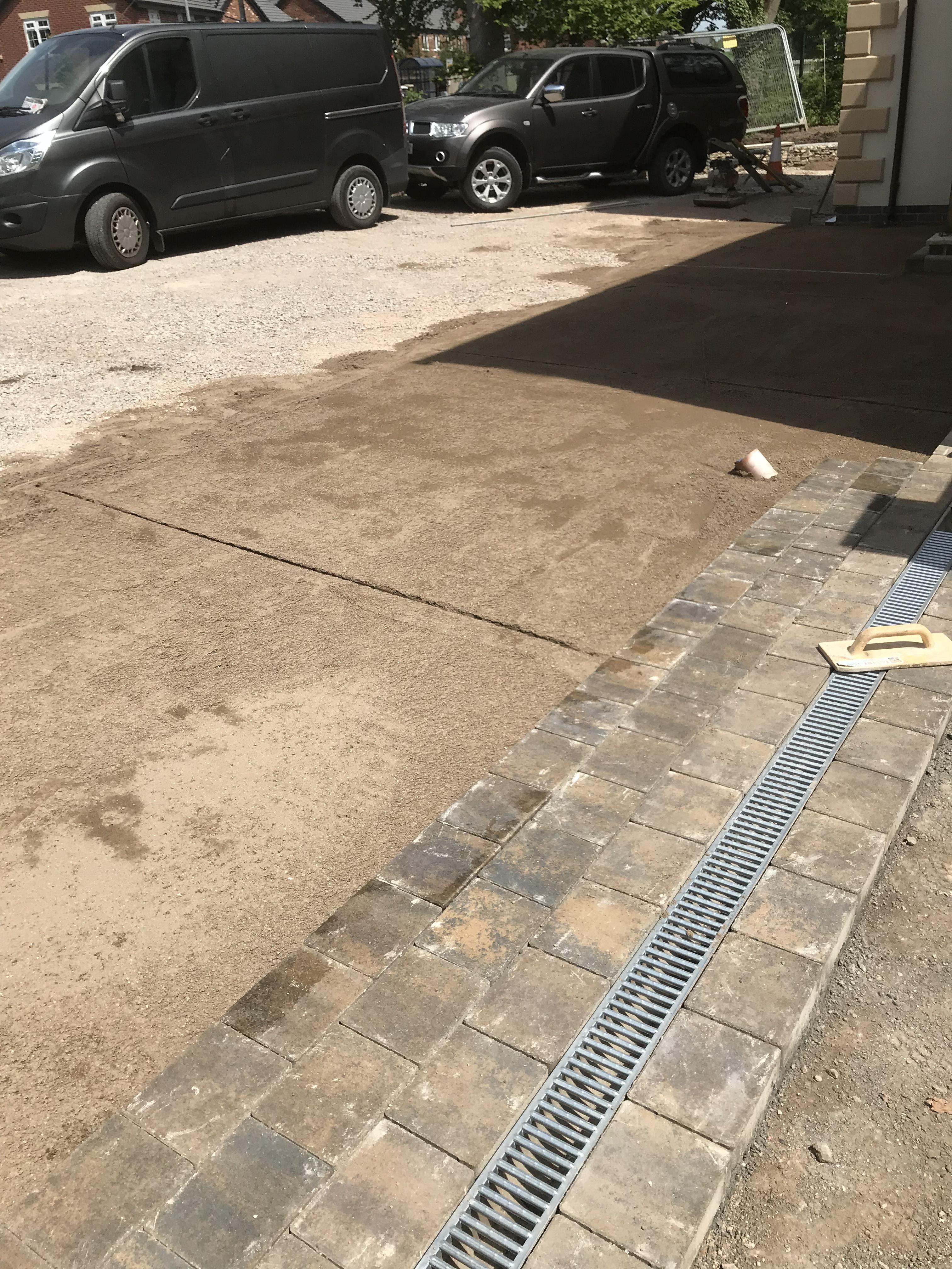

nickw Posted January 26, 2020 Share Posted January 26, 2020 Looking to put some in the driveway and also in front of garage ...any particular make that is better than the rest or are they all about the same. thanks Link to comment Share on other sites More sharing options...

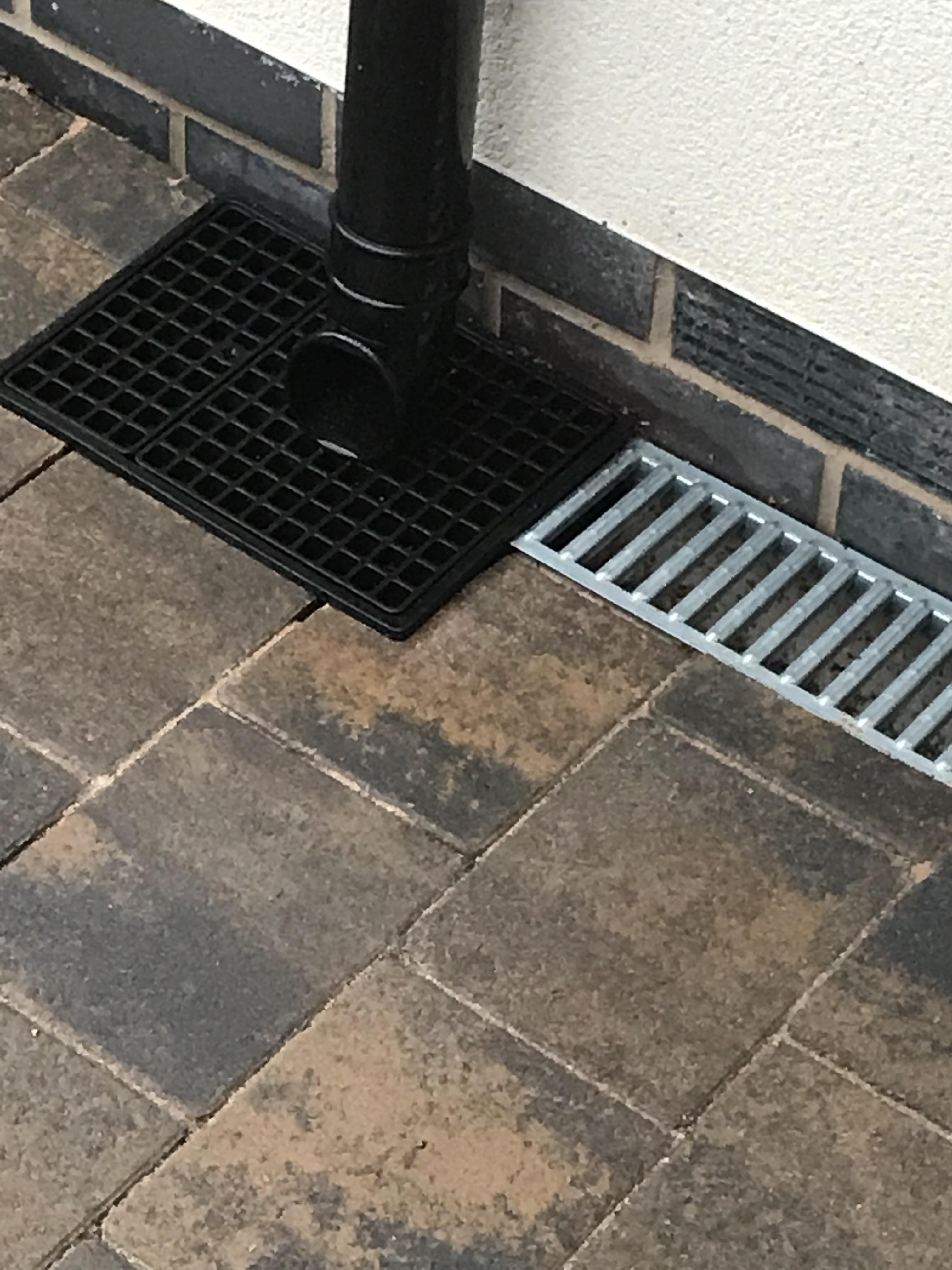

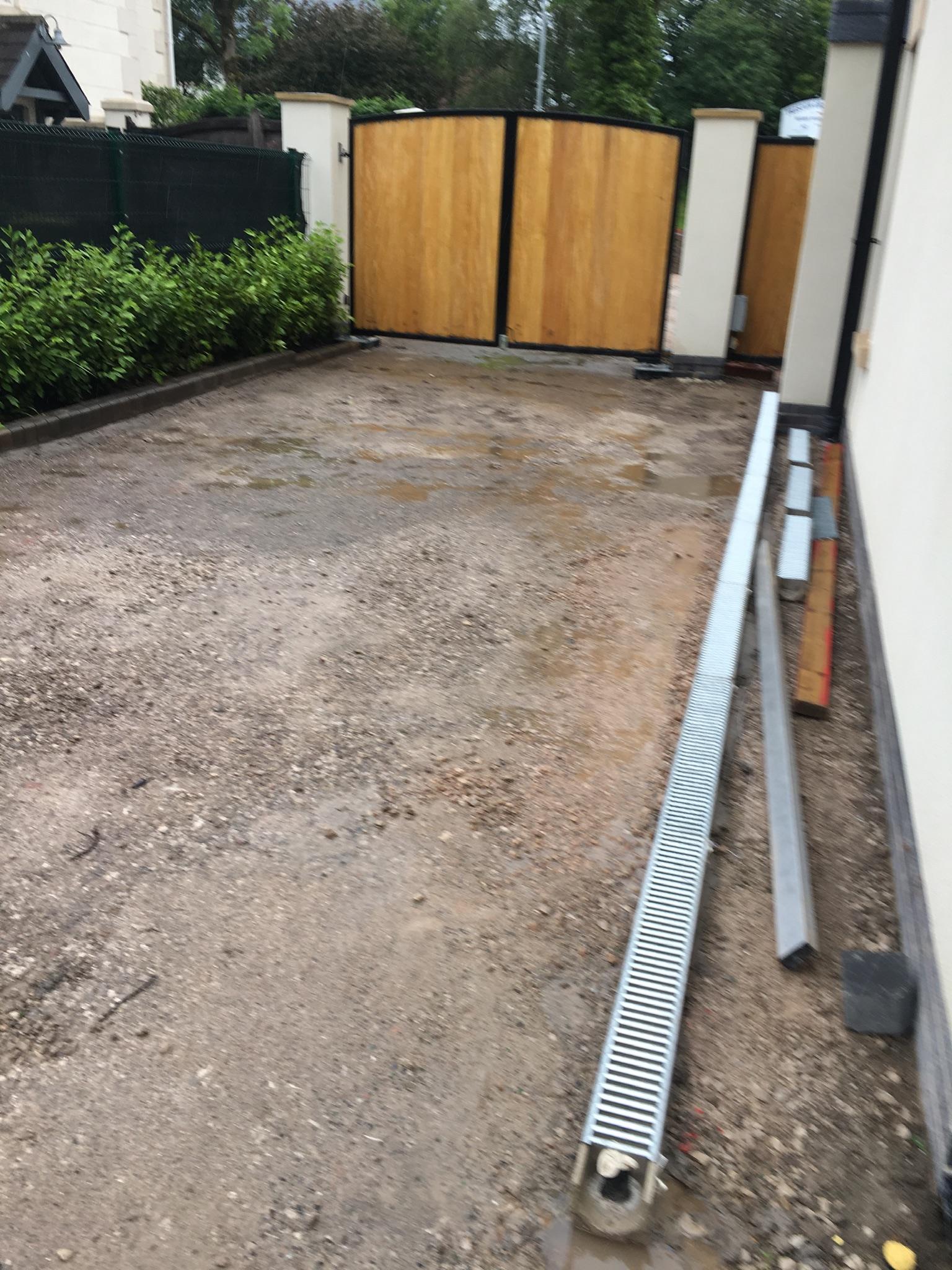

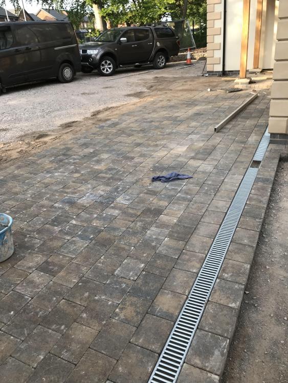

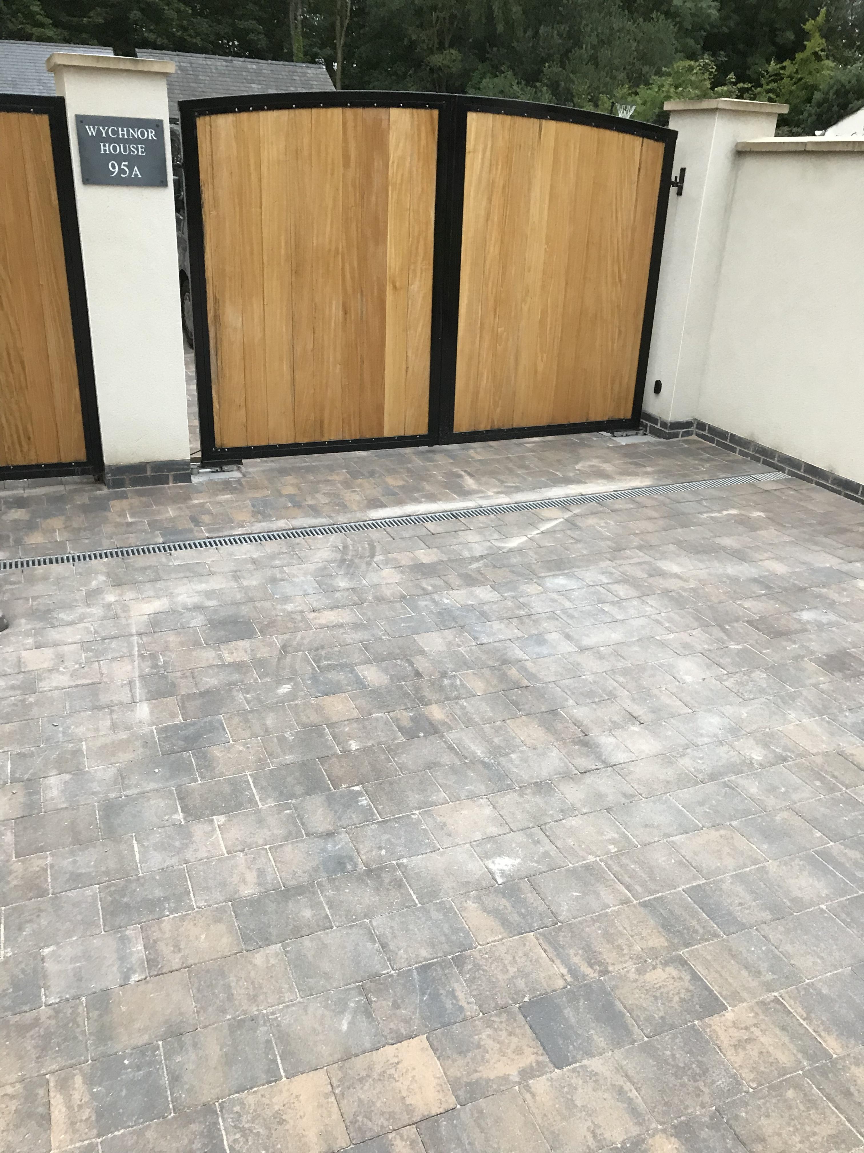

nod Posted January 27, 2020 Share Posted January 27, 2020 I used Acor the resin type around a fiver per mtr St them in concrete five mill bellow your paving and forget about them 1 Link to comment Share on other sites More sharing options...
