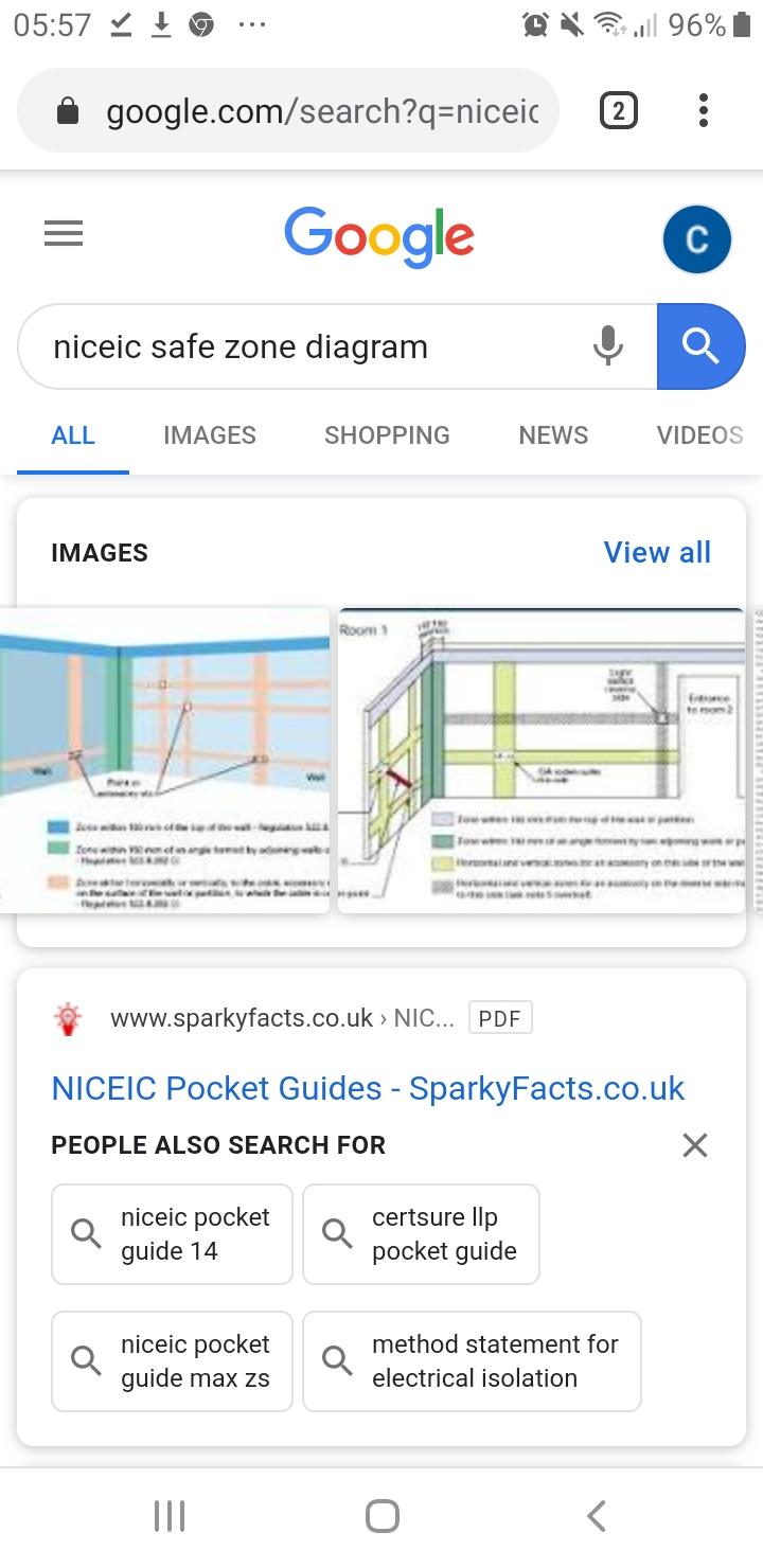

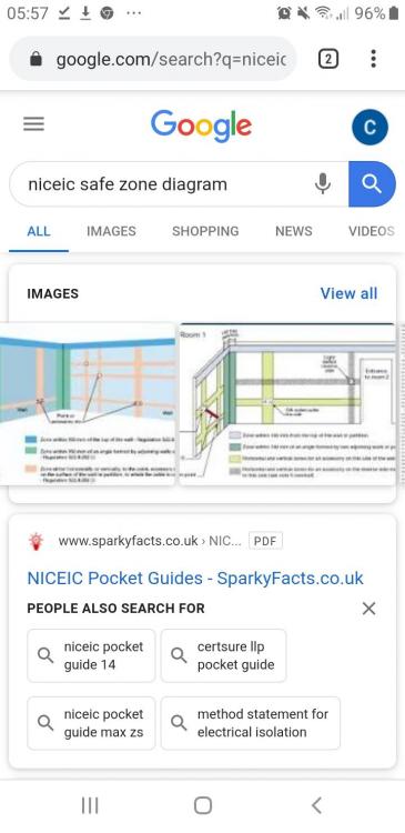

Google "NICEIC safe zone diagram" look for the diagram top right. Keep switches, sockets, in the "zones".
Lots of info too on that sparkyfacts link.
