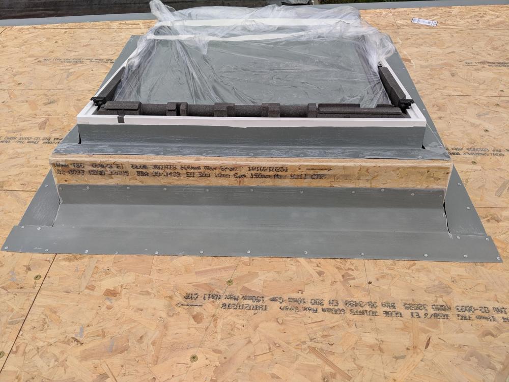

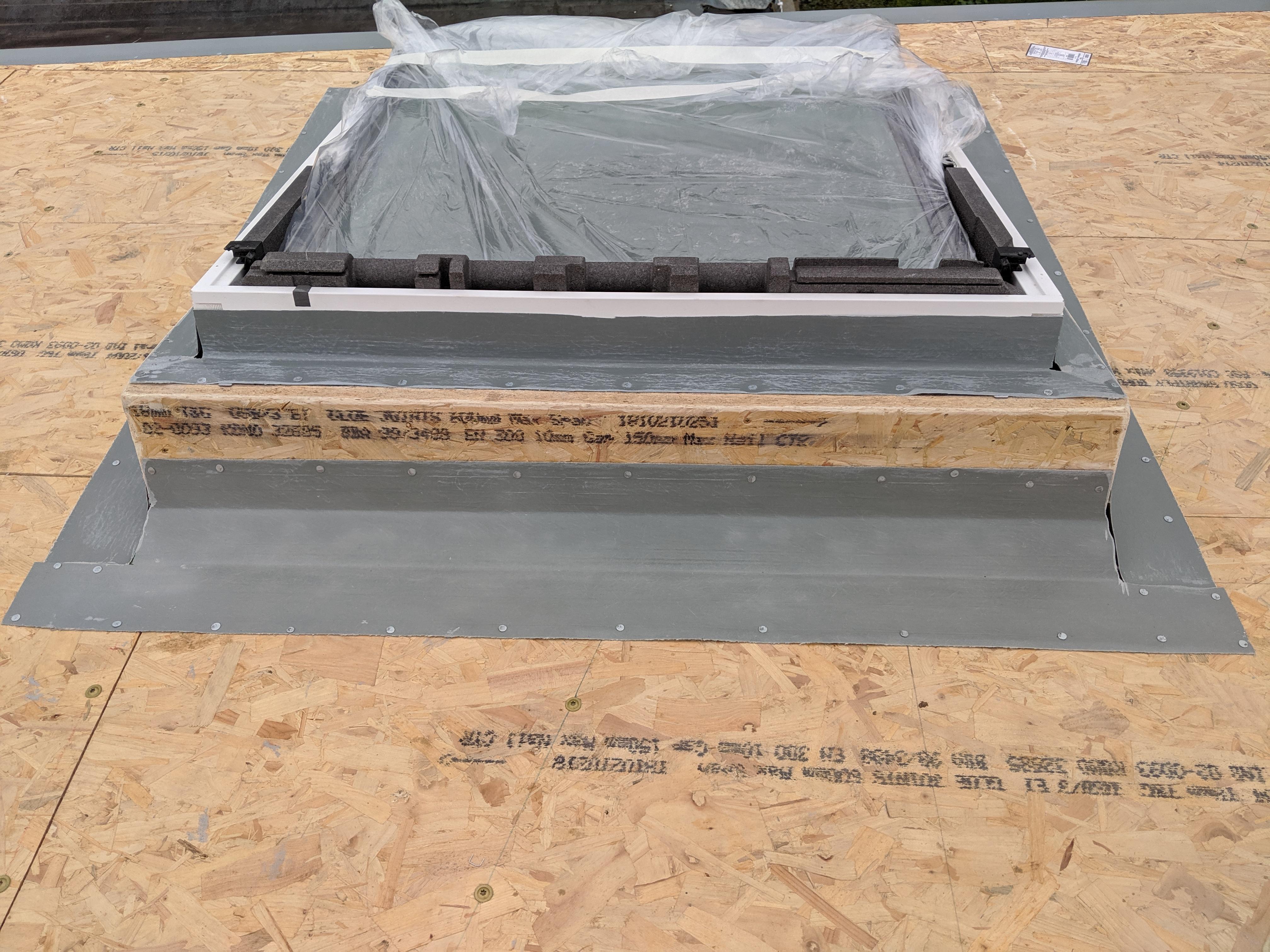

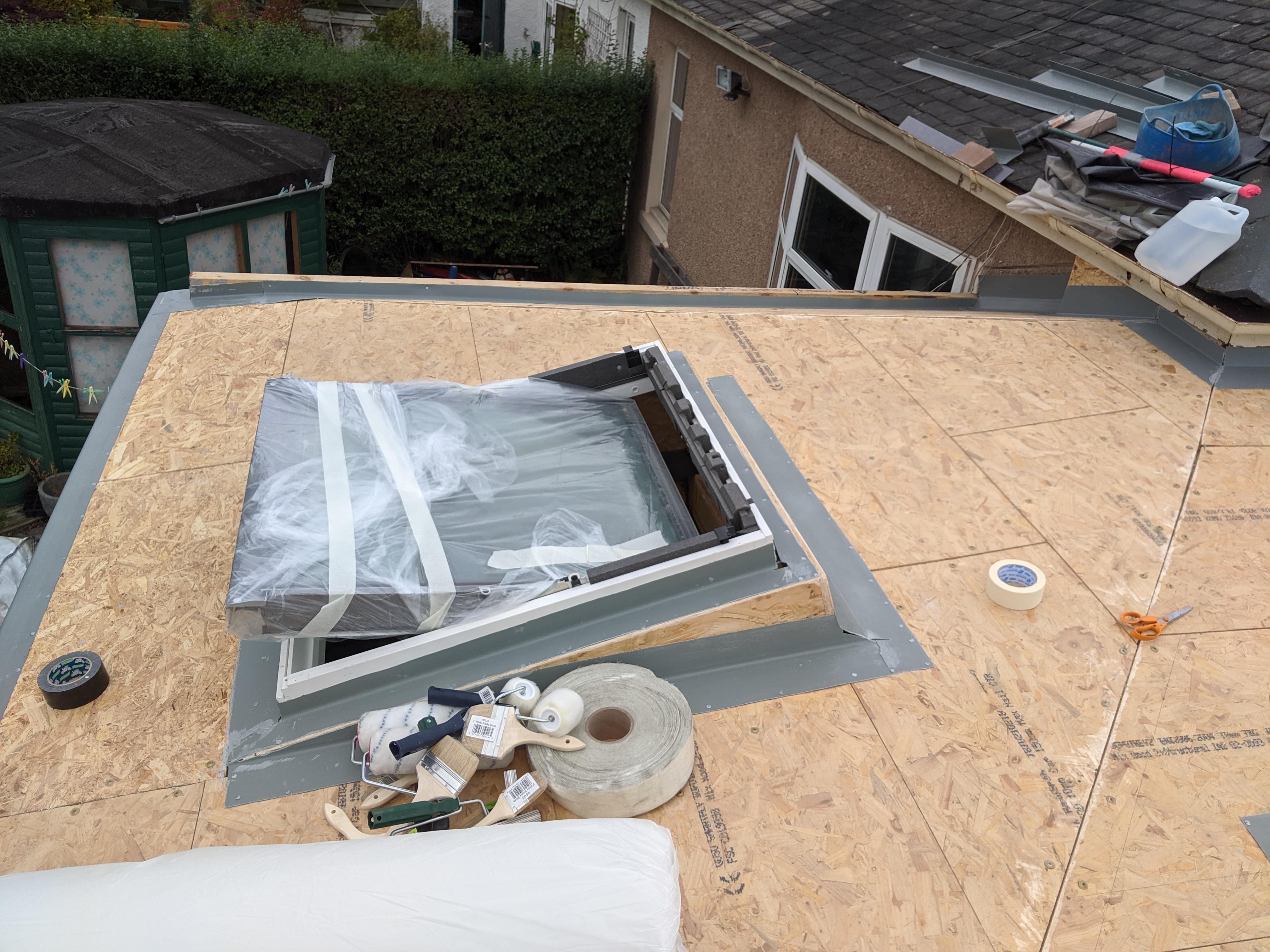

@SteamyTea thanks. These show one of the kerbs and you can see the small sloped triangle / parapet in the background of the second one. Haven't got any post-bandaging yet as it was dark by the time I finished doing it, so was going to take the next round after sanding / before laminating on Thursday before the rain came...
I did think the parapet had a very slight fall, and it basically does but there's a little bump up where it meets the bigger rear section (that the rooflight is in) so it's holding water there.
The kerbs aren't holding much, I think primarily the issue is the bandaging at the corners is again just creating enough of a bump that a thin line of water (like a cable / thick bead of sealant) gets held along the line where the trim bends up away from the deck. With this I'm as much wanting to avoid a line of dirt/algae etc as being worried about the water itself, since the roof is overlooked from the house.
So if I get this right, you want to make a "wedge" of PU foam to go around the window upstand, so that the water will always roll downhill, yes?
If that is the case, just get working with the saw, rasp and sandpaper on your celotex offcuts.
To hold it all in place, try sticking it down with gelcoat.
One think to remember is that matt does not like to wrap around an external corner, so a big radius is needed.  Much bigger than it looks like you already have.
Edited by SteamyTea

Thanks very much. Exactly that - I'll get cracking (when it's dry enough to take the tarps back off!).
And yes re the corners - those photos are before I took the sander to radius off the corners, got them broadly the same radius as on the drip trim. The bandage / squares of mat still took a little coaxing over but formed to the shape ok once they were thoroughly wetted out.
And obviously now there's a layer over them the main laminate will have a bigger radius again.
