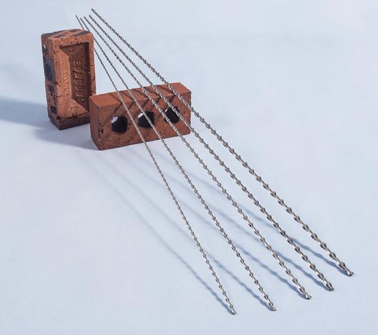

stevemac Posted September 20, 2019 Posted September 20, 2019 Hi there, I do not know if you are sorted yet, but this is the way we would do this for EH, national Trust. Just google Helifix. Its a twisted Stainless Steel band about 5-8mm wide and about 1mm thick in lengths of about 3-4 metres. Just cut to length. You drill holes in seperate stones, or same stones to form loops, say 300mm in length. each end is fastened with Polyester paste pushed into the holes.Also, Helifix can be left as just tails to be set into your mortar. Clean the holes out first by pushing some Helifix into the holes and then twisting and withdrawing to pull the dust out. Blowing down a thin tube can work to, or using a thin brush on wire used for pipe cleaning. When you put each end of the Helifix into the glued up holes, plunging it in and out a few times ensures everything will be bonding together. Helifix is available in various sections. You can buy the Polyester from Harbro supplies, county Durham, you need tins of Clear Vertical and you will be supplied with a catalyst with it. The glue actually looks like axle grease! ? Anyway, if your still stuck, let me know- Steve. 1
stevemac Posted September 20, 2019 Posted September 20, 2019 Using Helifix allows for flexing down the joint, but I would tooth the new stone into the original fabric to avoid an unsightly joint running down. Best wishes- Steve. 1
