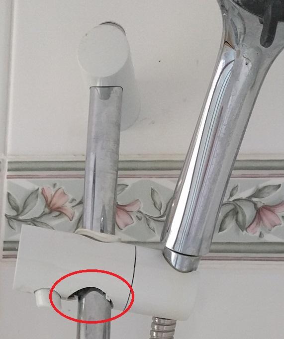

mike2016 Posted August 4, 2019 Posted August 4, 2019 (edited) Hi, This hasn't happened before - I was wondering if it's easily fixed or do you normally have to replace the whole arm that holds the shower head? The wear and tear of taking the shower head off the holder has broken the plastic inside the holder that allows adjustment up and down to different heights. It predates my moving in so I've no idea where it was purchased from originally. Thanks Edited August 4, 2019 by mike2016
Onoff Posted August 4, 2019 Posted August 4, 2019 (edited) Something like this, if you can be certain of the rail diameter search for that. https://www.amazon.co.uk/Vankii-18-25MM-Adjustable-Replacement-Bracket/dp/B07NR8KPSH/ref=asc_df_B07NR8KPSH/? Edited August 4, 2019 by Onoff 2
mike2016 Posted August 4, 2019 Author Posted August 4, 2019 Oh - that's the business! I'll have to figure out how to remove the old one as it's fully wrapped around but that's doable. Thanks!!
Jeremy Harris Posted August 4, 2019 Posted August 4, 2019 42 minutes ago, mike2016 said: Oh - that's the business! I'll have to figure out how to remove the old one as it's fully wrapped around but that's doable. Thanks!! They slide off one end of the chrome tube, so one of the wall-mounted brackets usually needs to be removed to allow the end of the tube to be freed.
mike2016 Posted August 4, 2019 Author Posted August 4, 2019 Thanks! That sounds easier than using a plasma torch....!
