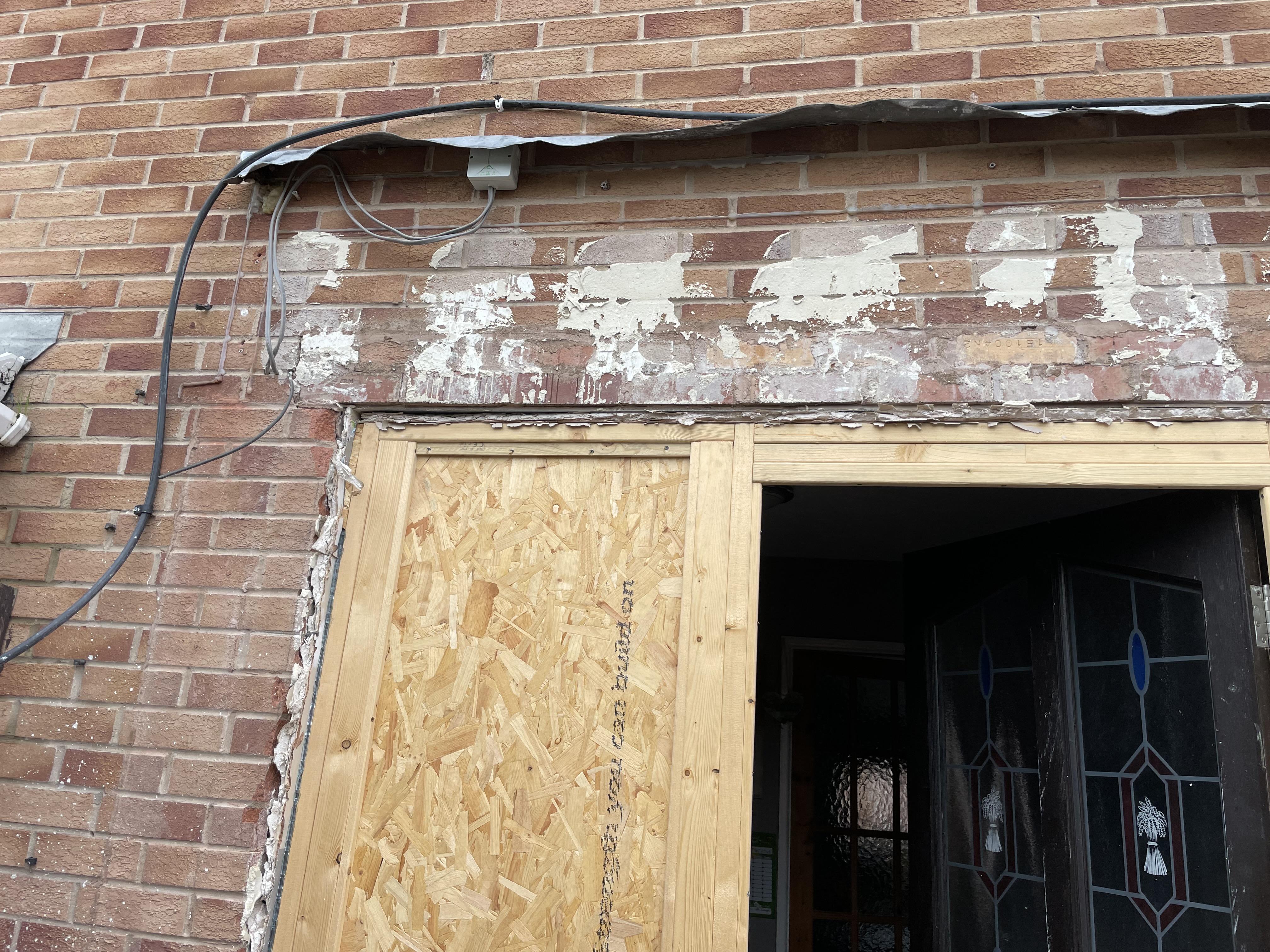

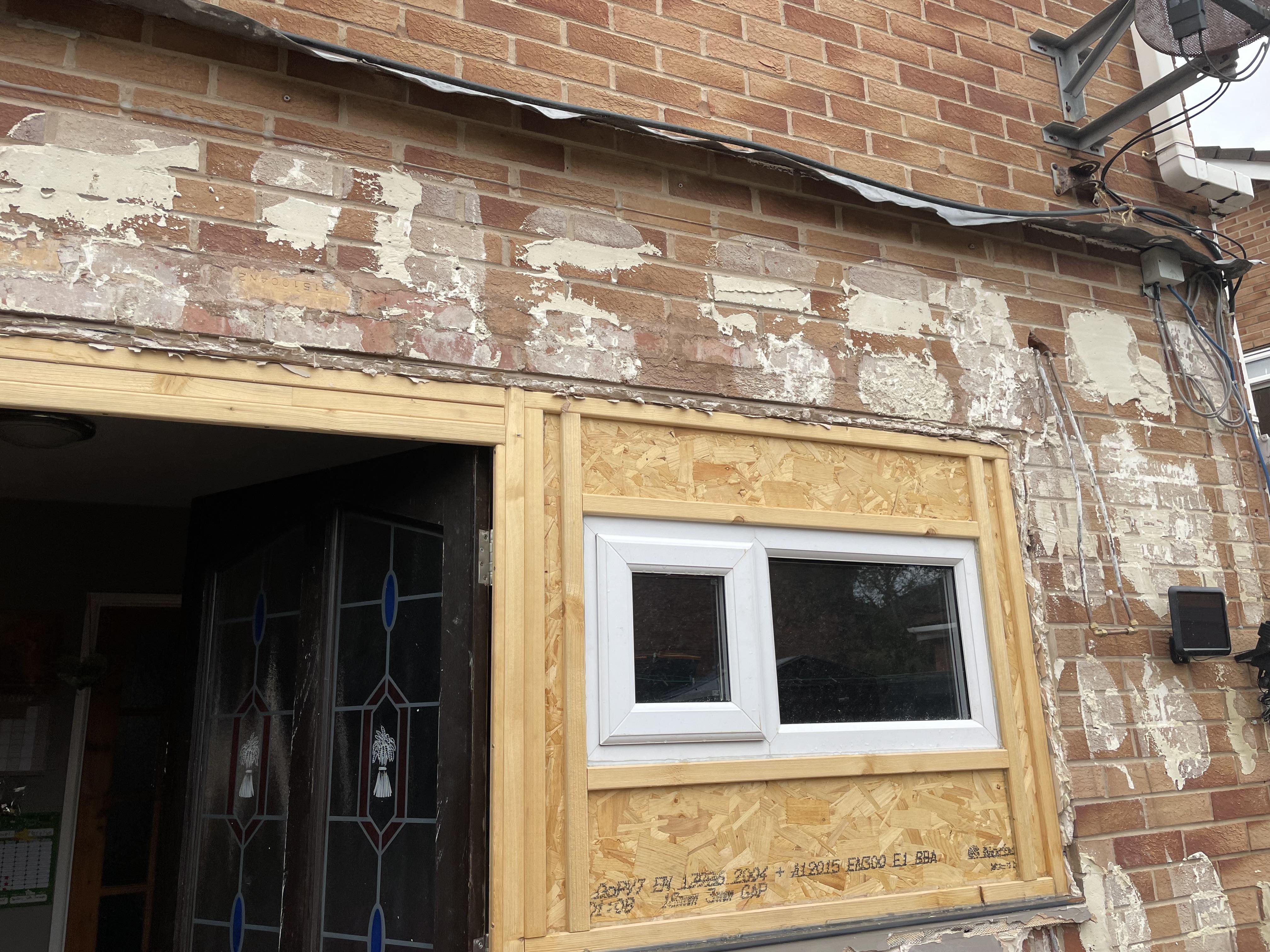

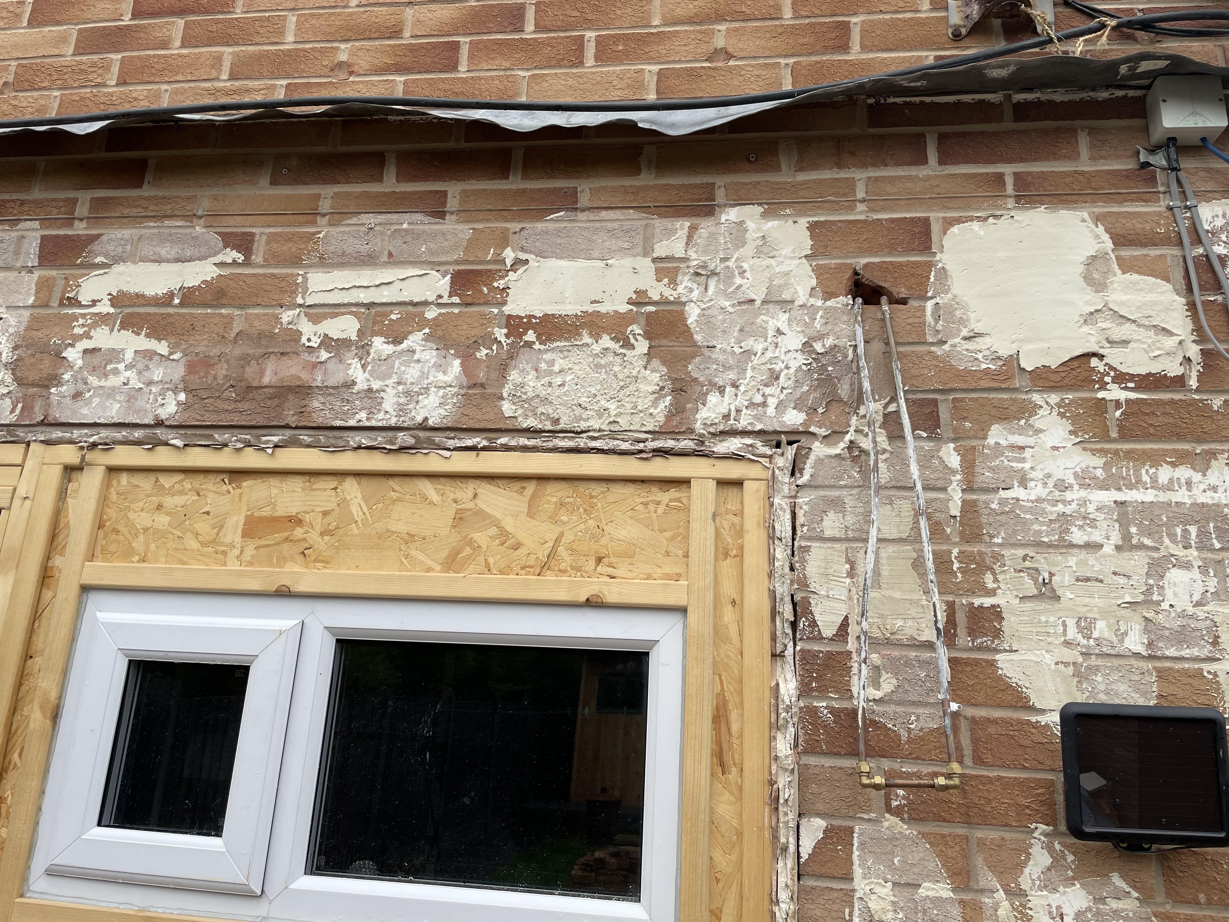

How to expose existing lintels for inspection?
Paul Alan replied to Paul Alan's topic in House Extensions & Conservatories
Thanks, will I need to remove all the bricks across the full span? -
Hi I've been requested by the building control officer to expose a lintel that was installed at the back of our property some years ago when a conservatory was built. He wants it inspected by a structural engineer to verify its adequacy. We are not in the position to employ a builder, how would I go about doing this please?
