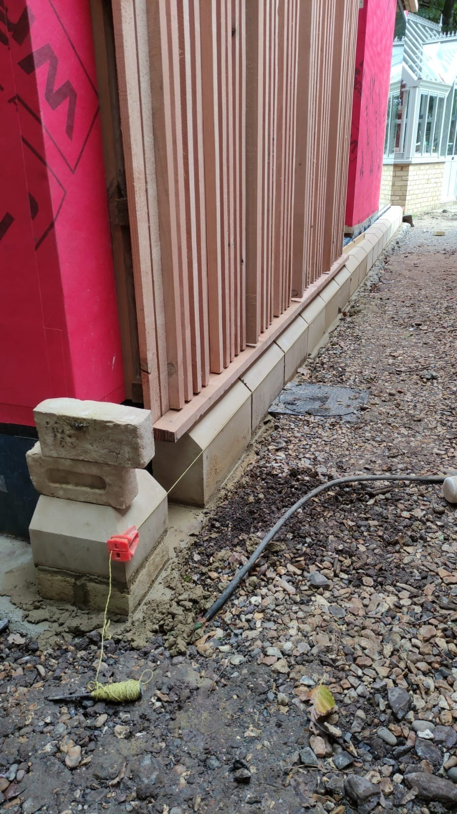

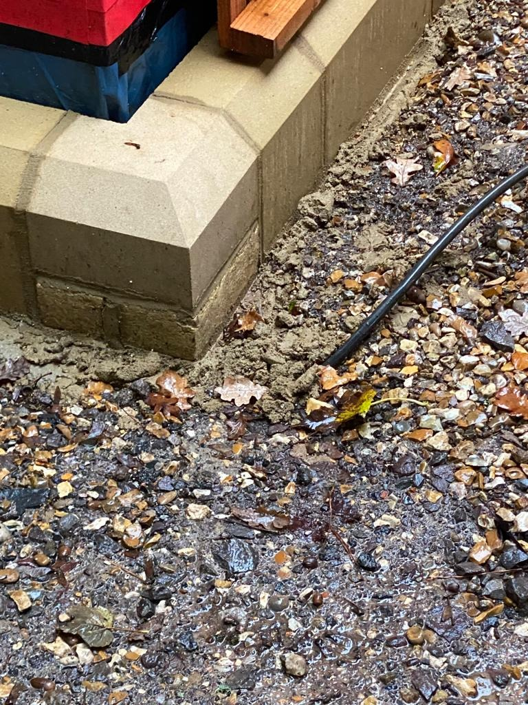

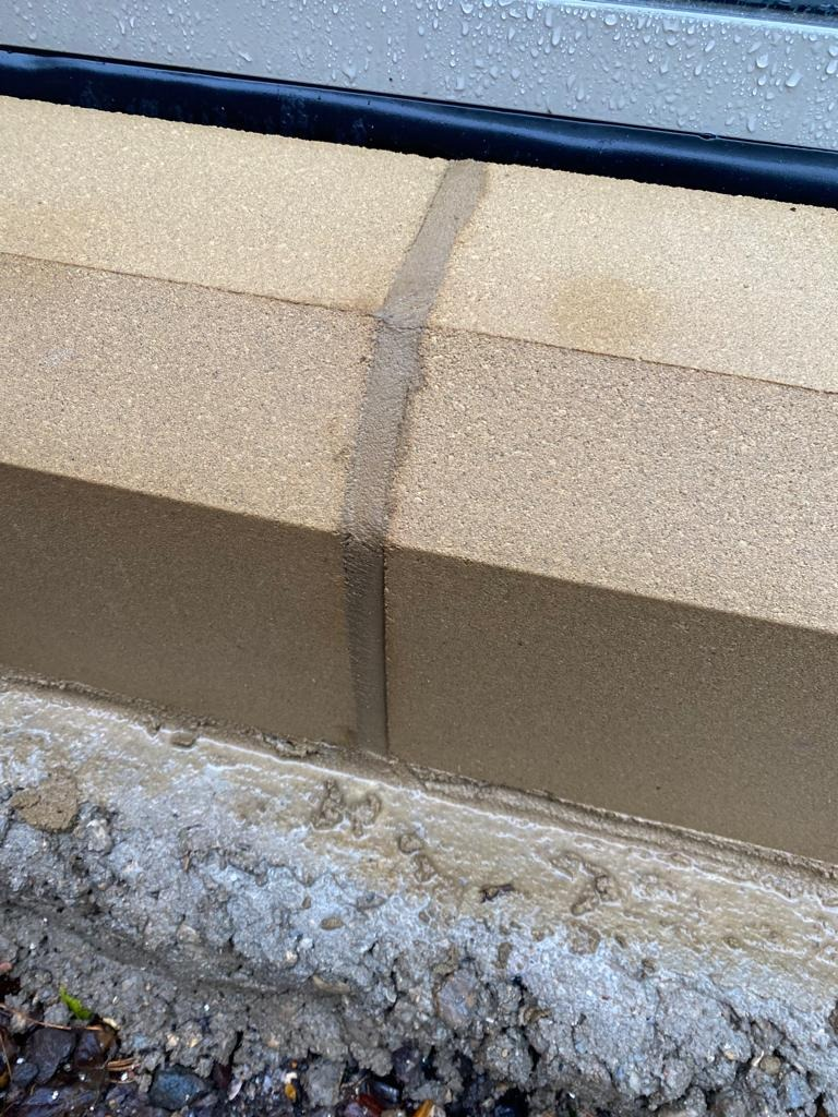

Hello, We've had some very special cast stone plinth blocks installed in a sandy 'bath' colour. Our groundworker - a bricklayer by trade - has installed them with a 10mm joint using yellow mortar (despite us having a convo on site re the joints being as thin as possible, ie 3mm and in a colour-matched mortar). Given that we wanted to achieve something that looks seamless, I think it looks awful! - see photos at bottom. I'm going to ask him to repoint with a colour-matched mortar - sadly it'll be too late to achieve a thinner joint now. Has anyone worked with cast stone blocks who could offer some advice about how to point them neatly and what a good mortar to use is? Thanks!

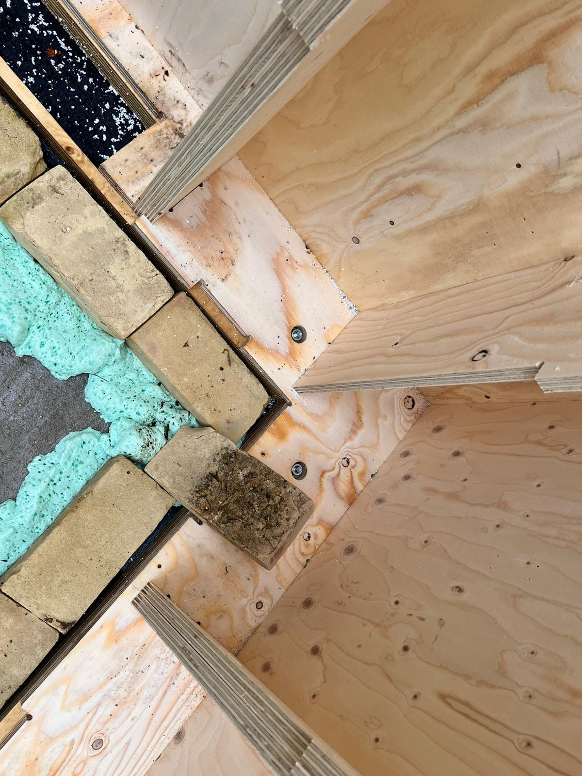

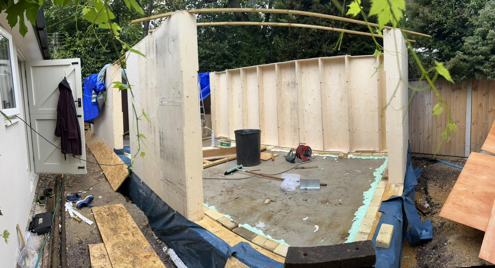

Hello All, I'm on site piloting a WISA Spruce cnc-enabled construction kit-of-parts. Its the first time I've tested the parts, but also my first time building and on a construction site! It poured yesterday and we had an emergency that I hadn't anticipated and so had no plan for. We had raised and levelled our sole plate, but not grouted or filled the gap beneath. (We have an insulated 'warm' raft slab, so the insulation is coming up the slab edge with a DPM outside it with a large overlap ready to be stapled, taped and lapped with the breather membrane when ready). We knew the rain was coming so were able to prep a bit. I took the DPM over the sole plate so rain couldn't wet the insulation board. But, what happened was that the rain fell, puddled on the slab and in places began to pour toward the edge, under the gap beneath the sole plate and probably straight into the insulation board where it'll be trapped - compromising it's performance. In the torrential rain, the quickest solution I could think of was to grab some bricks and squirt expanding foam insulation to form a makeshift gasket as a damm! It worked this time. But, its not a proper solution. Has anyone else encountered a similar issue and found a good solution? Thanks!

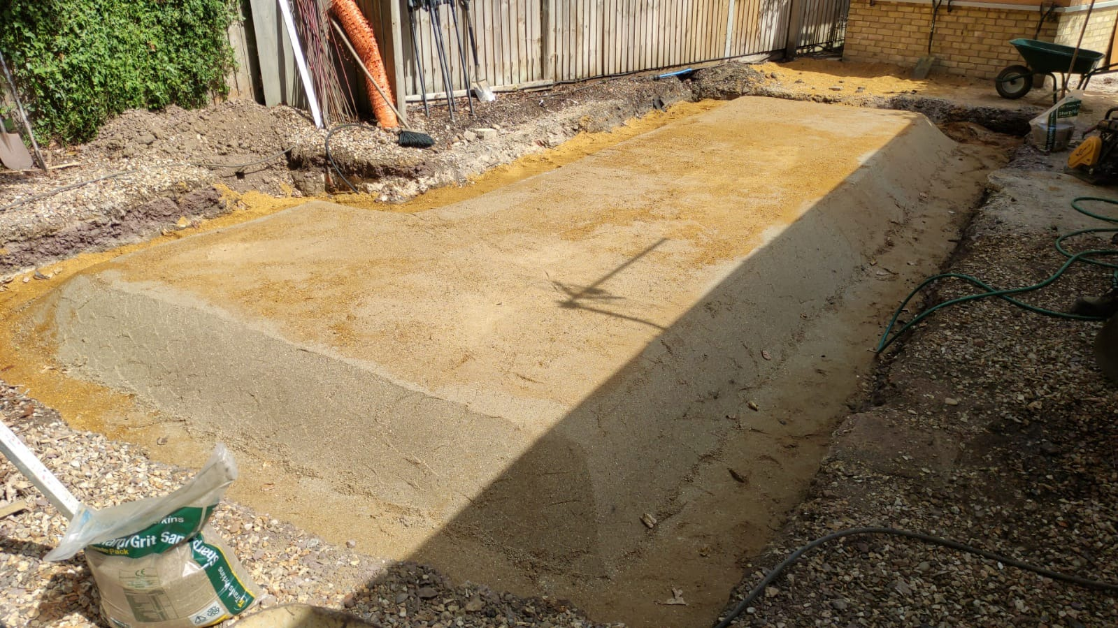

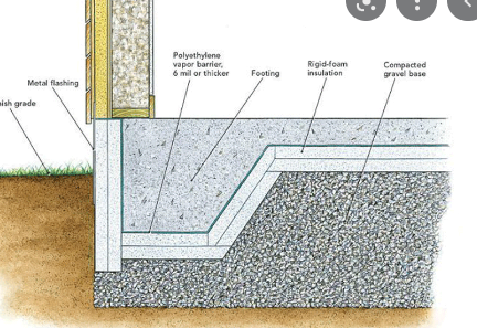

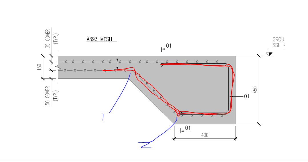

Hello all, We are building an insulated warm raft slab for a timber framed building. My groundworker is very good, dedicated, hard working etc. But, he has never built a raft foundation like this (image found on google and indicative only) : Here's a site image of the prepared ground before the shuttering, DPM, insulation, mesh and concrete go in. He's suggesting its much easier to do this without the 45degree slope on the inside and instead just have a right angle there even if he has to shutter both sides of the trench. He says, he wouldn't have to bend any mech or rebar. He's also worried about having to cut the insulation at various angles and doesn't really have a plan yet for how he cuts the insulation at the corner - which will have to be mitred in two planes! - the 45 degree sectional slope and the 90 degree turn in plan. I have two questions for the Guru's: 1. Can anyone with direct experience of building this type of foundation offer any tips on how to install the insulation with all the awkward cuts etc ? 2. This seems to be a pretty standard way of doing a raft slab. Yet, my groundworker is having real difficulty with it. What do others with experience think of this method, should it be this tricky? Thanks for any comments!

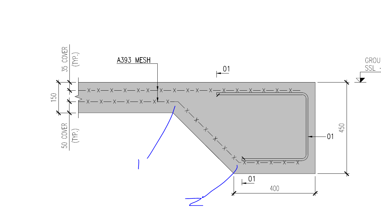

I'm thinking, why on earth were the rebar U-bars we had pre-fabbed off site not just this shape so no mesh-bending was necessary! I'll relate the folk bending method to my groundworker, but I'm not sure he'll know what I'm talking about!
I'm an architect and (though I've never overseen a foundation being built on site) I know that this is a standard raft slab detail. It must be buildable. I imagine there's some kit needed or my SE failed to mention that you'll need to have the mesh bent off site
Hello, So, I have a groundworker that hasn't fully engaged with the engineer's foundation design before taking on the job! Our foundation is a raft slab with an edge thickening. Following my SE's advice, I've had a bunch of U bars pre-fab'd off site. I think the rebar cage designers expected him to have the means to bend some mesh on site, but he doesn't know how to do it. Does anyone know how to bend a sheet of A393 mesh in two places - see pic below. Any help would be amazingly appreciated!
