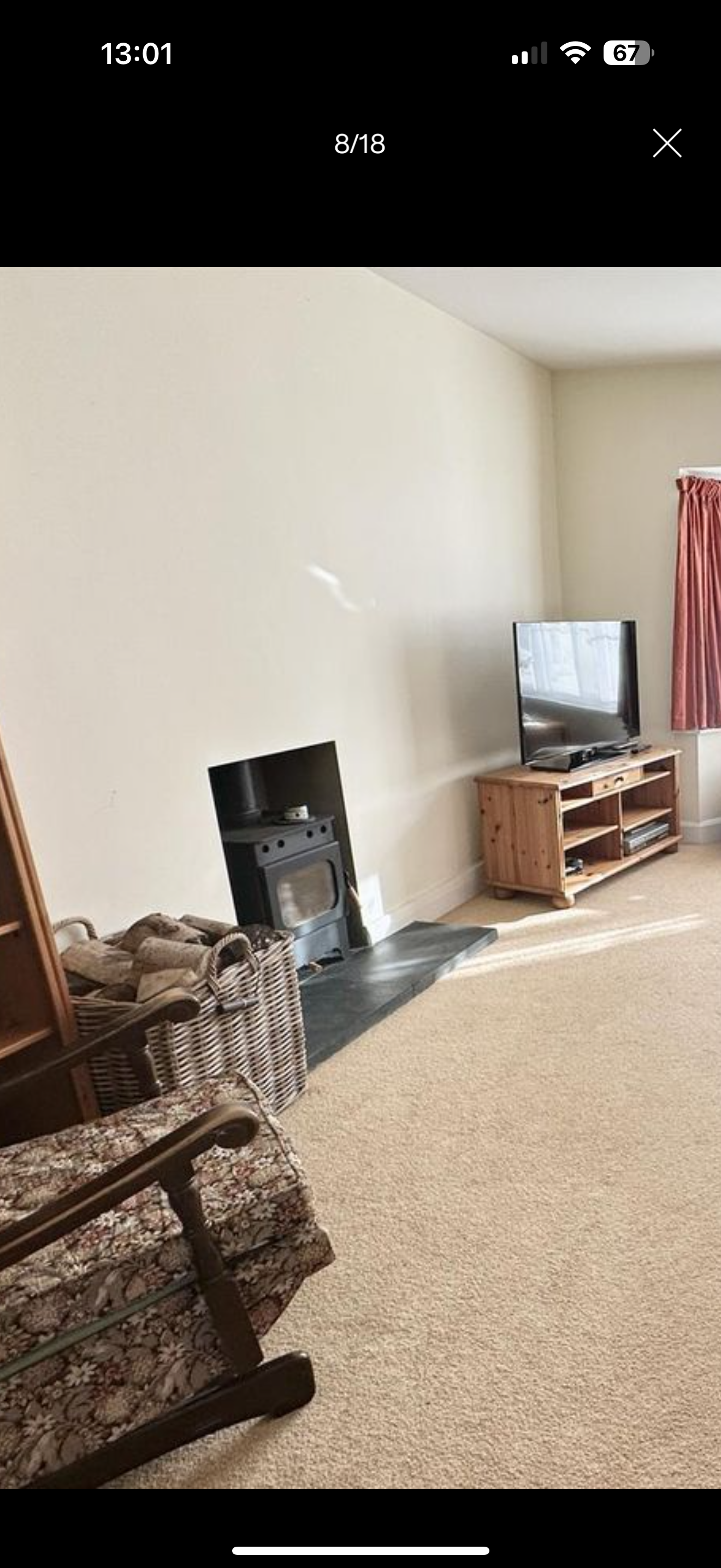

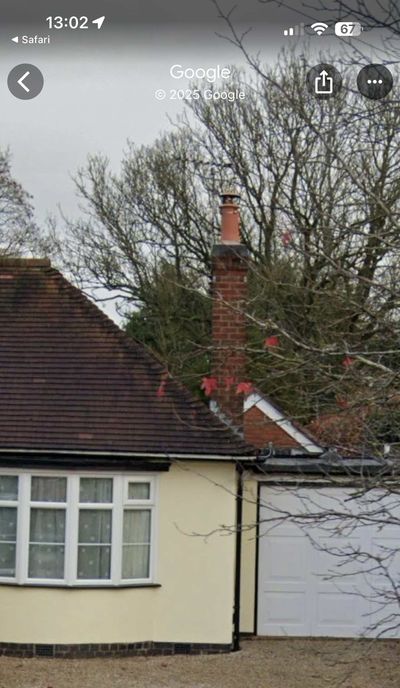

Hi there. I am after a little advice as confused on differing opinions on the full removal of our chimney and what may be best. We have lived here for a year now so getting through projects. The chimney and opening in the lounge is on the external wall of the house but within the side garage attached. Our chimney and opening has a small wood stove and chimney pipe leading to the roof that produces so little heat and causes some terrible drafts. The chimney itself is in poor condition and needs serious work picked up in the survey, and as we don’t want to use the stove we want to do the following. knock down the chimney to below the roof line above the floor to reinstate the natural roofline and tiles and Brick up the opening in the lounge. This leaves the small cavity and breast left from the living room to within the loft area. Due to drafts I went to permanently close it off without air bricks etc but unclear what to do with what’s left. Could I insulate it from the top down to the bottom and then cap with boarding in the loft the bit left to the lounge? if I was keeping the top would have just added air bricks but as it is in such a poor state someone would have to get up there and rebuild the top anyway so may as well remove it. any help or advice would be great. have attached a photo from the marketing when we bought and a google street view of the chimney. Russell.
