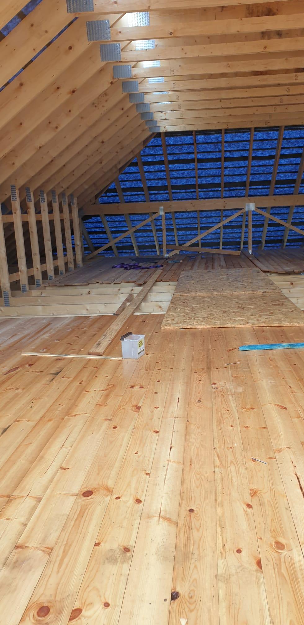

  22. Rafters are 222mm deep.

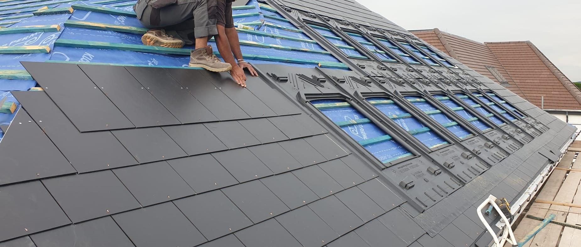

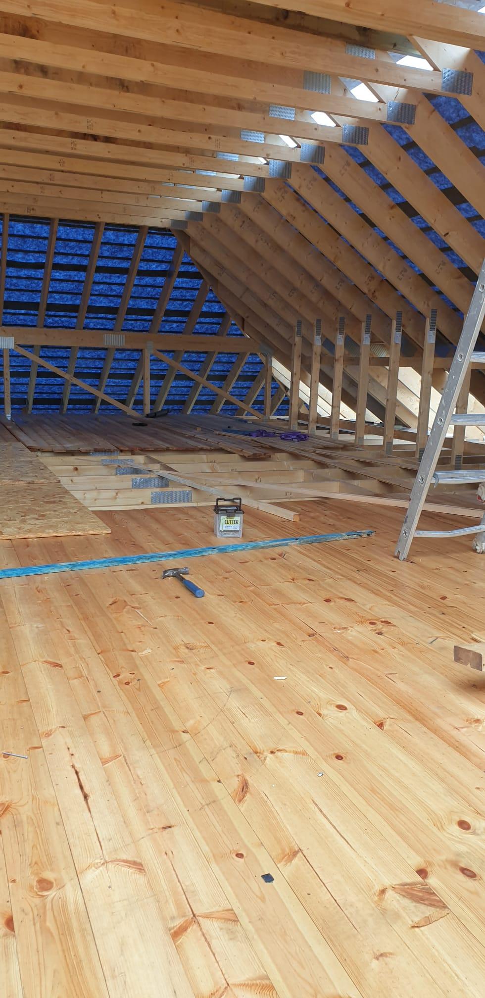

  23. We have now completed the roof and are looking for the best ways to insulate the roof to meet building regs. Roof is approxitmatly 250 Sqm and we have stairs going up to the loft and will be using it for storage and maybe a Cinema Room at some point in the future. I have attahed some pictures and a video before the roof was tiled and completed. I also have 31 Solar panels inset on the roof onto the South, East and West side. Looking for the most cost effective way of doing this. Thanks for your help in Advance 1807495119_WhatsAppVideo2022-11-15at12_11_59.mp4
  24. Great ive got the Leicester Contact for Lindab and have emailed them my reqyuirements. Thanks for your help on this.
