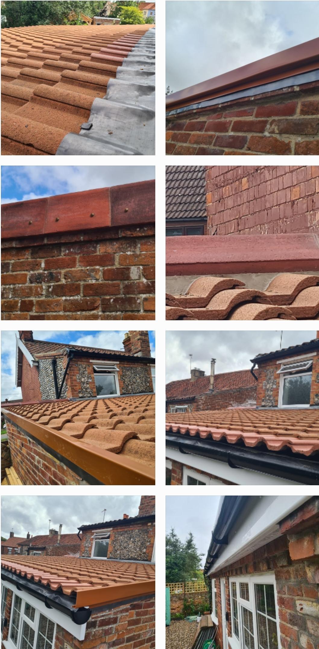

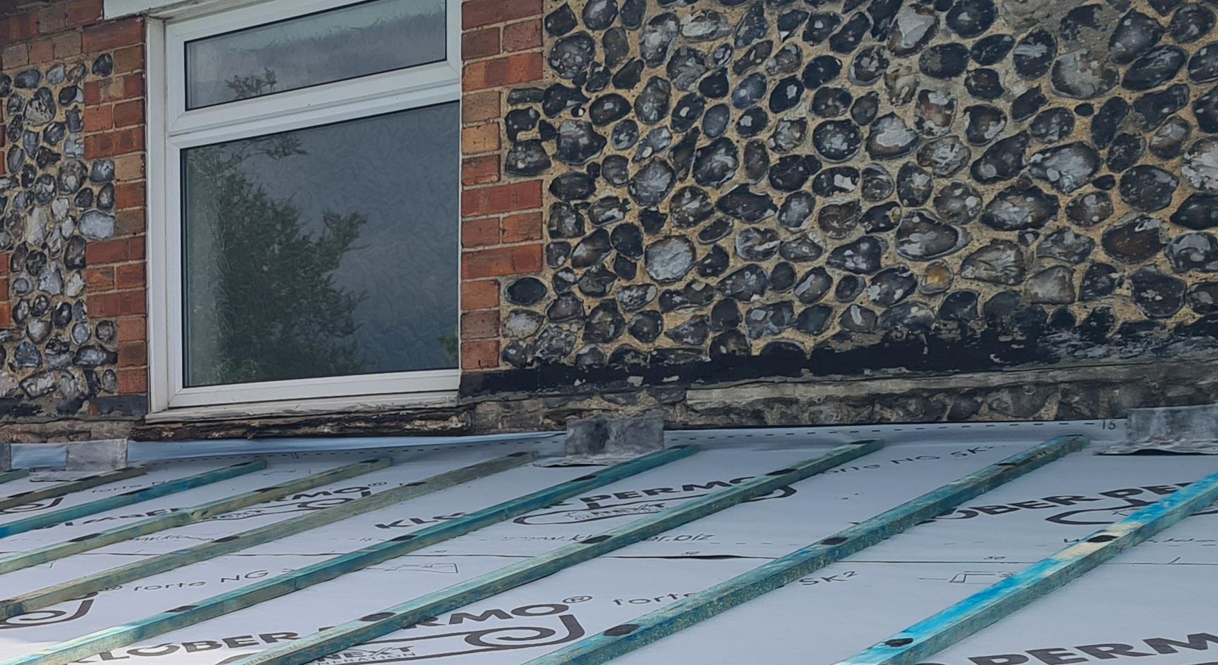

  2. An update of my first attempt at roofing. Before and after piccies attached. Was much more work than expected but, have managed it. Had some serious rain storms recently and all is running well. Decided to go with the original lead line and managed to get ~75mm upstand and in most places 20mm into the flintwork. Couldn't secure with Hall clips (found another use for these though- spotted?) but rolled lead did the job. Sealed in the mortar line and added a 50mm lead sealant line over the top for security then sealed my flint work with water repellant. I secured any areas where the mortar line was shallow with lead straps secured with the tile screw. I don't think I'll ever make a roofer but, for first attempt I'm reasonably happy with my lead work. I'm sure the pros will disagree but, hey its done now. I'll keep a close eye on this over the next few years and if it deteriates I'll drag the flint work out and lay some bricks. Out of all house repair, brickwork is one I don't like. I'm just hopeless at it and it takes me all day to lay 20 bricks. ? Must cap the ends of the dry verge! On with the inside now. Vapour control done - just to board and skim. First pics are a 'before' collection - 6 days to clear that lot and it was minging. Black mould, everything absolutely soaked. Stank like rotting food.

      • Like

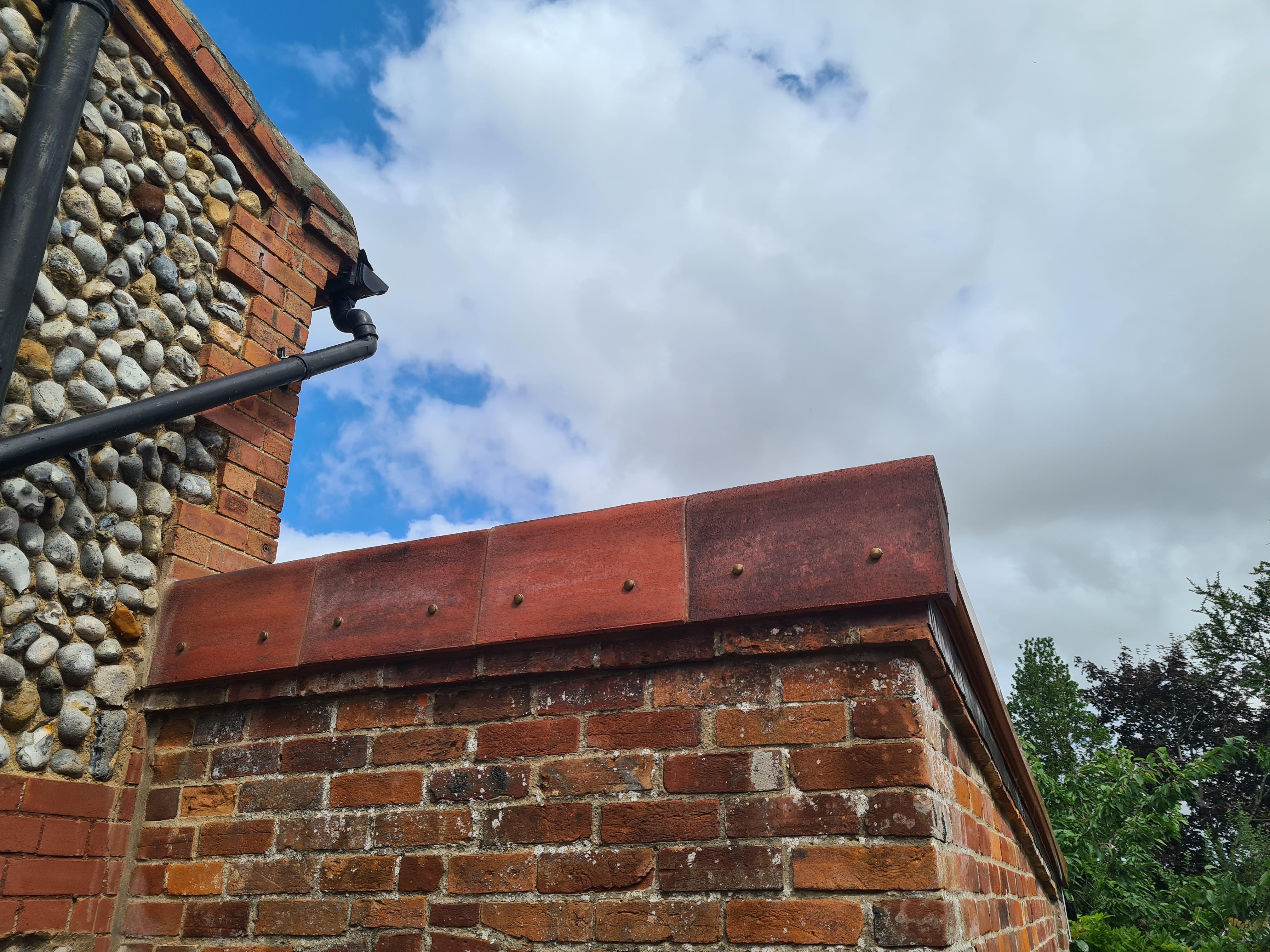

  3. After a bit of deliberation I was lucky and the company that supplied some lesd work managed to get some ridge tiles made to order for me. Were very reasonable cost wise too. Happy with the result. Bonded on the inside of each ridge tile and on the joining faces and then finished with some sharp sand mortar on the tile side.

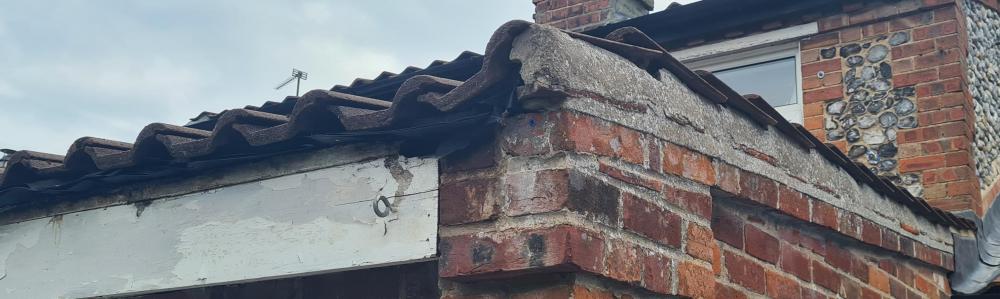

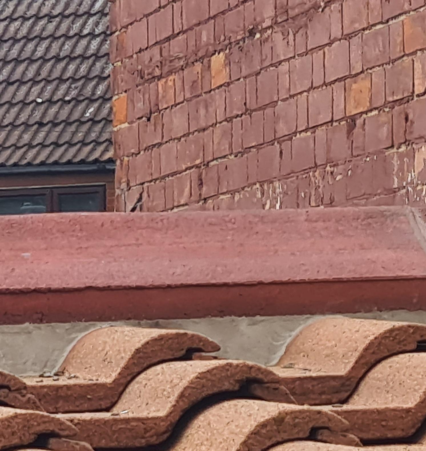

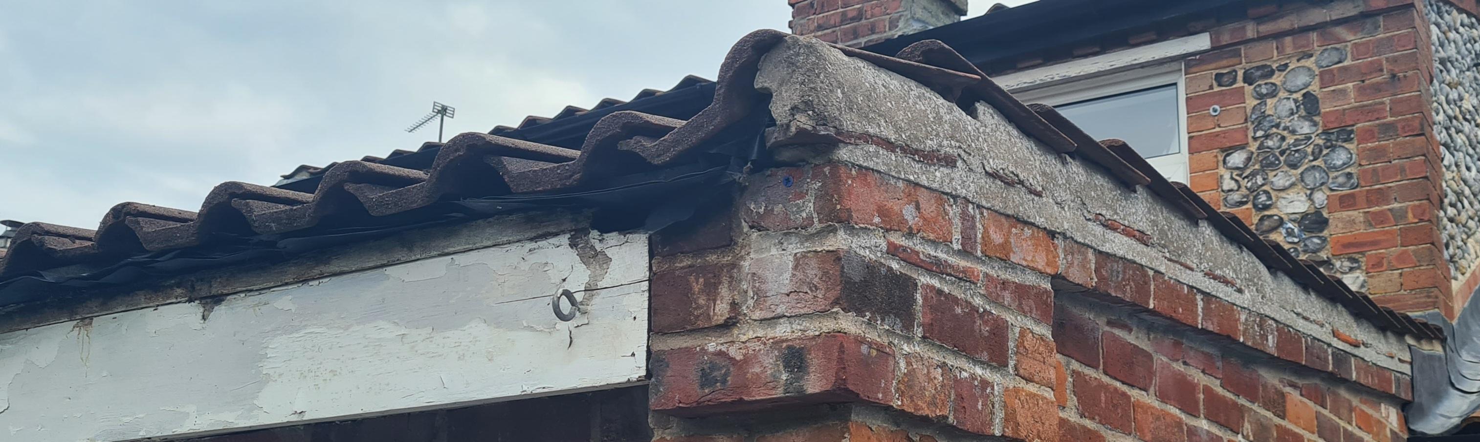

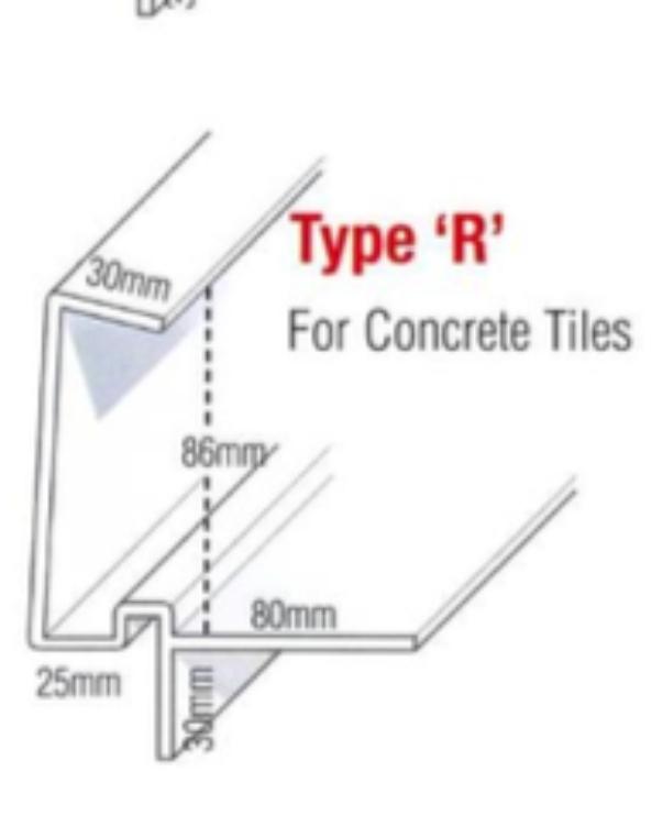

  7. There are currently no mono ridge tiles available in the country it seems. I have a section of mono ridge that I am considering alternatives for. In the first picture you'll see it was finished with standard half round ridge. I have these ready but wasn't happy with I as it just looked odd. Ignore the red lines and the state of it, it's an old picture from a week or so ago. I've taken 2 course of bricks down and have now extended the batten and tiled area up and over this so it now takes full tiles to the wall line. Previously they were badly cut half tiles slobbered in mortar. This means that I will have a vertical line now which was to be capped with mono ridge tiles. I may change back to those when I can get some. I am finishing the verges in a continuous dry verge that looks surprisingly good for powder coated steel. It would fit quite nicely on top of the wall but, I have concerns over the wind driving water up the tiles and under. Tiles are fitted with ridge - forticrete centurion. What do you think to using the dry verge on the mono ridge and finishing the external corner with Lead? Did consider Lead and using a reverse type mortar joint on the wall side. Any other suggestions welcomed. ?

  10. The kitchen in my property is an 80's addition. I'm looking for options with regards the lead flashing and flint work. Really keen to stick with a tile aesthetic externally. The previous lead chase was set very low to avoid the flint I assume. I have little choice but to go under the current window line. The sills are coming out next job. Probably just going to brick these up. What are your thougts/ideas on the best way to complete my flashing? Stick with the original line? Use render bead over the flint to seat the lead flashing to increase vertical lead height? Other ideas/recommendations? On another extended area I removed a 2 brick area of flint work and relayed with period bricks to seat the lead inbetween but clearly the windows define my options. Final draped membrane and tile battens to go on yet plus centurion which brings it very close to the window line. Ty in advance. Pictures attached.
