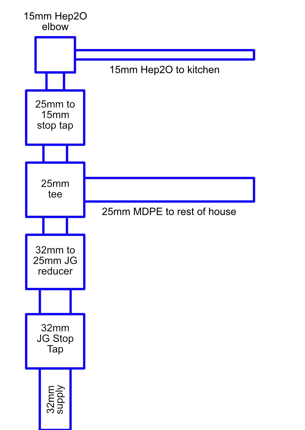

Thanks for the replies :-) Yes, in hindsight this would have been a much better idea. Unfortunately, floors are all down now so we have to deal with the MDPE as it is. I'd be happy to replace the stop tap – the JG one is 220mm!!! It's why I'm concerned about how I fit it all under the sink! This definitely simplifies things a lot, thank you. It also looks like I might need a drain tap directly after the stop tap but I've not been able to find a single 32mm drain tap! Is this the case?
Hi all, New build. We have 32mm MDPE coming up under the sink. From the sink, we need 15mm feeds (Hep2O) to the kitchen appliances and a connection to the 25mm MDPE pipe that goes to the rest of the house – water cylinder, heat pump, bathrooms, etc. I'm trying to simplify this but am struggling. It's a LOT to fit in an under-sink cabinet currently. I've attached a diagram of the simplest way I can think to do the pipework but I know it's not right. Can anyone much cleverer than I advise how to take a 32mm MDPE and terminate to 25mm MDPE and 15mm Hep2O?
