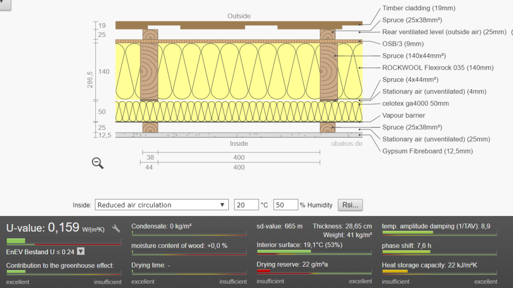

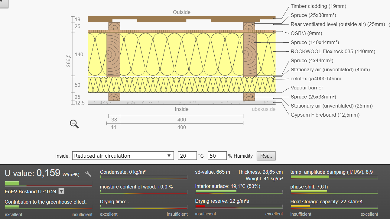

Feedback on timber extension structure

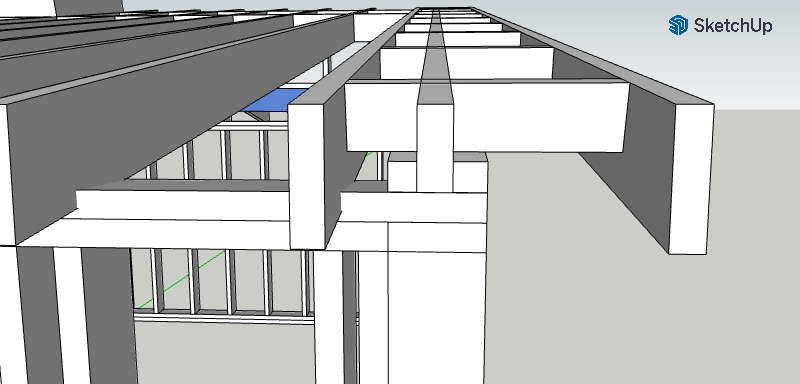

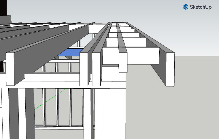

Good point. And actually I don't really need that extra joist by the side of the wall, so I can extend the flying rafters to the next joist. It's only a 68mm extra overhand on that side, but it also removes the (unnecessary) weight of the extra joist on that wall. -

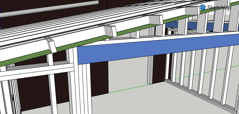

If I raise the height of the front wall by reducing the depth of the fully supported joist, I can have an uninterrupted top plate that spans the distance (highlighted in green). Still not perfect but potentially much more structurally sound. In this render I've hidden the front joist so you can see everything. And a side view to show the full depth joist next to the wall, and the shorter joist resting on top of the (higher) front wall. A little unconventional maybe, but could this have solved my problem of the lintel being too high? -

Not yet. I'm pre submission (just about to send it all off in next few weeks). It should be fine though. The required u value for an extension wall is 0.18 This build up gives me 0.159 if I've done my sums correctly. -
