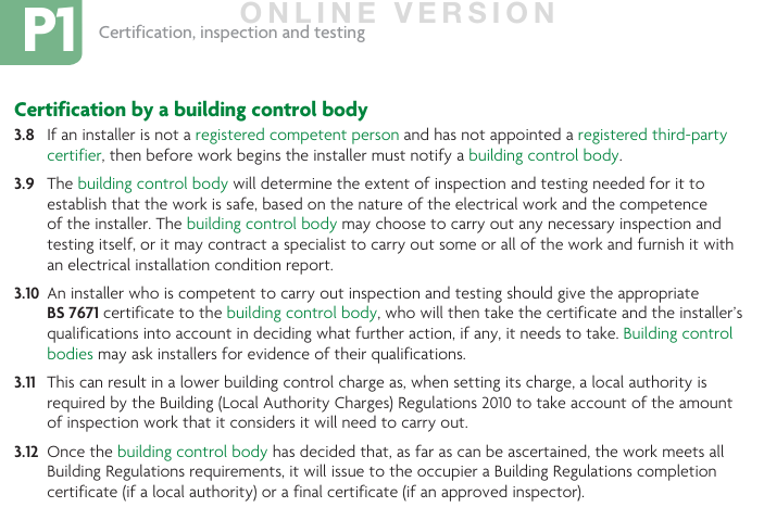

My understanding of the above is as follows... >Part P (Electrical) just means that you/your installer follows the regulation set out in this document: https://assets.publishing.service.gov.uk/media/5a802da7ed915d74e622ceed/BR_PDF_AD_P_2013.pdf >Part P certification can only be issued by either "registered competent person" or "registered third-party certifier" or "building control body" If you want to do the work yourself then it is notifiable to BC therefore...To get a BC certificate (which covers Part P) your install would need to meet Part P and any another other Parts requested by BC You do not need to be qualified or registered you just need to be "competent" and sign to say you are via a BS 7671 certificate (you can buy these and sign yourself) to BC https://www.expresselectrical.net/electrical-installation-certificate I have done this myself for other electrical work e.g. minor works and BC don't have a problem.

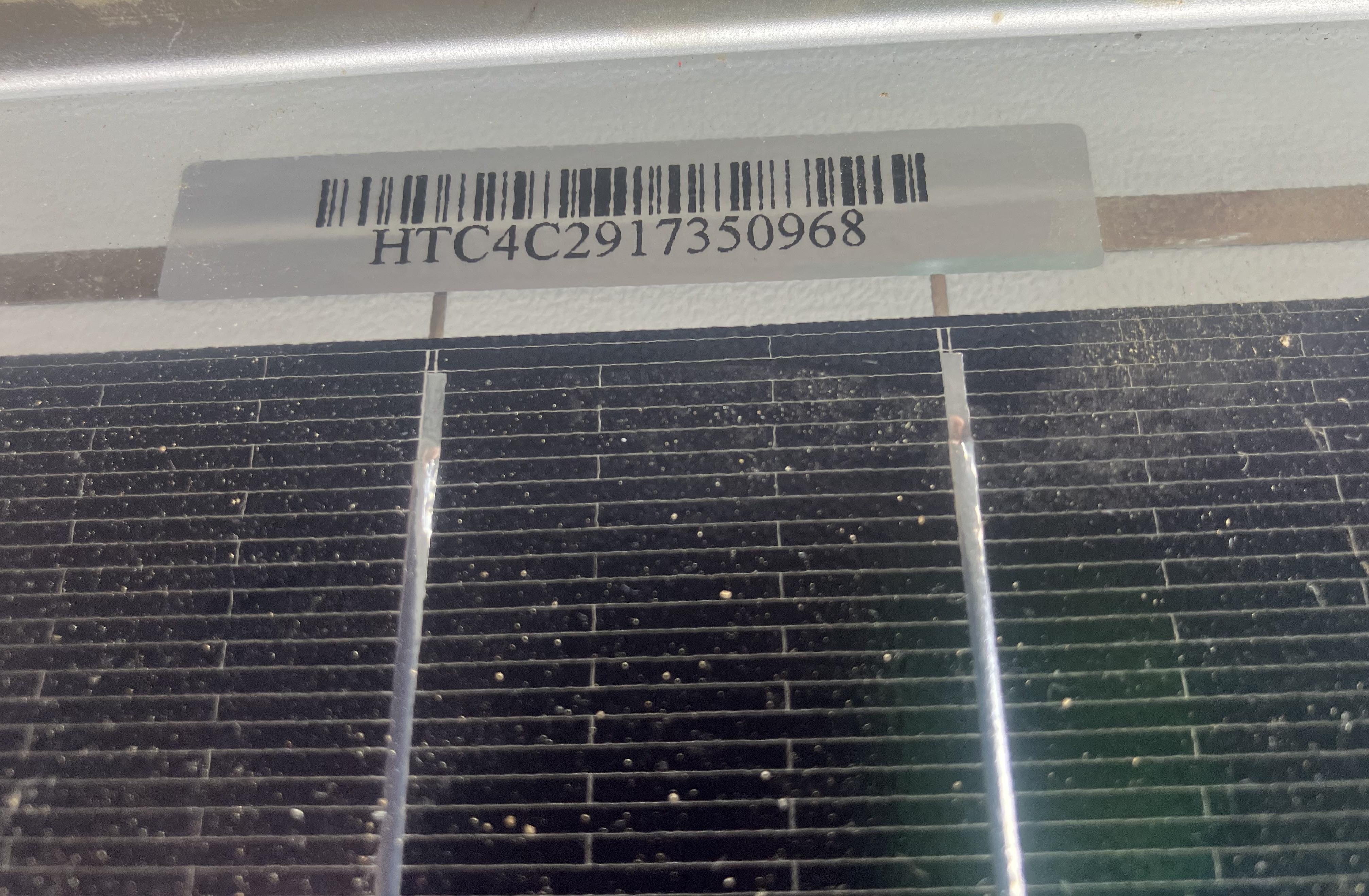

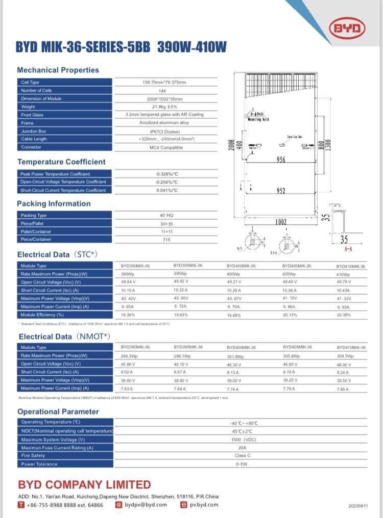

Thanks for sanity checking, I didn’t think about counting the cells. Looks like I’ve narrowed it down and based on what I’ve tested I believe they are the 410W versions. But either way I think I got enough info to plan the string and inverter I want to use with them.

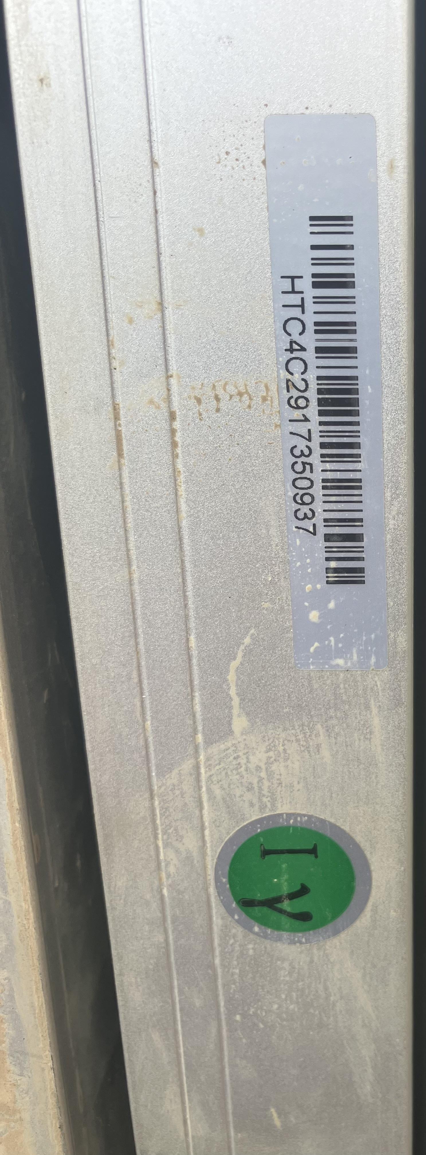

So I moved one of these panels to face the same direction as my existing array of 10 x 410W which currently reads 2.93kW from the Solax app / 10 so 293W each (underload) This unknown panel reads 46.7V & 9.23A but NOT underload so 431W I was told drop it by 25% to get the underload wattage so 323W. Since my existing setup of 293W is 1.4 times away from its maximum of 410W if I apply the same 1.4 multiplier to this panel that makes it 450W. (323 x 1.4) I know these are rough calculations but at least I’m in the ball park of the output it generates?
Arr that seems to make sense, I was told they were imported from Morocco. I think the stickers were intentionally removed. I did find evidence of a faded impression on one that seems to read BYD but they do a few variations it could be so i’ll do some electrical testing later
I got as far as this… but no datasheet yet https://www.htc-lb.com
Can anyone help identify my panels there are no markings other than numbers on the side and front? They are 1m x 2m and 40mm deep Spits out around 50V dc on a cloudy day.

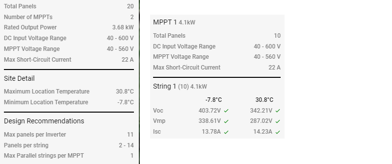

So my inverter details are on the left, min voltage is 40V My new expanded is 10 stringed array in series to creates the left Vmp (Optimal Operating Voltage) against worst case ambient temperature of 30.8C gives me 287V Current in series is approx. 10.5A Typical 4mm2 cable is 0.005ohmes per m so with a cable run of 40m (round trip of 80m) I make it a 3.57v drop if I upgrade to 6mm2 (0.003ohms/m) this reduces to 2.38v using this caculator: https://midsummerenergy.co.uk/voltage-drop-calculator What is an acceptable voltage drop? (I guess green text is good and orange text is border line) Appears to be 3% as previously suggested So again thanks all for the help 6mm2 seems to be the way forward as I'm likely less than 40m anyway probably more towards 30m
Thank you for your advice; on reflection and crunching some numbers I’m going to wire in the extra 10 panels to the unused second MPPT on my existing 3.68kW inverter (it can handle the over sizing) All i need to do is run two 4mm MC4 cables from the garage to the main dwelling approx 40m. The overlap area is not worth chasing for the extra cost and headache. Reckon I can do this for less than £500!!.

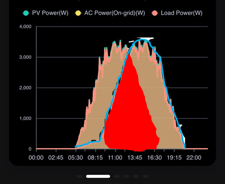

You make sound points. Just to double check your suggestion I expanded my new proposed array from 8 to 10 panels (as I can actually fit 10). Took a clearer day, and inverted the current SE profile to roughly represent the proposed SW roof; overlayed them which yields the graph below. The overlap area in red would exceed the 3.68kW rating which you can see is a significant area to miss out on. I know this is under optimal conditions which is a lower occurrence rate in the UK but I managed to get a new same model inverter for £200. Looking at S/H panels I found 10 x 400W for £200 then brackets and fitting/wiring myself will cost about another £300. So looking at £700 total to expand up to the SGI-3 limit. I have a solar iboost which will heat the hot water for surplus generation before selling it to the grid for 15p I’ll put all this into OpenSolar software and see what that yields. I don’t have a battery as I think in a few years time V2G will become more mainstream. I’ve got an EV but using Intelligent Go until bidirectional chargers support CCS2 and the motor industry allows this use. Basically I wouldn’t see a return in a house battery by the time V2G is mainstream.

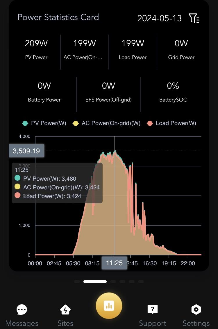

I get what you’re saying however the current inverter nearly maxes out close to 3.6kW at noonish with the 10 panels I have so adding more would clip my generation at the overlap. Plus the other facing roof is actually on a detached garage so wiring would be very difficult and cost more to use the same inverter even if i replaced it with a larger capacity and two MPPTs.

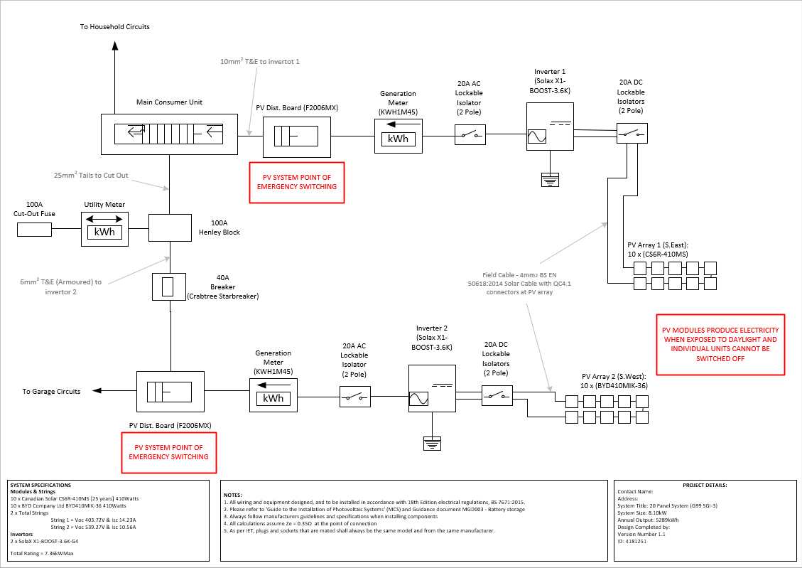

Thanks that’s what my plan was, notify DNO but not Octopus. What information do I need to provide once the G-99 SGI-3 work is completed?
Fast track it is then 😉
That’s what I thought. But do I do a G99 fast track or keep quiet from DNO also?
Hello, I’ve just had 10 x 410W panels fitted to my SE facing roof. I’ve got a Solax Boost G4 3.68kW inverter and this has been professionally installed with MCS certificate and G98 DNO. I’m on Octopus outgoing. I want to expand my system by fitting a further 8 panels to another SolaxBoost G4 3.68kw on a SW facing roof so that we have generation throughout the whole day rather than mostly in the mornings. However I want to fit this expansion myself…. So my questions are: 1) Since both devices qualify for G99 fast track I can do the DNO myself but do I need to provide an MCS certificate afterwards? 2) If the answer to Q1 is no then since I’m already exporting to Octopus then I don’t feel that I need another MCS or to tell them i’ve expanded. I mean how would they know? Even if I go over 3.68kW the DNO is happy so who cares? J
