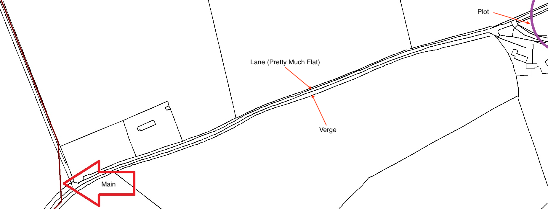

  1. That's why I'm confused - the house is 600m away. Our supply pipe runs in a field for 600m from the mains to the house - hence why I requested a 50mm connection to increase potential flow rate (based on comments on here ?) The meter will be at the mains in the footpath (which is also in a field!) - so mains, short comm pipe, meter, our 600m supply pipe. They know this as I sent a diagram and the Clancy person they sent to survey phoned me on the day to walk through everything (and was the only person i've spoken with related to Southern Water that has been helpful so far) I'll try phoning them tomorrow as it sounds like the P25 meter and bypass is not something that makes sense in this setup..? edit: when I speak in present tense I mean future tense - none of this exists yet, I'm trying to get all the information before i push the button on a purchase.
  2. ? Hmm. Does that 32 feed back into the 50 to go up to the house? It’s a 600m private supply so the plan was just one 50mm connection. Is the 32 bypass always open or does it get opened/closed depending on whether we are on fire..? I can ask the water company but the have a 28 day turnaround ?
  3. Context - long private supply pipe for new connection where I made enquiries on whether I could get a 50mm connection to main. The quote has come back and it refers to “1 x large diameter connection 63mm” and them installing a 50mm comm pipe to our supply.. however the meter arrangement gave me pause.. ”Lay 1no. 50mm comm pipe and install 1no. Tagus P25 meter with 32mm bypass arrangement to serve new house.” Does this mean the meter is only 25mm? Don’t laugh at me for my plumbing ideas but I’m wondering does the 32mm bypass mean that when water is on almost half goes through the meter, the rest through the bypass and they do some maths to work out how much water has been used? Why wouldn’t they just use a 50mm meter? I’m guessing at accuracy of recording given this is just one house?

  8. I’m going to put a 50mm pipe in while we have the trench. If I can only get a 32mm connection my understanding is that the larger pipe on the 600m run won’t cause any issues? One of the laying quotes included sanding, the other said it’s not necessary. Substrate is chalk. Ive read that pipes can oscillate and so sanding or conduit is recommended - for peace of mind and the small additional cost it seems sensible to get it sanded or in conduit too? Final question - the final 100m of the run is also along the path of where we will bury power - can they share a trench or do we need to dig two? (I’ve done no research yet, just asking while I’m here!)

  12. Thanks all; apologies for not being clear. Looking at more documentation I may have used the wrong terminology by calling it a communication pipe - maybe it's 'supply pipe'. The water main is 600m down the road. Height change from one end of the proposed pipe to the other is ~2.5-3m. There is our plot, a neighbouring plot and a field. The cost from southern water to bring the main to the site is significant, so the current proposal is for us to run the pipe to them and connect to the main. There would be 3 pipes - ours, the neighbour and one for the field - they would all be laid in the same trench. All 3 pipes would run independently - each would connect to the mains and the meter would i believe be at the mains end of the pipe (i.e. 600m away from the property). Each pipe would serve only one property. SW would only guarantee the pressure at the meter which will be 600m away; I'm having a hard time getting information out of them so I don't know what the pressure available actually is. I've asked SW if i could have a 50mm connection, to answer that question they want to know my required flow rate. 4 bed/4bath with 4 adults - so likely we will need to use 2 showers at once, maybe 3. I'm looking at GSHP for heating - I assume the question of vented/unvented for that would depend on water flow and pressure - so it's a bit chicken and egg.

  14. I’m still investigating costs for our build. Nearest water main is 600m down the road, height difference is from one end to the other is about 7.5m. We have an easement to put the communication pipe in the field next to the road and have costs for the trench, all reasonable (sharing with a neighbour who is also going to put a pipe in). Current quote is for a 32mm supply and this is the default for Southern Water. The house will be 4 bed 4 bath and I’d like to look at GSHP for heating ~3000sqft. Some have suggested I need a 50mm supply to account for the length of connection. I don’t have a read on the pressure at the mains. The nearby houses describe it as ‘good’ but that isn’t science. Do I need 50mm? I’ve enquired with Southern Water to find out if 50mm is even possible; their response: 1. As southern water cannot advise the customers on the pipe sizes required, please consult your plumber for the required flow rate and confirm the exact required pipe size. 2. Please confirm the flow rate if your requirement is 50mm pipe size. I’ve spent time on google but it looks like flow rate is hard to calculate? Is there an easy button? I don’t have a plumber involved yet as I’m still investigating everything.
