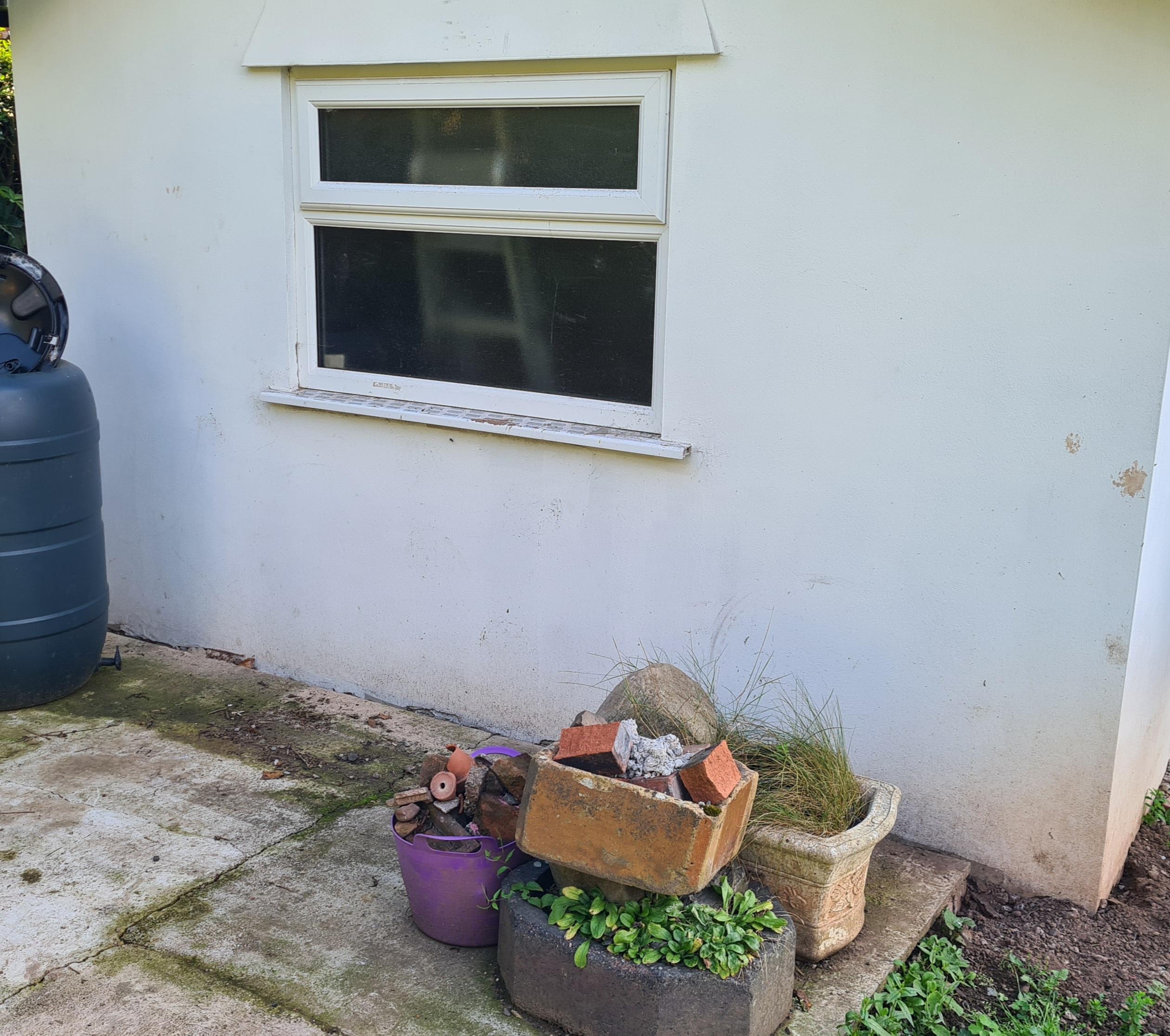

New Member (2/5)

  3. I was going to install eaves vents at the top. @TonyT Although there is vents under the first corse of slates so thought that would suffice.
  4. I think some plastic pipe to extend is the way forward @TonyT Good stuff
  5. Okay. Don't these need fitting towards the bottom of the "cavity"? As the photos show the wall is block plus two corse wide in the bottom?. Thanks for suggestion @TonyT much appreciated
