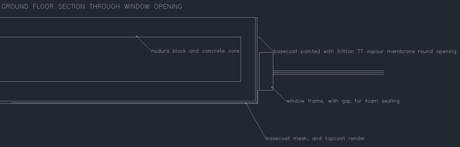

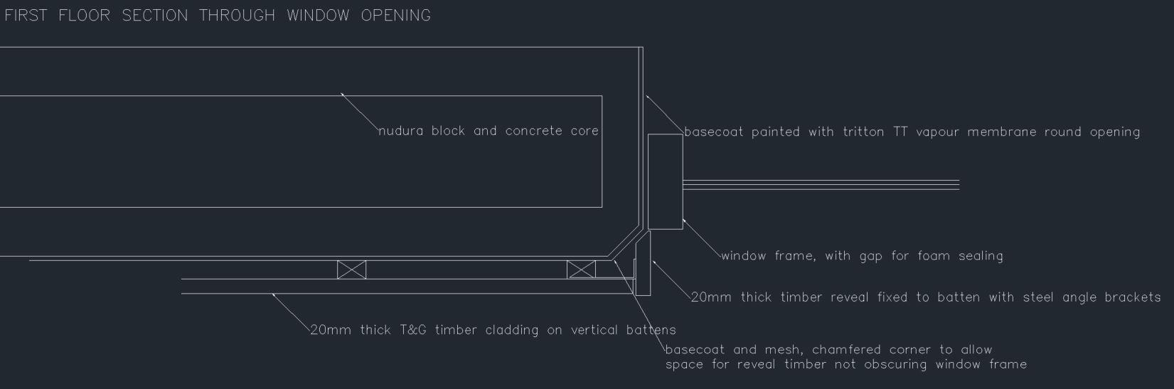

Nudura window reveals with timber cladding
Andrewb replied to Andrewb's topic in Insulated Concrete Formwork (ICF)
Thanks very much for these ideas. Having a common detail and the window bead for rendering both look good. I'm in Gloucestershire near the Severn, a little bit exposed, but not massively. The width of the fixed bit of my Norrsken window frames will only be 29mm, so I don't have a lot of space for an eps check reveal plus bead and I'd end up obscuring it completely, whereas I'd quite like to see a little bit of the frame ( though i do note the thermal points). I'm thinking of skipping the eps, but using the bead to render up to the window and as above skipping having timber in the reveal. However I've seen other threads suggesting rendering all the way through behind the window frame to aid sealing the window. I could still do this - first base coat, then fit window, then fit bead and second base coat and then final render? -
Thanks Jamie, re. the point on only 10mm. It is true that it is not a lot and I could reduce the thickness of the timber to help further. However, I was also concerned that the timber hard up against render might get damp. Being a novice, I'm not sure what is normal, is that a legitimate concern? I was going to screw the brackets to the reveal timber from the back first and then fix to the batten (wouldn't be able to take it off again easily, but not a big issue I would have thought). That's a good point, I'll keep that in mind if I go down this route. Thanks -
Good evening, I'm currently working towards getting a survey done by my window company, so trying to get the openings into their finished state and apply a render basecoat. I've been looking at the reveal details and have done some sketches, so it would be great if I could get any feedback on them. The exterior finish is render on the ground floor and timber cladding on the first floor. There are a few windows which are vertically aligned on both floors. The openings in the nudura walls are identical width on both floors, but I'm keen that the cladding upstairs does not obscure the window frames so that everything lines up. Chamfering the EPS seems to be an option to me, but I wondered if others had any thoughts? Any comments on any other aspect also welcome!

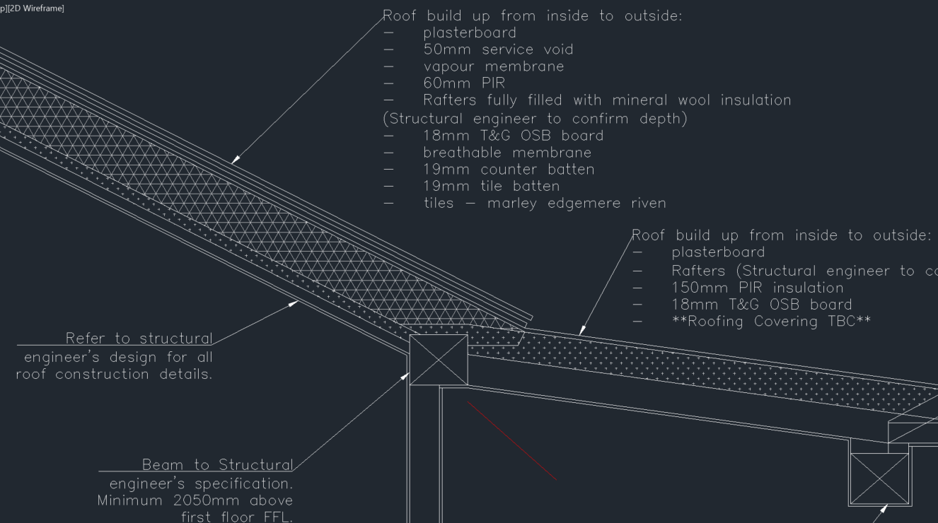

good call, added to the drawing!
Thanks for this, some useful things to think about there. The VCL over the beam will probably be easier and I could continue it along the wall that the beam will be built into. I'll actually have almost the same as you on the right hand side of the drawing where I join the existing pitched roof, so your detail is very good to see, thanks
Good evening, I've got a slightly tricky detail at the junction from a flat roof to a pitched roof, where I have a couple of height constraints. The floor level under the flat roof will step up to the floor level under the pitched roof, so I need to maintain head height on the couple of steps up. I also am trying to not make either roof any higher than they are. My detail laps the warm flat roof PIR insulation over the beam / wall (depending where you are) and the mineral wool between the pitched roof rafters overlaps this. In both the roof areas I am wanting to make the condensation risk low and avoid cold bridges between the 2 roof types. Any feedback or suggestions on my design as it stands would be much appreciated!

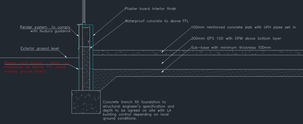

ICF below ground finish / protection
Thanks those are some good ideas to consider. I'm going to use mesh at various new-old house boundaries as a barrier while I've not updated other parts of the house. "Whats stopping them coming up under the type 1 / sub-base?" Good question, hopefully a bit far to burrow? I'm new to this sort of thing, but not seen any details indicating that it's a common concern? -
There are rats around (we're next to a farm) they got in the loft last winter, which was pretty unpleasant and had clearly been there with the previous owner. Luckily they've not been too destructive! Would slates be cost effective? -
Good evening, I'm drawing up my design for an extension using Nudura and am wondering what to use as protection from rodents below ground / visible finish below the bottom of the render - as per the red text on the detail below. What have others done in this situation? Any advice would be much appreciated. Also, if you spot anything else that could be improved please let me know!

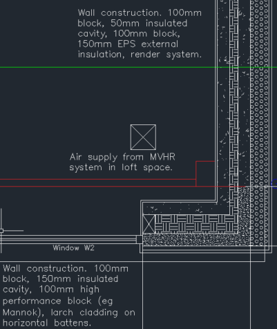

Avoiding thermal bridge behind external insulation
Andrewb replied to Andrewb's topic in Heat Insulation
I might look at fixing compacfoam to the existing wall and then fixing a wall starter (possibly with thermally broken fixings) through the compacfoam to build the new wall from. This would hopefully reduce the cold bridge behind the new ewi. Then I could revert to standard blocks, which I'd prefer as I'm worried about mannok blocks being more prone to cracking. Any opinions? -
Good evening, I wondered if anyone could critique my design of a particular junction on the garage conversion project I am doing. The project adds a first floor and brings out the front of the old garage by 500mm. The existing cavity walls have small cavities and I plan to externally insulate them. The new front wall will be wooden clad, and due to fixing issues and potential fire risks I am not externally insulating this front wall. I'm therefore left with a potential issue of a cold bridge from the front outer skin down behind the external insulation of the side wall. My solution currently is to use blocks with improved thermal properties on the outer skin of the new front wall. Could there be other ways, such as a thermal break at a wall starter where we extend the existing side wall? I'd be keen to get any of your thoughts. In the image below, the red lines show the position of the existing garage wall and garage door.
