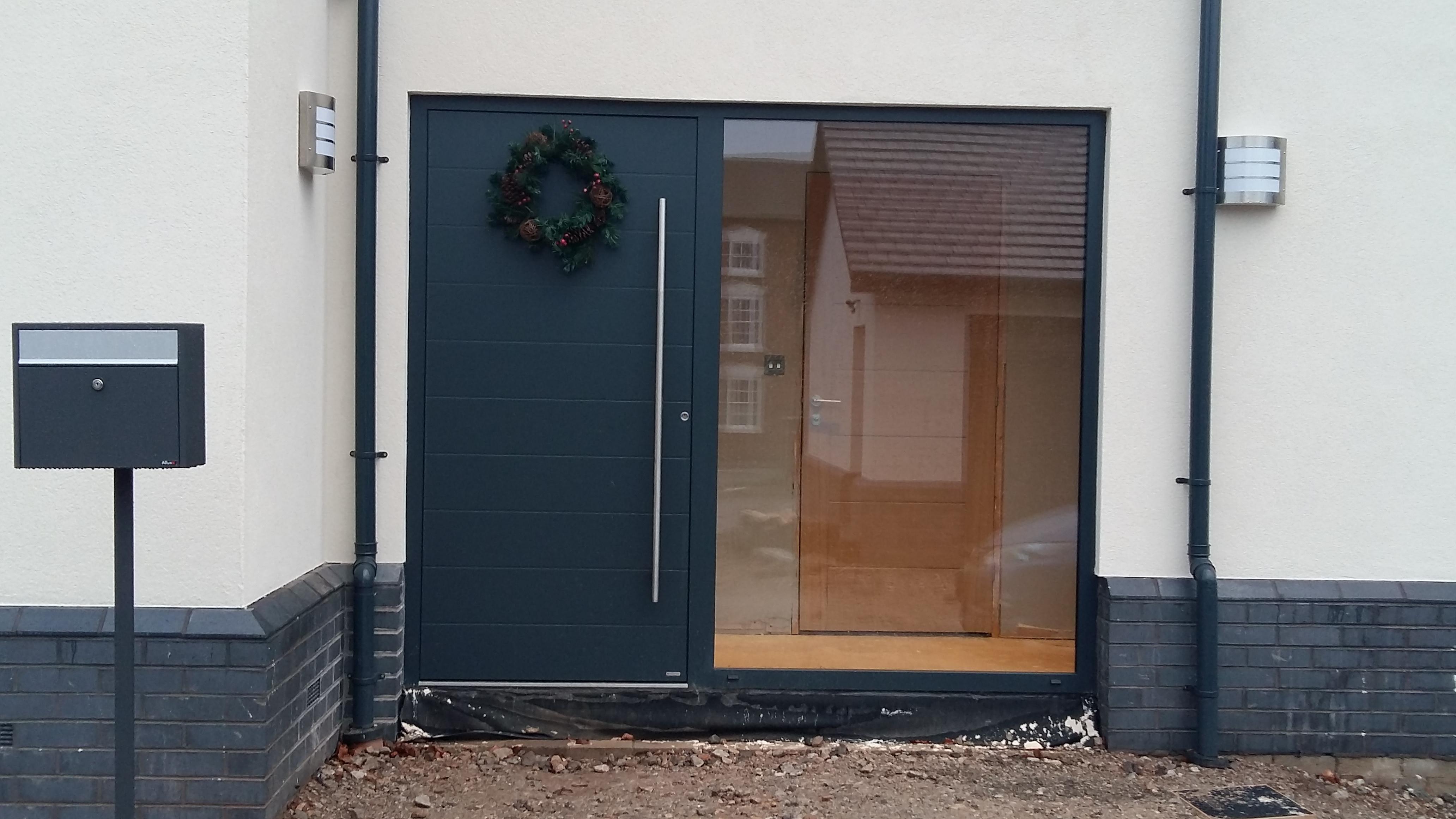

Attaching Christmas wreath to powder coated front door
Jude1234 replied to Jude1234's topic in Doors & Door Frames
Thanks for the advice. I went with a Command hook upside down inside the door and a piece of string around the wreath and over the top of the door? -
Thanks for the ideas. I work for 3M so get a discount on the command things so will go for them? -
