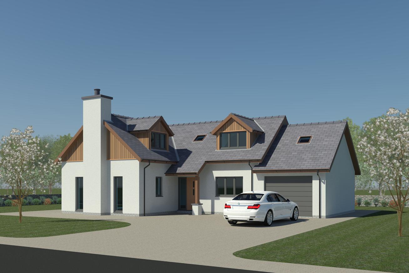

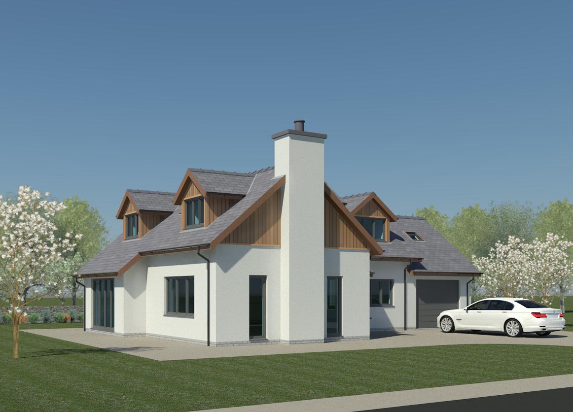

  1. Thanks for the comments all, just looking at at the above option, moving the stairs over a bit would I guess be ok upstairs but I will loose a bit on the size of the kitchen dinner. if I was to convert the garage to a fourth bedroom and en suite I would partition off the utility and so that I have a corridor/extended hallway into the 4th bedroom. dont really mind the utility being a bit smaller, only need room for a sink, washing machine and table dryer really, would also move the back door to there and have a matching full height window in the 4th bedroom? So many possibilities! moving the ridge height of the garage to the same level as the rest of the house would be much better, going to have an informal chat with the planning officer to see if their is any issues with that.

  3. Hi all, ive been looking for a plot for a while, a builder that I know is selling a plot with full planning, selling one and building the other himself. i have attached the design for your comments, the problem I have is due to an expanded family I would like a 4th bedroom. My idea was to either turn the garage into a bedroom and en suite or the study into a bedroom and have the garage as a big study/play room i was thinking I could put in a separate planing application at a later date for a single garage on the boundary with other plot? i am currently trying to obtain building prices so I can work out my budget to see if it's affordable to us as a family. i will be doing a lot of the work myself as I am in the trade as well as my semi retired father. i was looking to do a Timber frame build with possibly an insulated raft foundations, and block outer skin. any ideas much appreciated. Diolch Dyfed SHA-201-02 -Plot 1 -Proposed Plans and Elevations.pdf SHA-201-04(B) -Site Layout Plan.pdf

  11. Sorry yes did mean costings lol! I did consider waiting but I have an idea of what type of build the local council prefer here, generally nothing with a ridge height of over 6.8m so that's why I'm looking at either a 1 1/2 or a 1 3/4 designed house. where any of you able to negotiate the price with MBC after initial quote?
