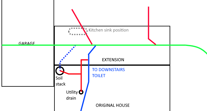

  6. Many thanks all - managed to core drill out for the 40mm today and feed it into a temporary run, so I'll get a roddable bottle gully and see how I get on with installing it! Looking at a rectangular hopper so I get a section to feed the 40mm into as well as a removable grid.
  7. Thanks to my builders (who have since gone bust and left me to pick up the pieces), no internal waste pipe was allowed for the kitchen sink in my new extension. Rough drainage layout is as below, where green is the original main drain run (shared with next door, flowing left to right), blue is original drainage and red is new (again, blame the builders...!). The blue dotted line shows the original outfall from the soil stack, which had to be moved to make way for a pile. Everything underground is 110mm plastic. At the moment, the red pipes sticking out to the north are capped, but these are intended to be inspection chambers (condition of the build-over agreement as we had to remove two). The construction under the extension consists of six piles, 250mm reinforced concrete slab, ~250mm concrete infill, DPM, 100mm PIR topped with 65mm screed embedding UFH pipes, so I don't see any possibility of going down - I think my only option is going to be an external gully with 40mm through the kitchen wall, but I'm interested to hear if anyone has any other ideas! If I do have to fit a gully, I'm thinking I'd be best running the pipe across to the right-hand inspection chamber so the flow doesn't have to make a 180-degree turn - does that sound OK? Having never done this before, I'd appreciate any tips on how to make sure it works and doesn't look completely awful... Many thanks in advance for any advice! Sean

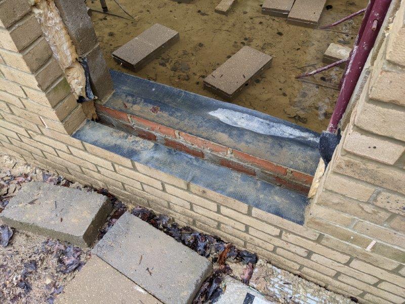

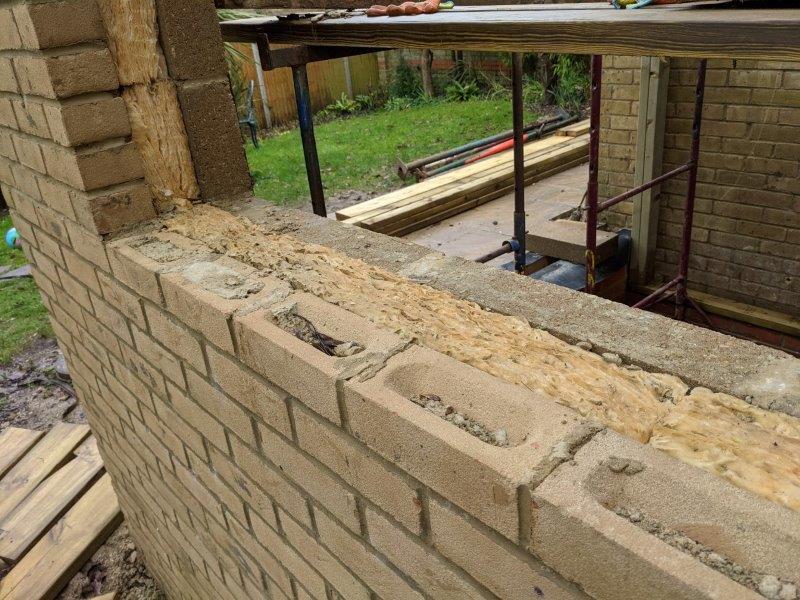

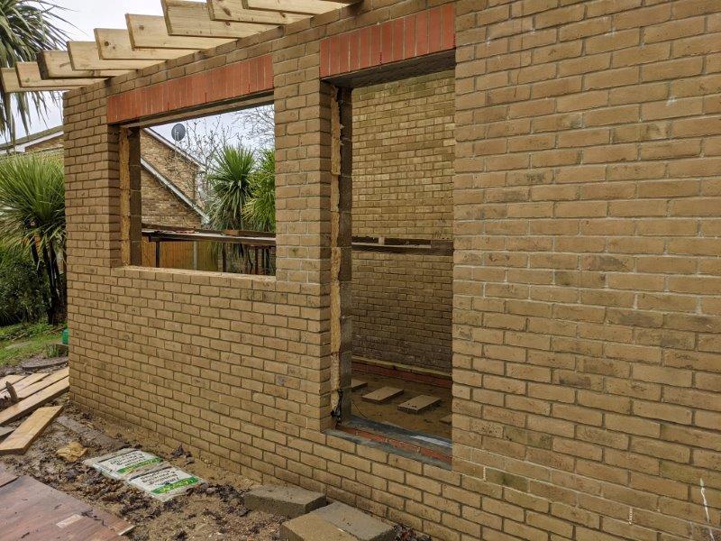

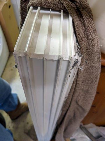

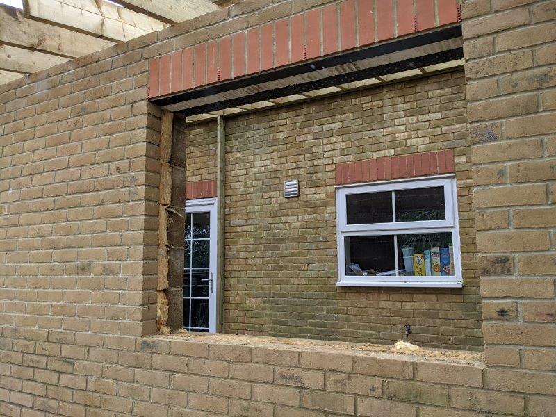

  8. Hi all, and apologies in advance for the newbie questions! I'm having an extension built and I've decided to take on fitting the windows and door myself. I've already purchased these (A-rated Rehau white UPVC) and, once the builder gets around to completing the roof (!), I'll be ready to get them installed. The walls are conventional concrete block inner leaf / brick outer leaf, 100mm cavity with full-fill mineral wool insulation. There will be standard cavity closers installed, again when the builder gets around to it. Having read around quite a lot about this, I purchased the windows and door with 180mm sills to allow me to set them further back into the opening, overlapping the cavity closers, to reduce cold bridging. I have galvanised straps to mount them with and I was planning on using the Illbruck i3 system (TP600 Compriband outside, FM330 foam around the frame then ME508 membrane inside) to seal and secure the window in place. My questions are mostly about the sill fixing. I understand I've got a couple of different options... Bed the sill onto mortar first, then fit the window on top - if I do this, given the depth of the sill, presumably I need to put some packers between the sill and the cavity closer to support the back edge, then fill the gaps with foam? Do I need to worry about putting DPC up the back of the mortar and sealing to the bottom of the sill? Attach the sill to the bottom of the window first, then bed onto packers, sealing along the outer edge with Compriband then filling with foam. If I go this route, given the bricks in the window reveal are laid frog up, do I need to fill the frogs with mortar first, or just use extra foam to fill? Do I need to worry about mechanically fixing the sill down to the brickwork? I guess this is more of a concern at the door, where someone might step on the deep sill by mistake. And does the fixing detail change at the doorway? I asked my builder about how he's planning to close the cavity at the door threshold and he just said they'd put a cavity closer then run the screed out to the door once it's fitted. Finally, when it comes to the Compriband, do I fit in in the outer "groove" on the side of the profile? Presumably I need to allow for the depth of this groove in addition to the gap between the outer frame and the masonry when I size the Compriband? Thanks again! Sean
