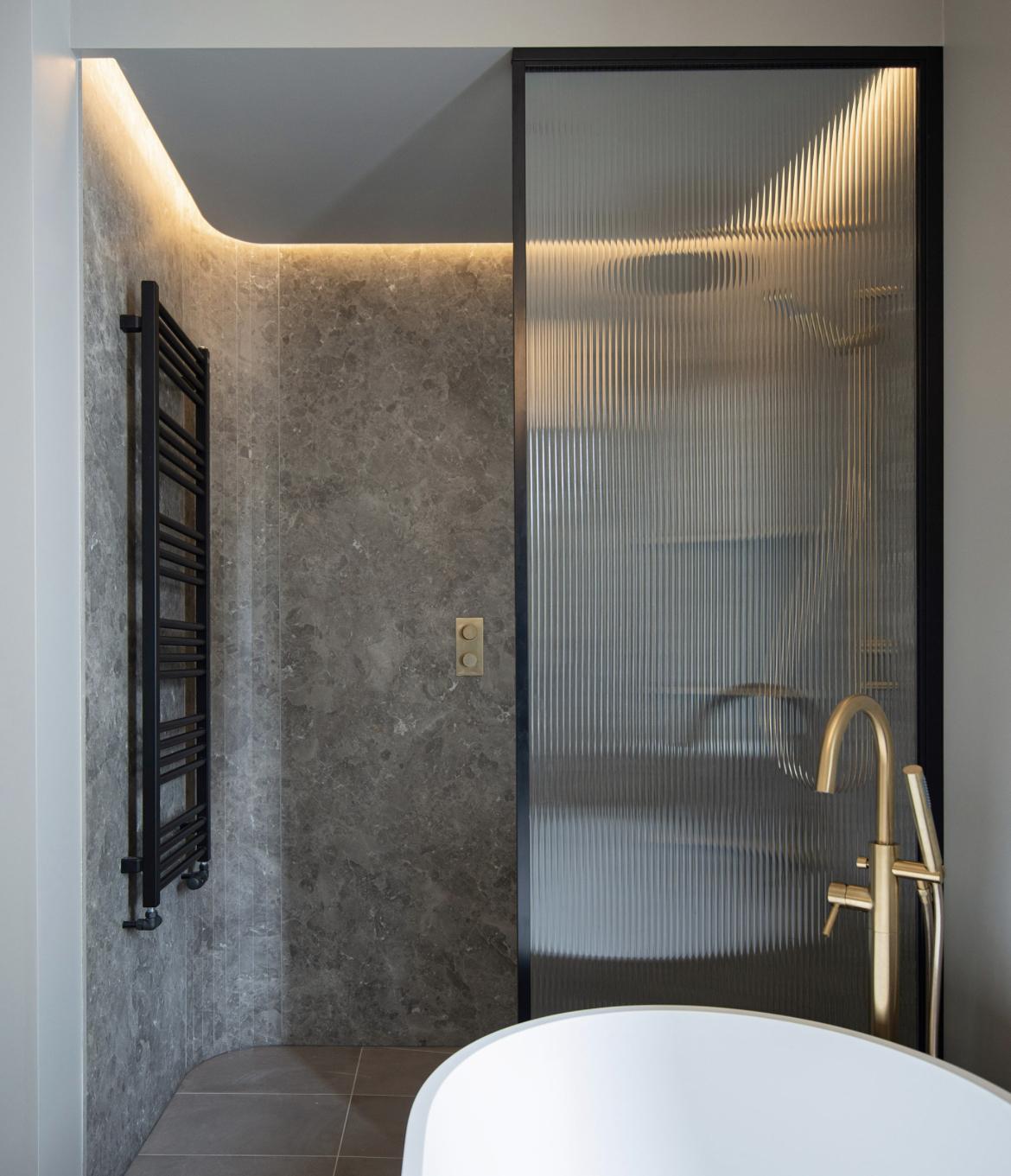

There were a lot of doubters on this thread. It couldn’t be done, they cried. I’m mad, they said. They were wrong: We changed the colour of the towel heater, but otherwise nailed the render spot on! Tile cutting company were excellent. Only mistake they made was that they forgot to label the pieces, which gave me an interesting game to play matching the adjacent tiles; took me a day to match them all up. Was a fun day, though required a lot of care; turns out that 2520 by 40 by 6mm porcelain is harder to slide around than the average puzzle piece. #focuseddetermination #nevergiveuponyourdreams -
