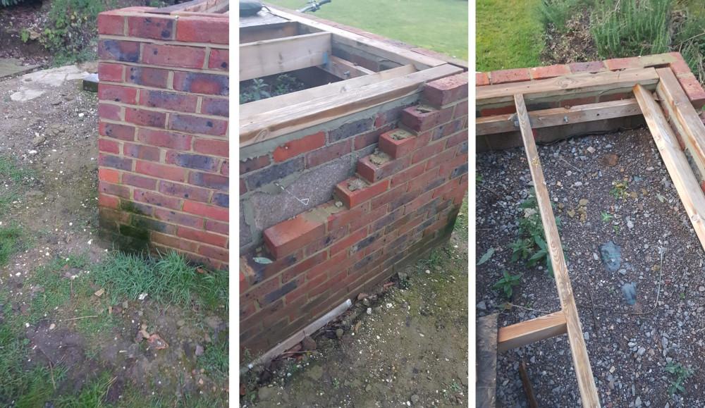

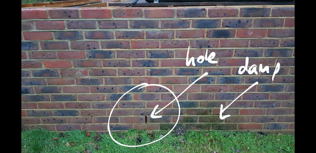

mws2000's Achievements

  1. Hi .Thanks for the replies. I don't think the builder has put a DPC in but I will check with him. Fairly certain there is no drainage at all. The wall is on 150mm concrete. There are some weep holes but they are a bit all over the place. One is close to some damp as you can see in this picture. I'm beginning to think that filling it with aggregate and paving is the only way forward here. Even if I do that, the wall may take some time to dry out as it is damp right now.
  2. Yes, beam and block would do it I think. Filling with aggregate would cost around £1,000 from my calculation, which is probably cheaper than beam and block. What if we keep with decking, how do you think we get the walls to dry out and stop getting damp in the future? Thanks
  3. Thanks. My wife wanted hardwood. I had thought of paving it but I think that's 25m3 of hardcore... would you put that much in? I think that should stop the damp though. (And the joists are already done for the decking).
