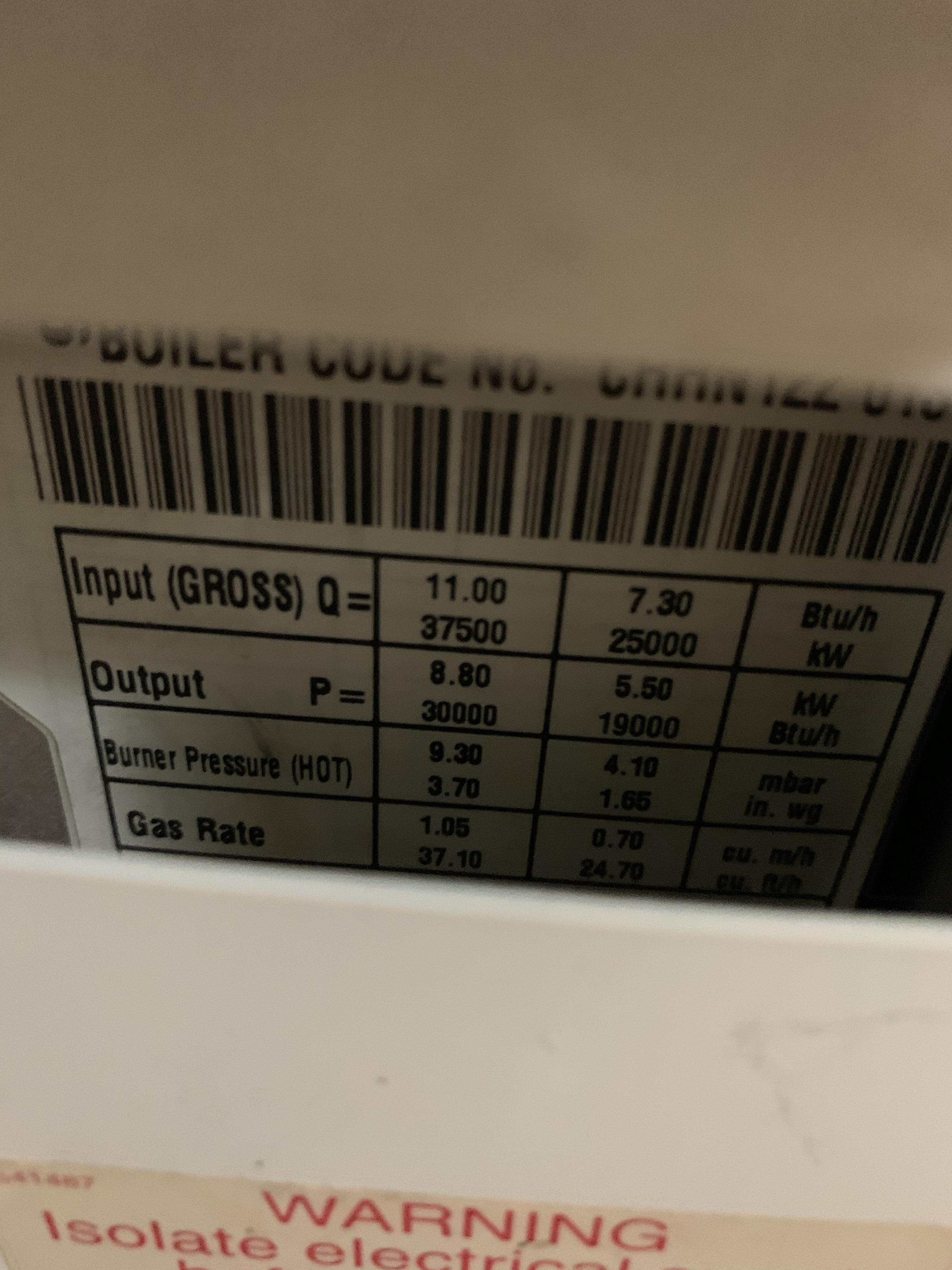

It’s a potterton suprima 30. Not really sure what the various measurements are but seems to be an output of 8.8 at max pressure. The three rads I have now are the old fashioned cast iron double column ones. Living room is 110x50, main bedroom is 160x75 and bedroom 2 is 90x90, which struggles to heat the room to 20 in current lower single digits. I’ve emailed a few of the smaller mvhr unit manufacturers like blauberg and they all seem to say they don’t recommend using 100mm ducting. I did think it might be fine provided I didn’t use it on boost although might invalidate the warranty. I meant the unit now has a trickle speed of 30m3/hr extraction rate which is currently split so the bedroom is getting air extracted at the rate of 15m3/hr. And even then it still gets condensation and mould build up. It does seem like a heating upgrade would be the best way to go about it. Considering if I was extracting from the bathroom now the temperature in there is only 16 so would be feeding 12c into the rooms with a lower end mvhr unit. I had considered getting a single room recovery unit. My only concern that having one in the bathroom and bedroom 2 would cost around 800 installed and there would be no ventilation improvement in the living room or bedroom 1 as they’d be in a vacuum. Whereas trickle vents in all rooms and one extraction point in bathroom would create a constant airflow in all rooms. -

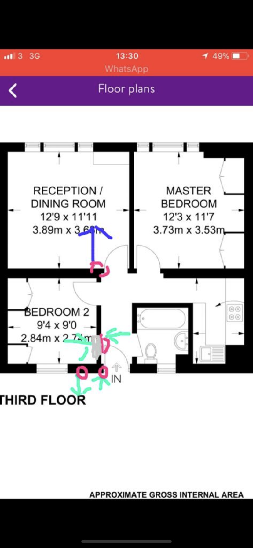

I’ve actually requested a thermal imaging camera from octopus now to actually see where the weak spots in my insulation are. I did initially think it was the ceiling but after getting secondary glazing in the main bedroom I realized that room would heat to 23 when outside temperatures were around 8-10 which didn’t seem too bad. I was also able to heat the living room up to about 22 last night with outside temperatures around 1, when using an electric oil rad heater. Usually this room would be limited to 18/19 at the warmest. Which makes me think I need another rad in there, although not sure if the current boiler can handle that as it already struggles to heat them all up if they’re open. The issue with the current mvhr is that it’s really old and noisy on boost. Which was why I was thinking of upgrading it and then ducting to the bathroom and main bedroom. But most units require 125mm ducting so it becomes a whole new installation. And for some reason or other even when it’s on trickle(15m3) all the time extracting from the second bedroom that room still has an RH of above 60% most of the time and a lot of condensation on the windowsills. So the end result is that I’d need to spend probably in the region of 1k-2k for a new system including additional ducting. And then the question is whether that’s worth it for the energy savings or just to get trickle vents on all windows and have one extractor in the bathroom causing air to come through all the rooms continuously at a low rate? -

Hi all, I keep coming back to this forum when researching mvhr so thought it would be a good idea to create an account and post a thread. I live in a 1930’s apartment block on the top floor with flat roofing, hence no loft. It’s a 2 bed 1 bath 55m2 square apartment with all the rooms basically off the same small hallway. It’s essentially not really airtight, there’s a big air brick in the kitchen above the boiler. Temperature wise it’s also cold. Now with London weather around the lower single digits(3c) the second bedroom struggles to get above 20c with heating on all day and the bathroom only has a towel rail and is probably 17c. Living room is 19c and main bedroom is 22c as it has secondary glazing, is south facing and has the biggest rad. The previous owners installed a kair trakmaster mvhr which is about 10 years old and doesn’t seem to be helping much. The second bedroom is quite humid and is constantly getting mould on the ceiling. I was thinking of upgrading it but it’s positioned in the second bedroom which means noise is an issue for the lodger in that room. The other issue is that they cored 100mm holes which means I’d ideally need to get the existing 4 holes cored to 125mm which is what it seems most units ducting size is the days. Which adds even more expense to the upgrade. I’m currently in the process of getting the windows replaced which is why I’m having to decide to either go for the passive ventilation option of having trickle vents installed and one continuous extractor fan in the bathroom or a new and better mvhr unit. I’m struggling to see if the cost of around 1,500-2,000 for unit and installation would ever pay itself back. My concern with passive ventilation is that it would make the cold apartment even colder if 2c air is constantly drifting into a room that struggles to stay above 18c when “airtight”. The other issue is that in summer it boils! Bedroom 1 will often be 30c at night and as it faces a busy road I have to keep the windows closed. Was thinking of getting acoustic trickle vents and having the bathroom fan on boost during summer might be one solution. any advice would be appreciated. Thanks
