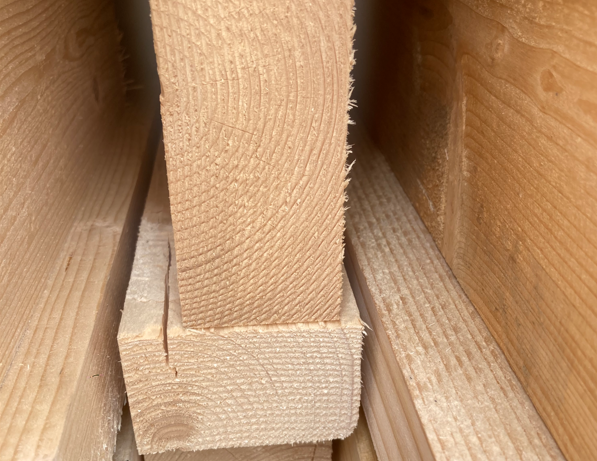

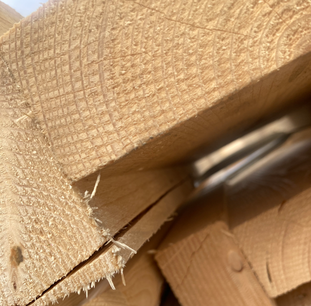

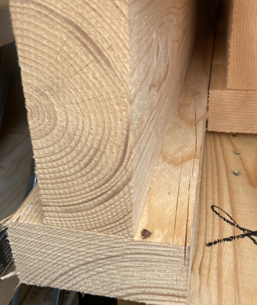

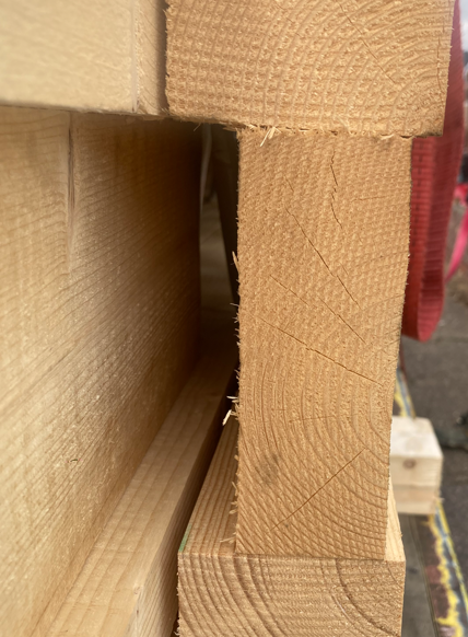

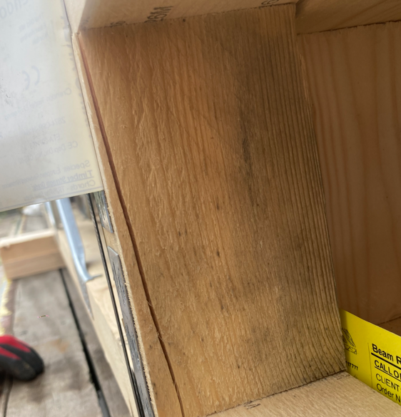

Posi Joist - Are these sub standard?
bradders3109 replied to bradders3109's topic in Floor Structures
Thanks Mark -
Hi All, We are now well into our self build and have poured the (Nudura) walls for the first floor. This morning the posi joist company arrived with our joists and we have refused the delivery. Since we are not seasoned builders I'm looking for others opinions on the quality that should be expected from a precision product. Please see attached and give us your opinion on the quality of the joists. Defects that we have highlighted are splits in the cords, splits in supporting blocks, supporting blocks are not manufactured tight to the cords and many of the trimmable ends are not centred between the cords.
