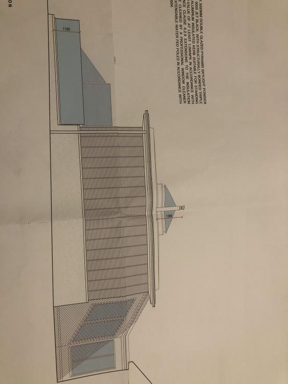

  7. Hi all, Quick background Plans passed and granted 3 years ago but scheme not suitable for parents or home, sibling had taken it upon himself to commission architect and architect went ahead with a plan which was all bells and whistles but completely impractical for what parents needed, no input from them was taken, he just designed and went with what he imagined and sibling agreed. I then took over and spoke to a few architects about making some changes to the original passed scheme without too much cost and after some recommendations commissioned an architect. All very positive, liked his ideas, liked him as a person, had to clarify my parents vision and reign it in when needed. After what seems like an eternity and the above architect who went AWOL (went silent for 5 months, complete radio silence), finally our plans have been submitted to planning and we can start to move forward, he has just come back with some costs for SE's and they are coming in around 3800 +VAT, I am a bit mind-blown by this amount and started searching google for approx costs, I know this is dependent on plans so we have a 1920's bugalow and are putting a large 1 1/2 story extension behind it with asymmetrical roof and a loft conversion in the existing bungalow, could anyone give me rough ideas on what cost should be and what questions I should be asking architect? I know these quotes are from his preferred SE's but can I commission/approach my own ? I have come across someone quite capable online, what should I be asking and looking for? Thanks so much for anyones input!

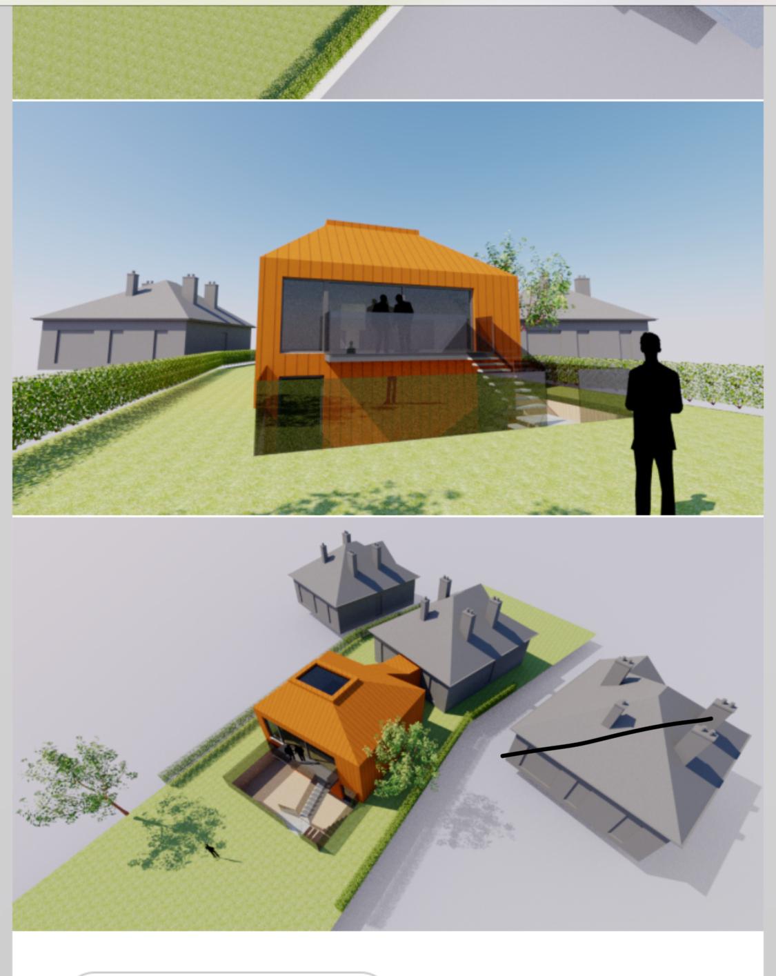

  12. Glad you found a way around it and it was somewhere where PD was allowed after! we are hoping to just raise the height of the roof to the roofline point in image above to minimise excavation and need for stairs and an extra metre to the back!

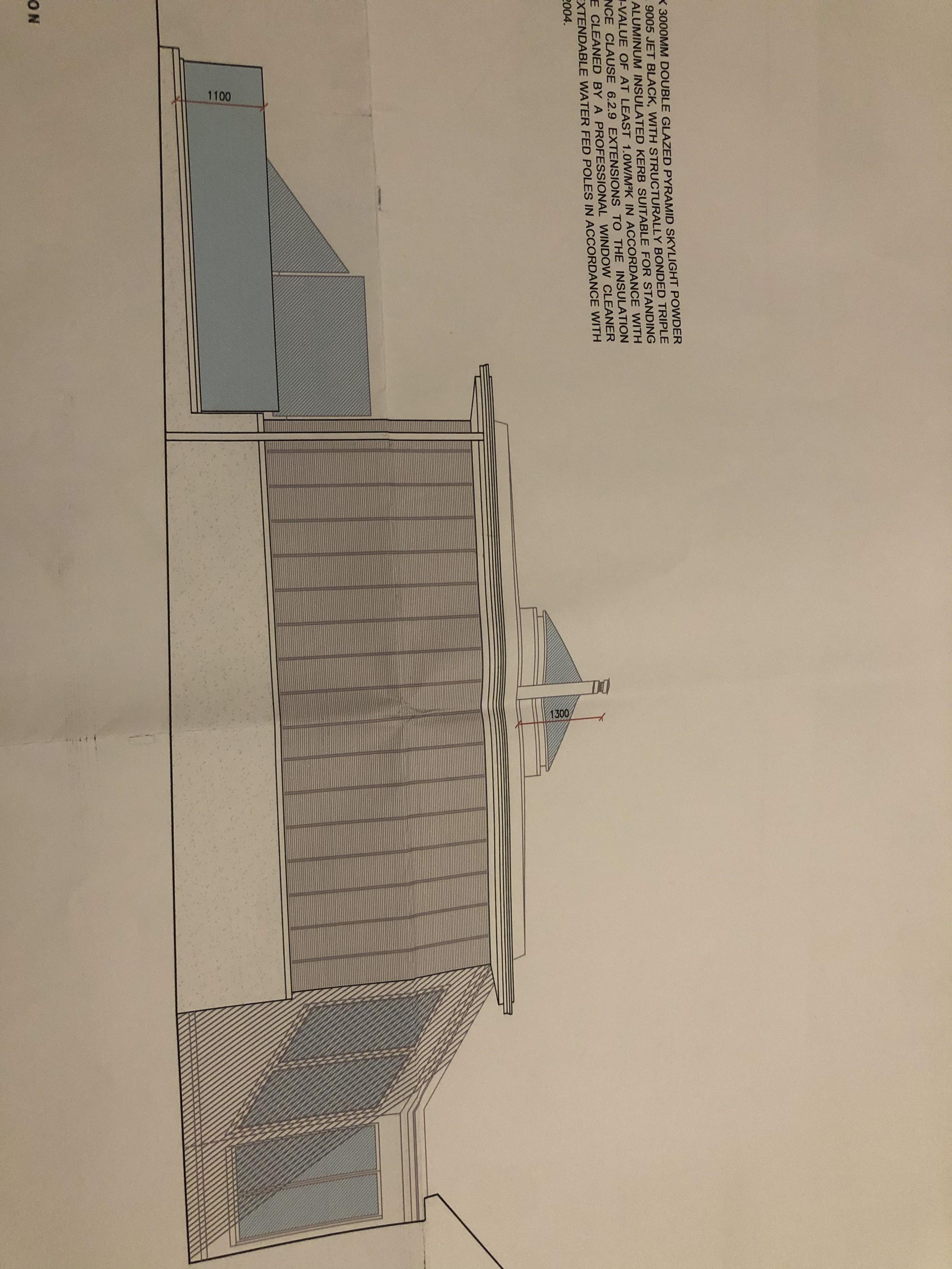

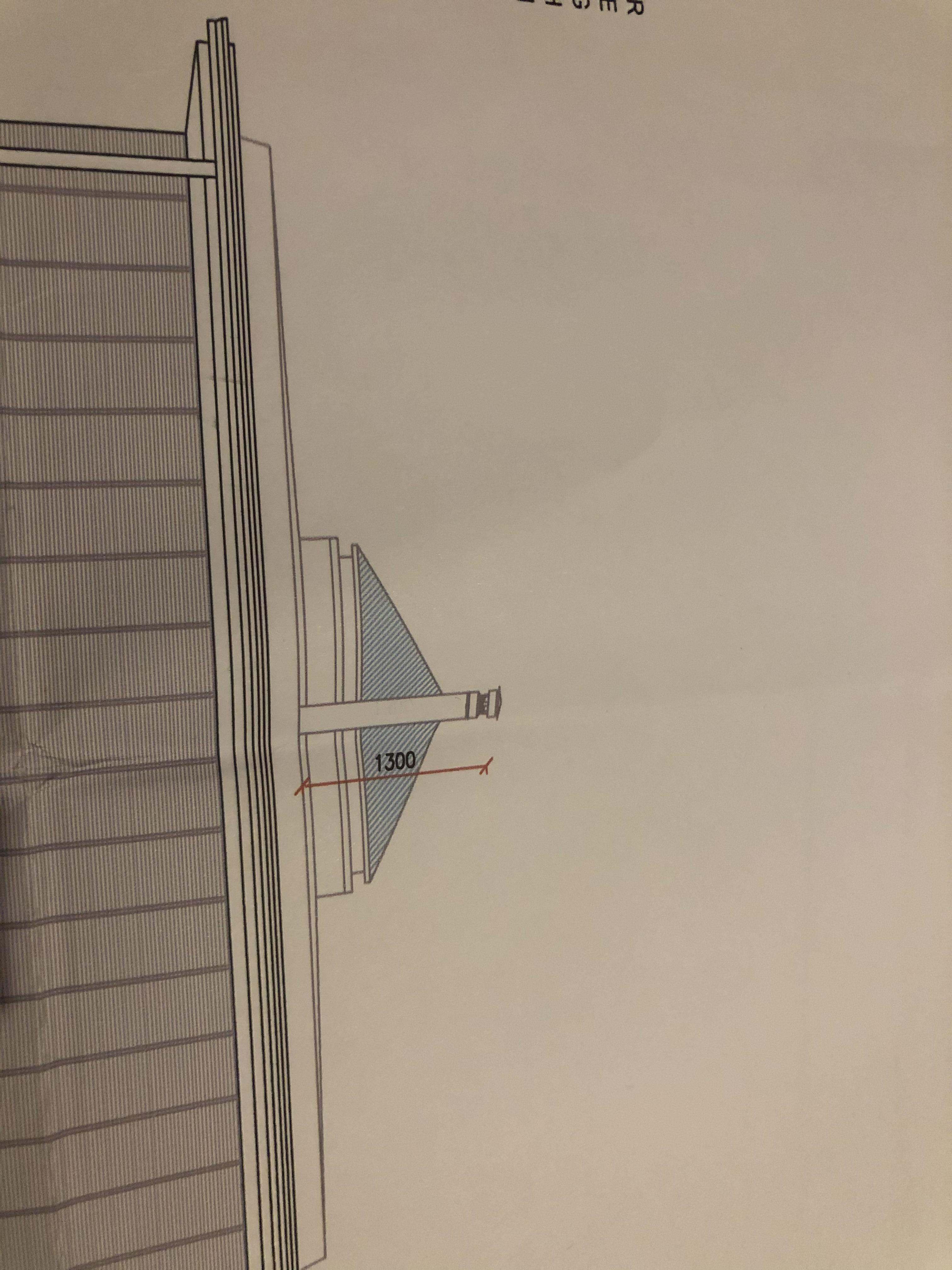

  13. Thanks for replying Joe! Yes will persuade uncle to go with and help out and it totally makes sense to go in with requirements of need to have - nice to have! from the initial image the original architect proposed, (above), to utter craziness when I looked at the warrant drawings which looked nothing like above image (passed warrant image below) I started to question why things were done the way they were, I mean pyramid skylight 1300mm tall requires extra digging, why not put flat roof/sky light in raise height of roof and excavate less! the excavation and removal of soil was going to cost a fortune in itself let alone tanking/waterproofing etc!

  16. Thanks Mr Punter, so that means from the lowest point on that image +52.470 to the eaves measurement up at +55.879 is 3.409 metres would this be about right? Thanks!
  17. Hi all, Please can anyone tell me what these numbers relate to, above ground level, meters, cm, sea level? Thanks!
