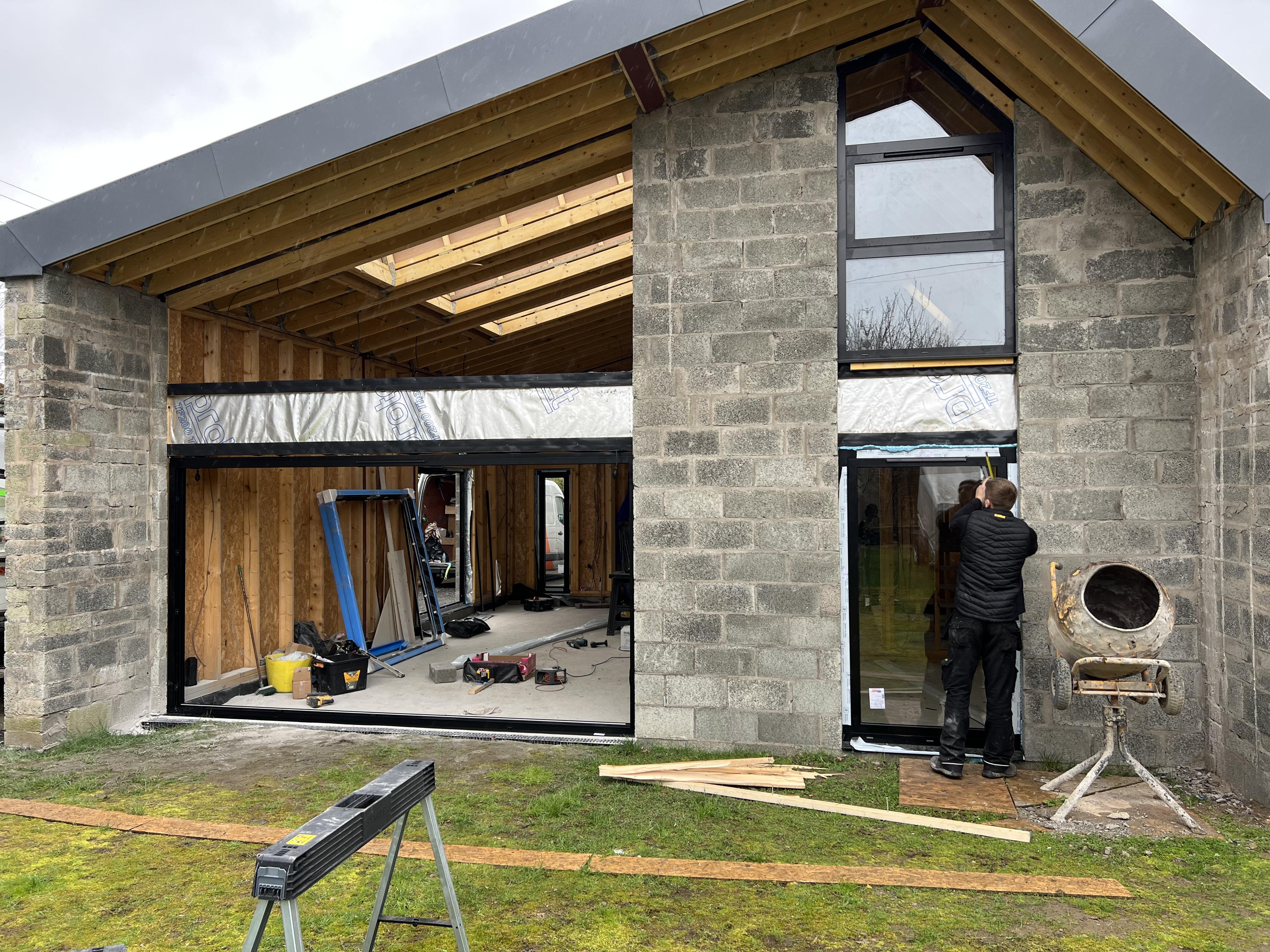

  13. So….. The glazing company blame the builders for having the fire stop incorrectly positioned. And stand their ground that everything is good. They have now fitted the angled window above the sliding glass, and had removed the frame to pack with timber ply, to make it a snug fit. The chap we are going to use for the rendering job today said the glazing company have mis measured. Looks like we are sucking it up, but I will piss n moan with the other issue at hand ( an incorrectly ordered door) that is still not resolved and looks like at best is 6 weeks away

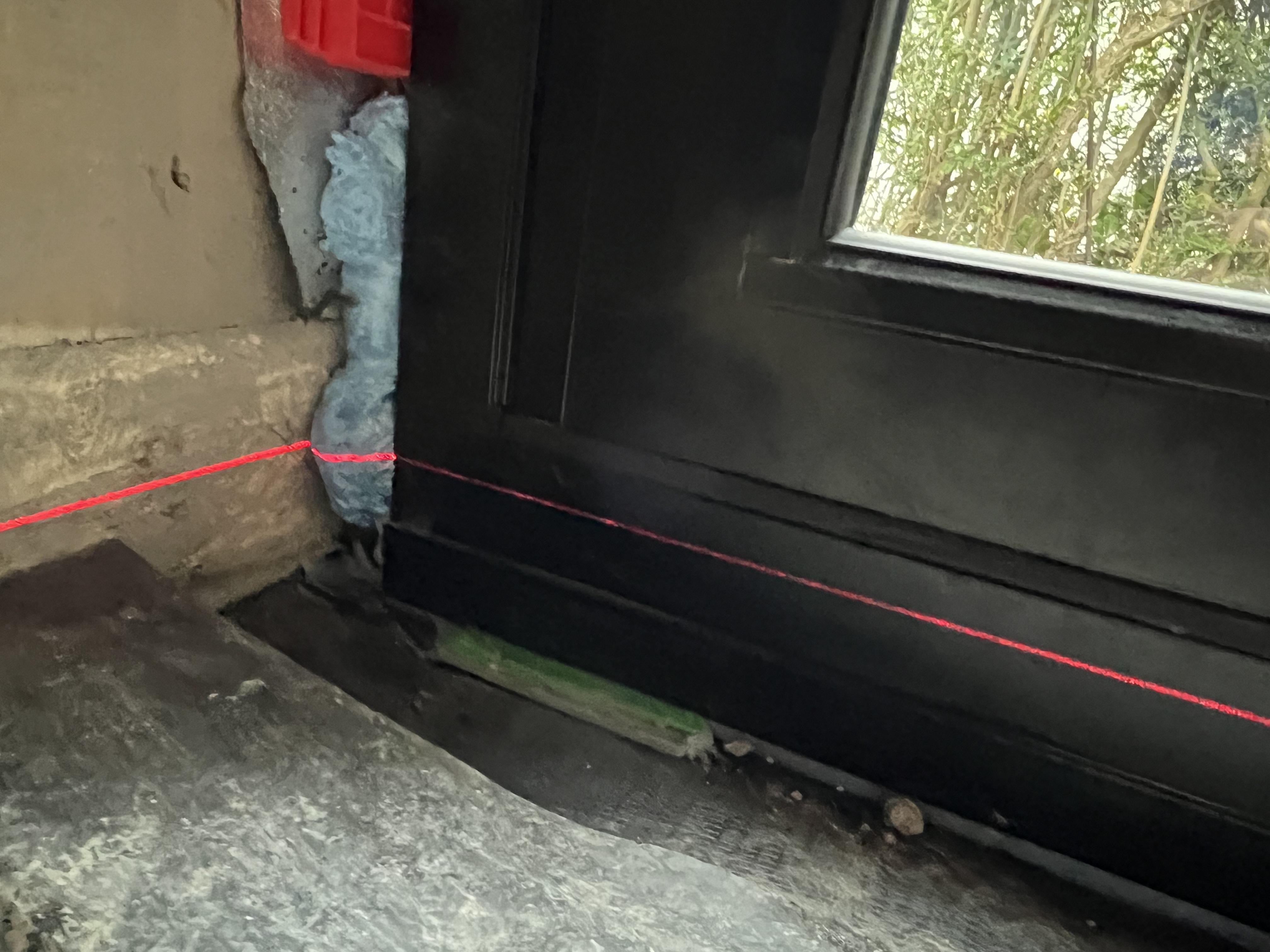

  14. El-cheapo laser gave out the same result as their expensive professional tool (to my surprise too) Tilt & Turn is to be re fitted

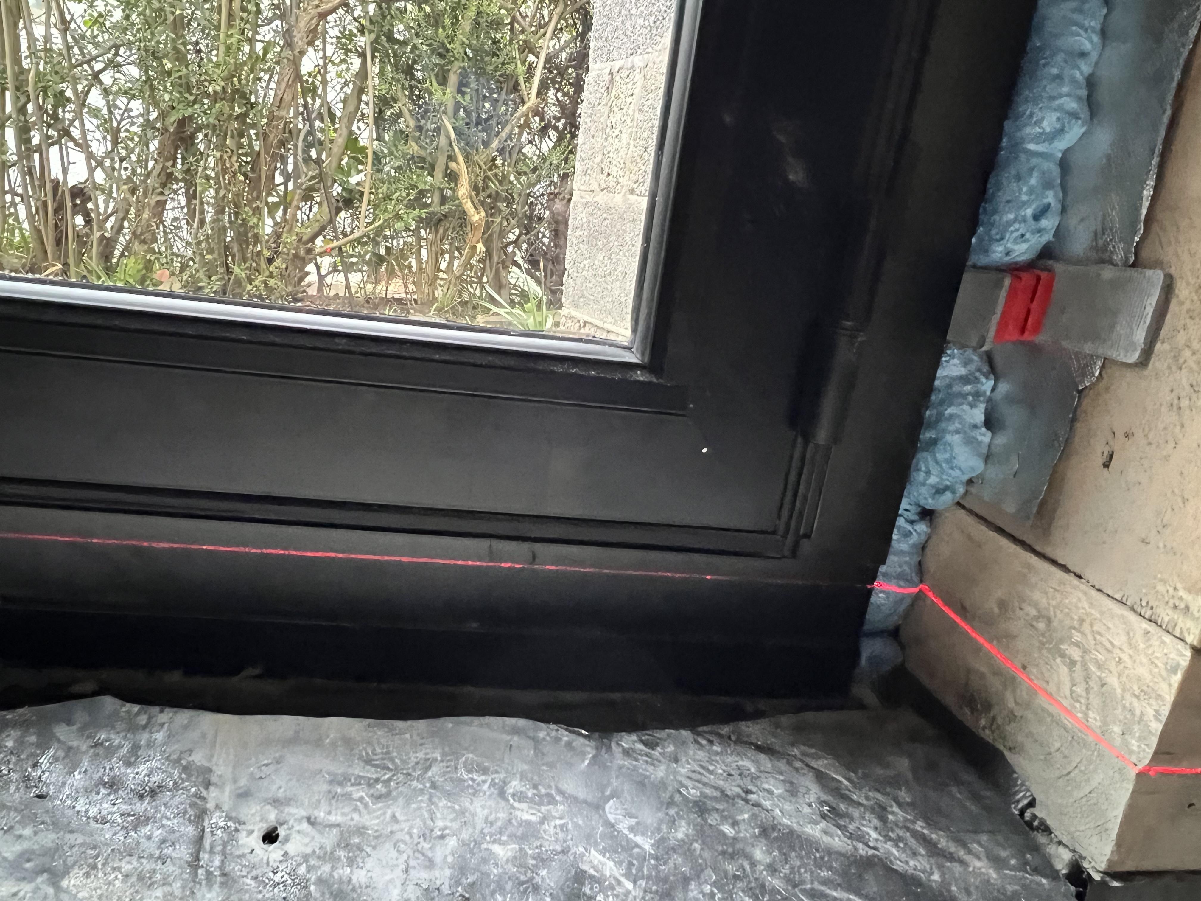

  16. laser showing the other issue of the uneven T&T level But that’s for another day! 😕

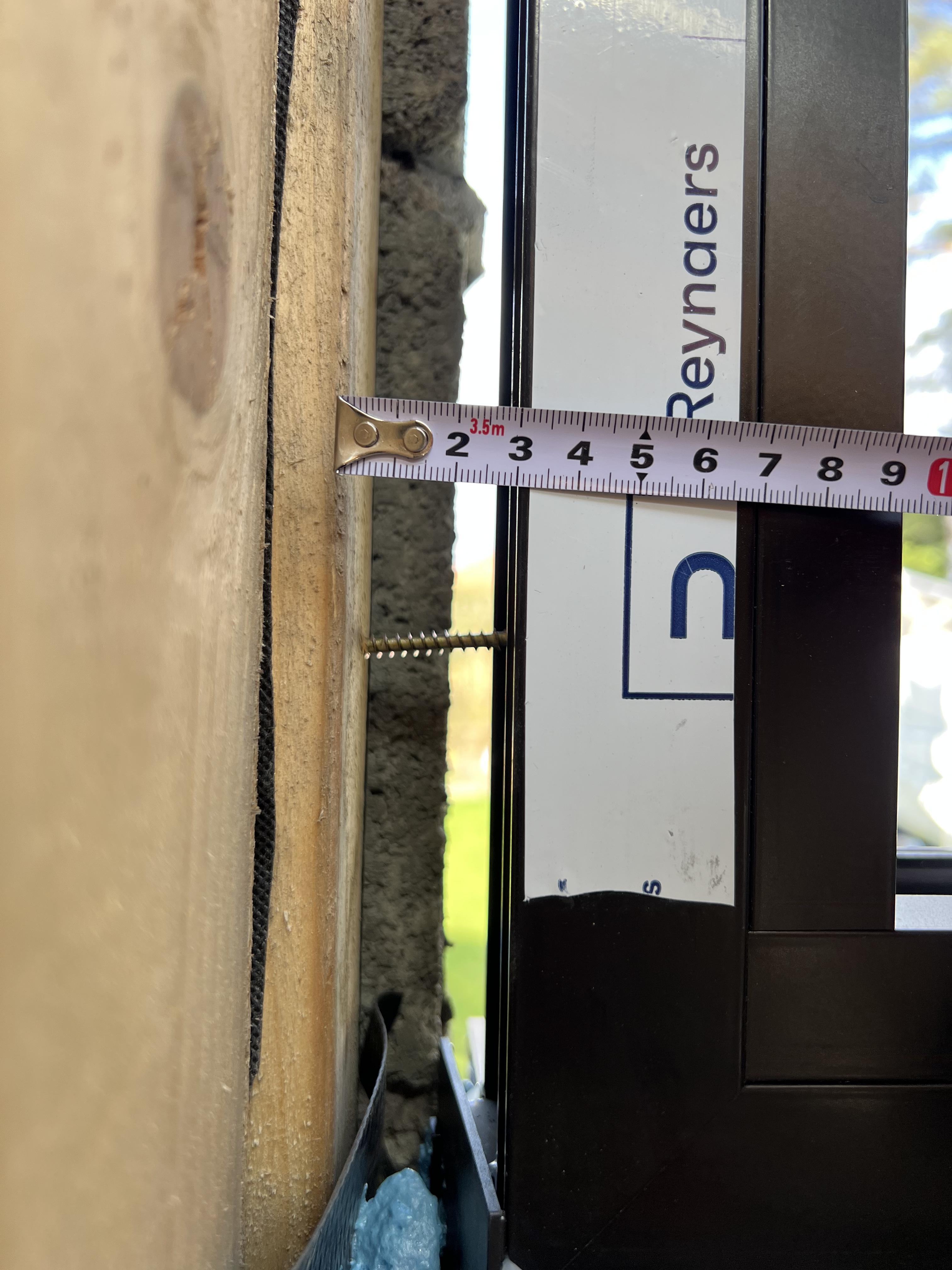

  17. A lot of it has similar 30mm gaps! Even a large Tilt/Turn window looks to be off plumb by around 7mm at the bottom (measured with a laser level) The issue is, it wasn’t the cheapest quote , we paid for a bespoke service and tbh this isn’t meeting our expectations That angled window is 4m across, I haven’t worked out the area of glass that’s missing, but it’s more the aesthetic of the finish, as we wanted to hide some of the frame behind the block work (which the builders have created the recess to allow) If I swallow this, it means we have more render making the it look not as we wanted.
  18. That’s the kind of answer I expected, though didn’t want to hear! 😂🤦🏻‍♂️ In your professional opinion, what’s my options? Am I being unreasonable asking them to manufacture it again?

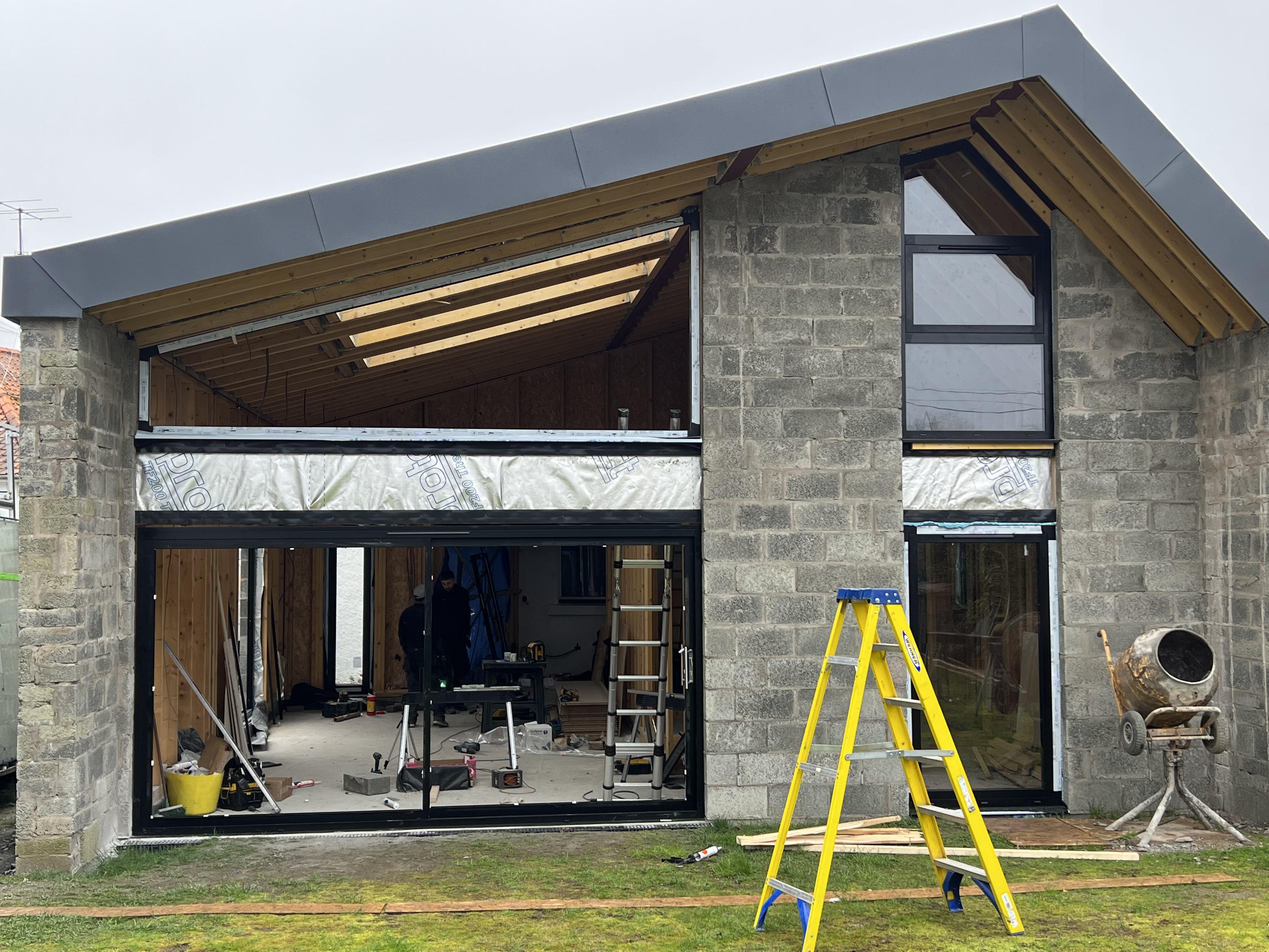

  22. Hello folks. We recently started our glazing install on our new extension. The glazing company hasn’t been back for a week or so due to an error with a door that has been ordered incorrectly (50/50 blame with us and the company I feel). Anyway, we are having quite a large shaped, fixed window installed above a sliding door This was measured by the Sales chap and one of the senior installers. There is a 30mm gap all around the frame where it (is supposed to) fit against the timbers & masonry. Is this really an acceptable tolerance for a bespoke measured measured job? Opinions gladly accepted They haven’t yet fitted the glazing to the frame. We we’re under the impression that the glazing frame should sit in behind the block work, giving a slimmer sight line, then attaching to the timber frame? Thanks in advance for opinions This I feel is just the tip of the iceberg on a badly measured job, or am I being picky?
  23. Hi folks….. We have been long term lurkers on here before saying hi, before we start looking for solutions and asking silly questions with obvious answers! We are building an extension to a parents bungalow, to allow us to move in with them and be present during their twilight years. We are nicely underway, having had agreed with our main contractors to build the main structure to watertight , bar the glazing. We are about 3 months behind schedule, but that’s due to inexperience our end , figuring it out, researching, and making sure our part is done properly to completion. Anyway, just a quick “Hi” before you get bored of us asking stupid stuff that’s possibly been asked a hundred times before . Thanks in advance for your patience 😂 Here’s how we sit so far
