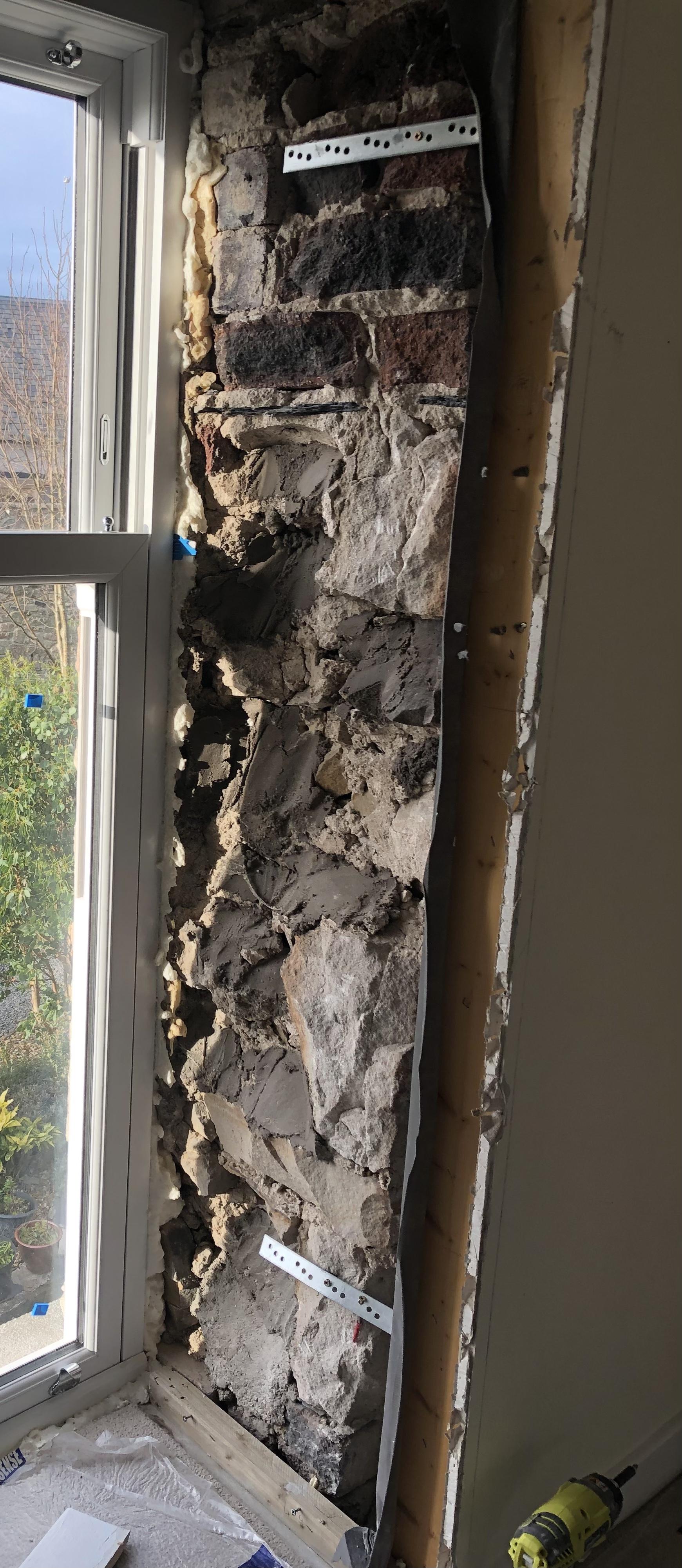

  5. Looking for recommendations for insulation around window reveals. Just had new upvc sash windows put in our barn conversion, replacing rotten old ones, however the new frames are far thinner than old, (window company cockup) so im struggling with some of the reveals and getting some insulation in there. The tightest clearance is 20mm. Looking for advice. I had thought about using super quilt, but without the recommended battons, or using some insulated board of some form. I even tried Wedi board, but it’s too brittle to support a plaster finish and kids. attached photo is of one of the better reveals, I’ve been able to get battons and 20mm PIR in here.
  6. Incase someone in the future searches for this, I spoke to Wedi. They say don’t use PVA, recommend SBR or a acrylic based primer. However in the same sentence they also say use whatever plaster manufacturer recommends.
  7. Any recommendations for primer? Wedi say yes you can plaster onto it, but with a “suitable primer”. Anyone used one that’s worked? pva, sbr or febond blue grit?
  8. Yeah that’s the major concern, even with the mvhr, there’s going to be a big difference in temp, with the kitchen next door, humidity is going to be higher

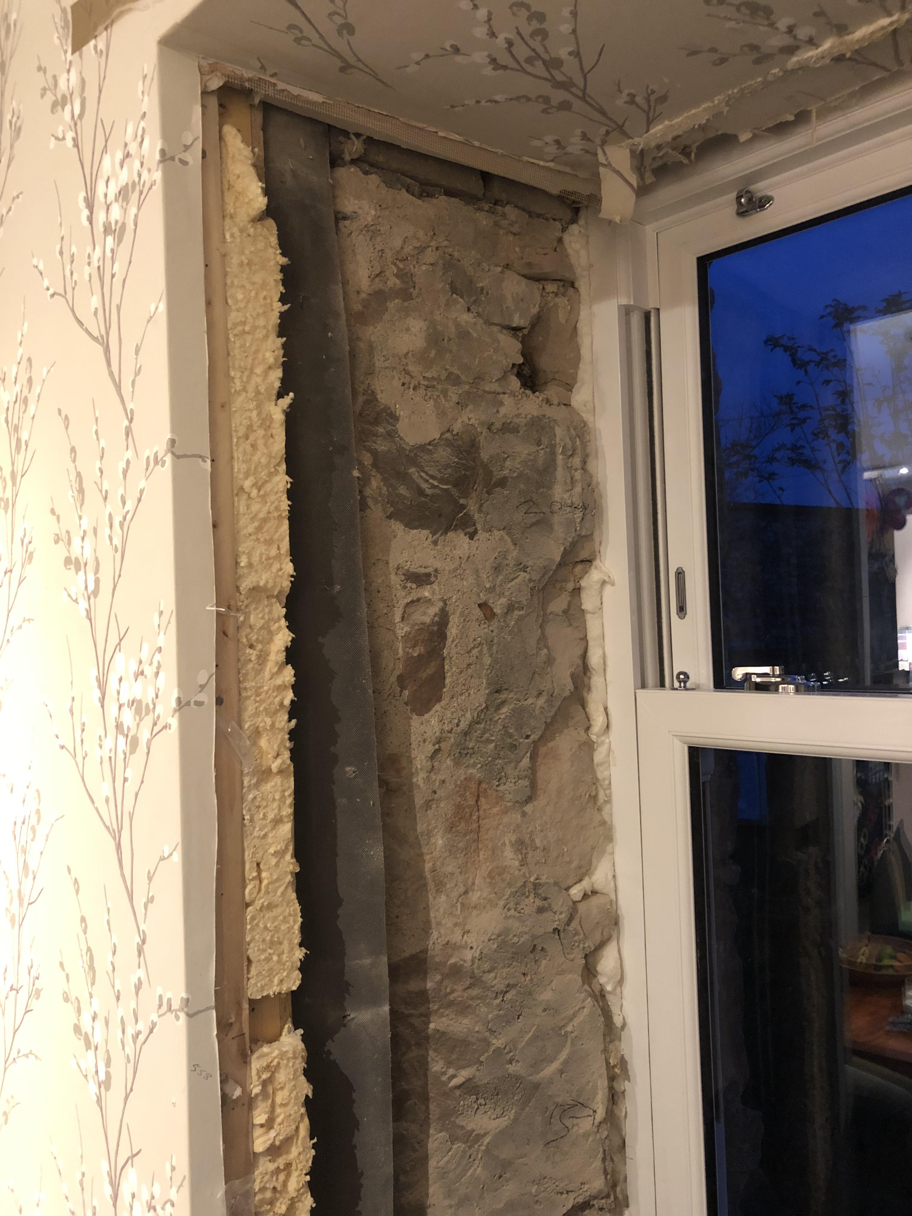

  9. Short - Daft idea is to leave external rubble stone, window ingles open and on show. I’d re-point it up in lime and probably give it a few coats of a (hot) lime-wash. Long - I’ve just had 10 new windows put in, and there’s been a bit of a surprise behind one of the existing stud/PIR insulation walls. During the original conversion, they never removed enough stone on this one window opening. So the stud work was only about 20mm thick, as was the pir. The new window has thinner frames, so I’ve subsequently only 13mm to play with, between stone and window opening mechanism. Now I either take out stones/sthil saw offending stones, to give me some space, to rebuild… or a leave it open and on show. I haven’t been able to find any dot-dab insulated plasterboard, thin enough, and can go on an external wall. Issues - I have a timber kit home internally, and a cavity, so closing that off might be tricky. Window opening is close to a kitchen, so household humidity is at its highest, but we have a MVHR, so rest of house sits at around 50% humidity.

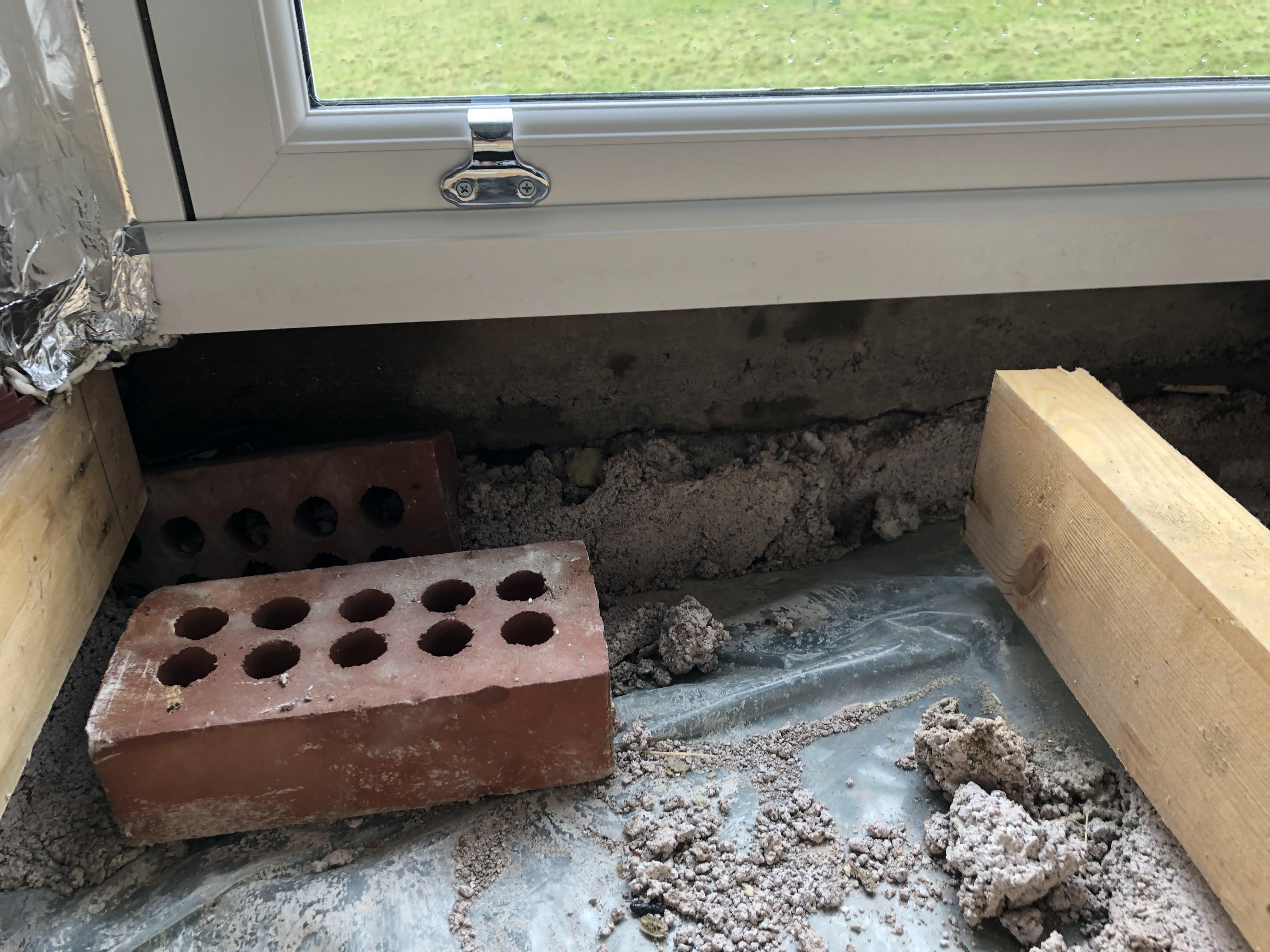

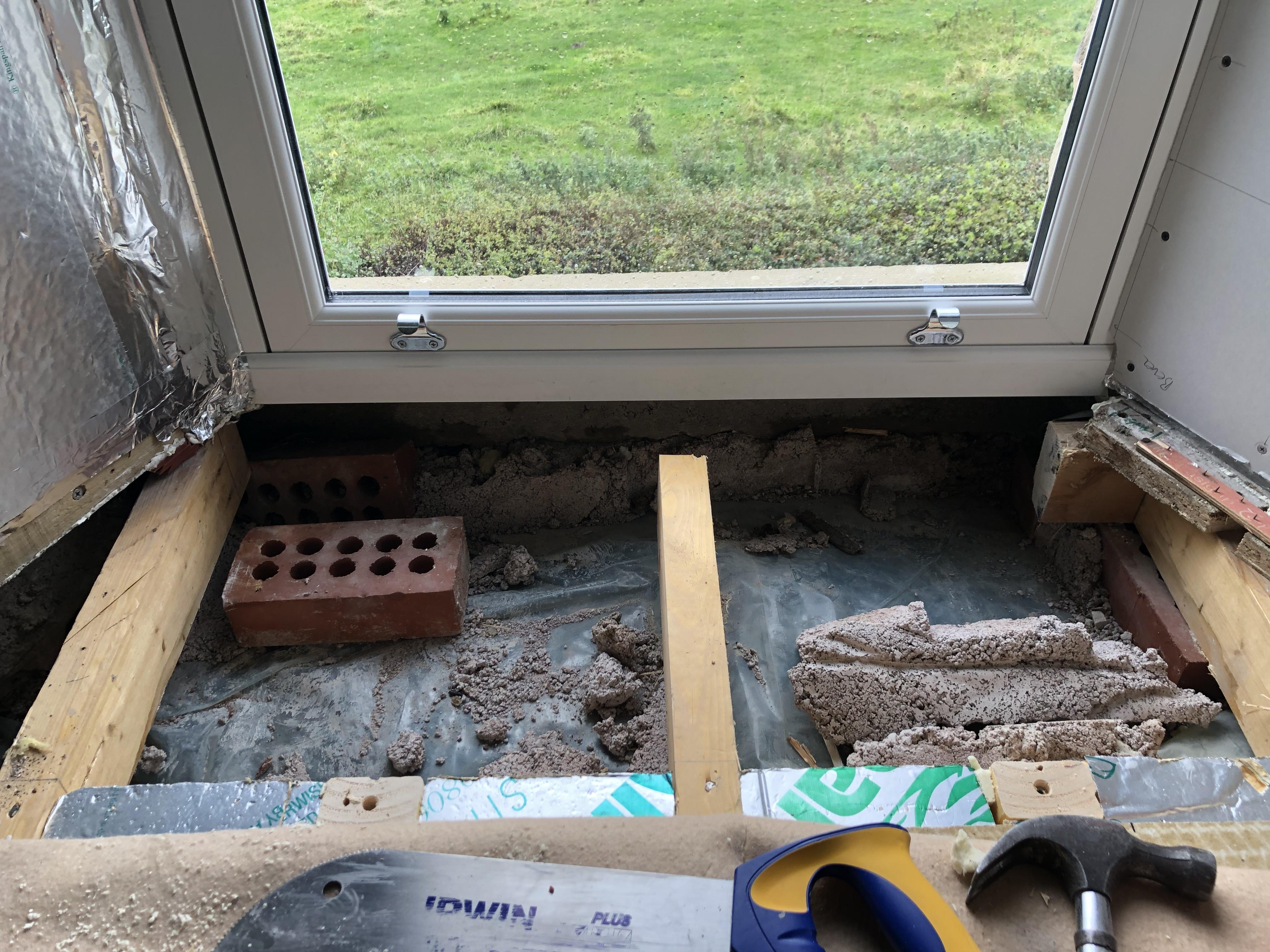

  10. I’ve just had a new window put in, and was checking underneath for a draft. Ive found the concrete-precast sill has no DPC or much of anything behind it. There was a load of bricks just chucked in the gap, prior to photos. The external building is a rubble-stone barn conversion, all done in lime. what should I do, back fill the sill with lime mortar, to try and minimise water ingress? no way of getting a DPC in.

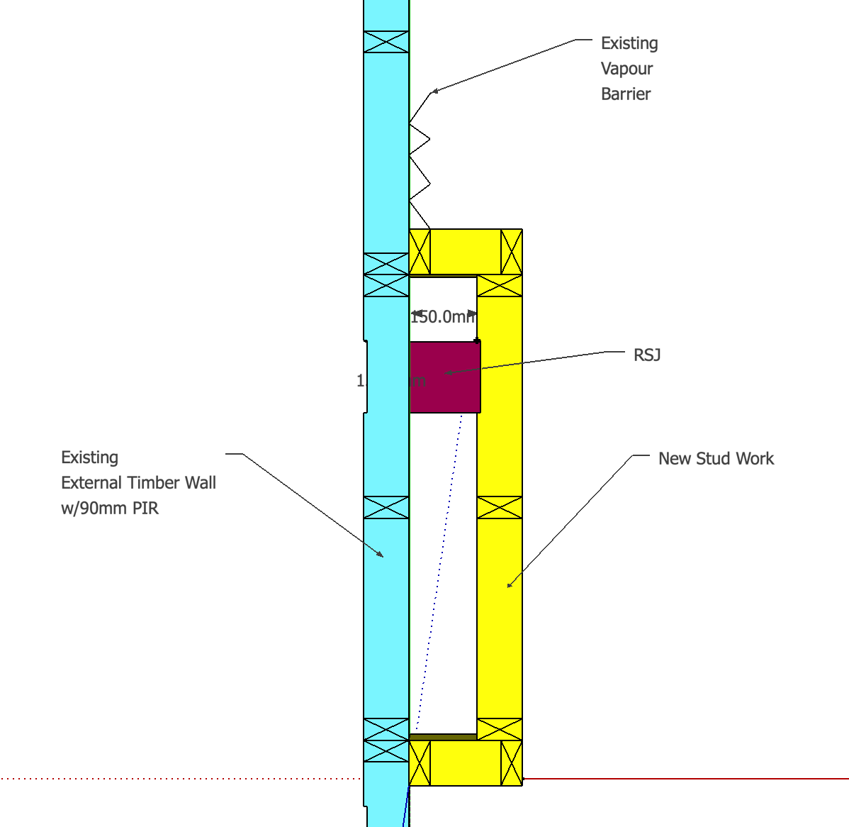

  15. I'm finishing off a faux chimney breast stud work around a RSJ, and a little unsure where best to place the vapour barrier. The whole RSJ is within the internal/warm side fo the building, however it is against PIR on a external wall. The existing PIR external wall had a vapour barrier upon it, which was removed along with plasterboard. I was going to reinstate the vapour barrier behind the new plasterboard, which would place the RSJ, Rockwool AMW 60 insulation on the external side of the vapour barrier. The faux chimney breast cavity and RSJ will be sat on a screed floor with UFH buried within.
