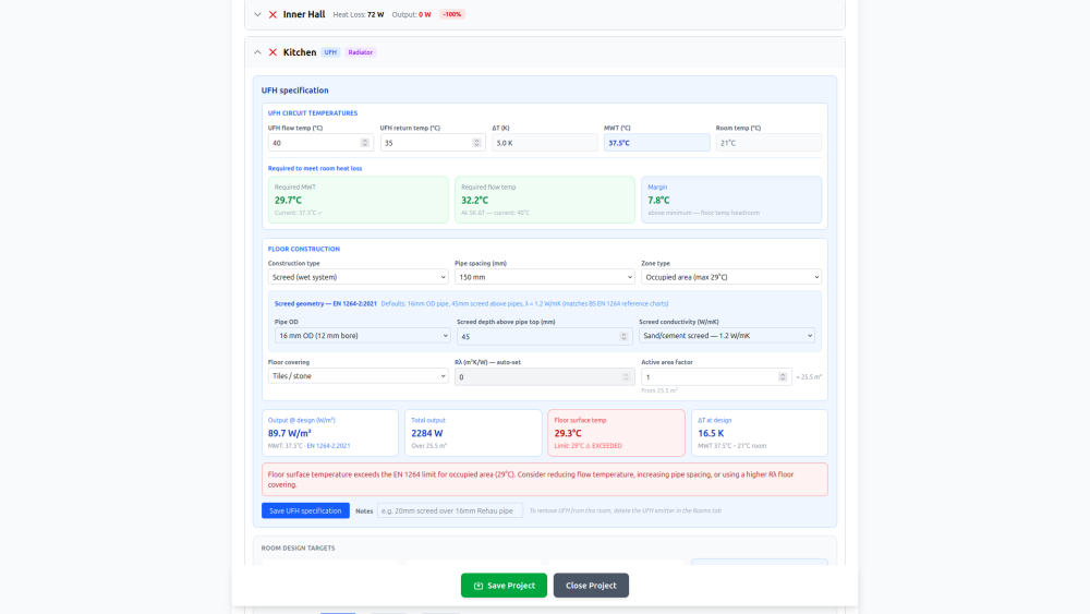

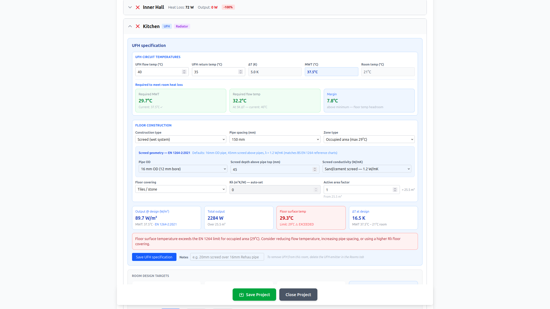

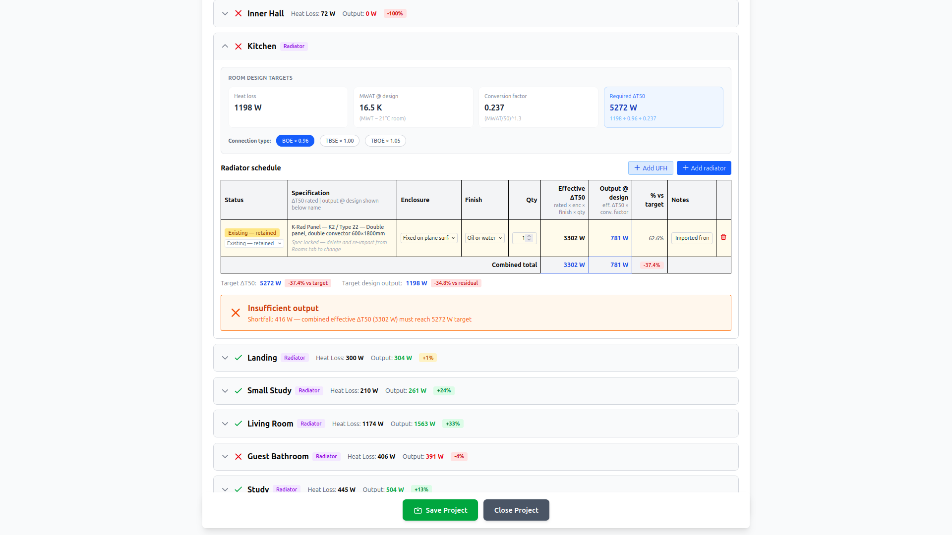

Yep. https://openheatloss.com. It will do all the UFH output calcs room by room based on flow/return temps, room heat loss, pipe spacing and floor covering etc. and provide floor surface temps and over temp warnings.

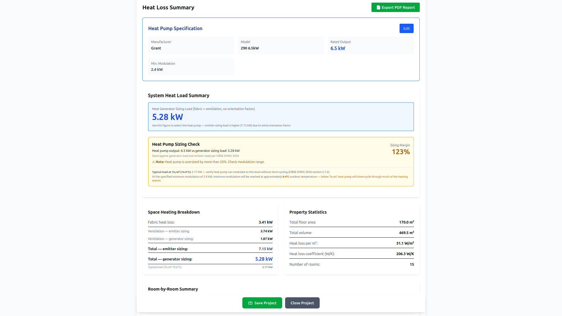

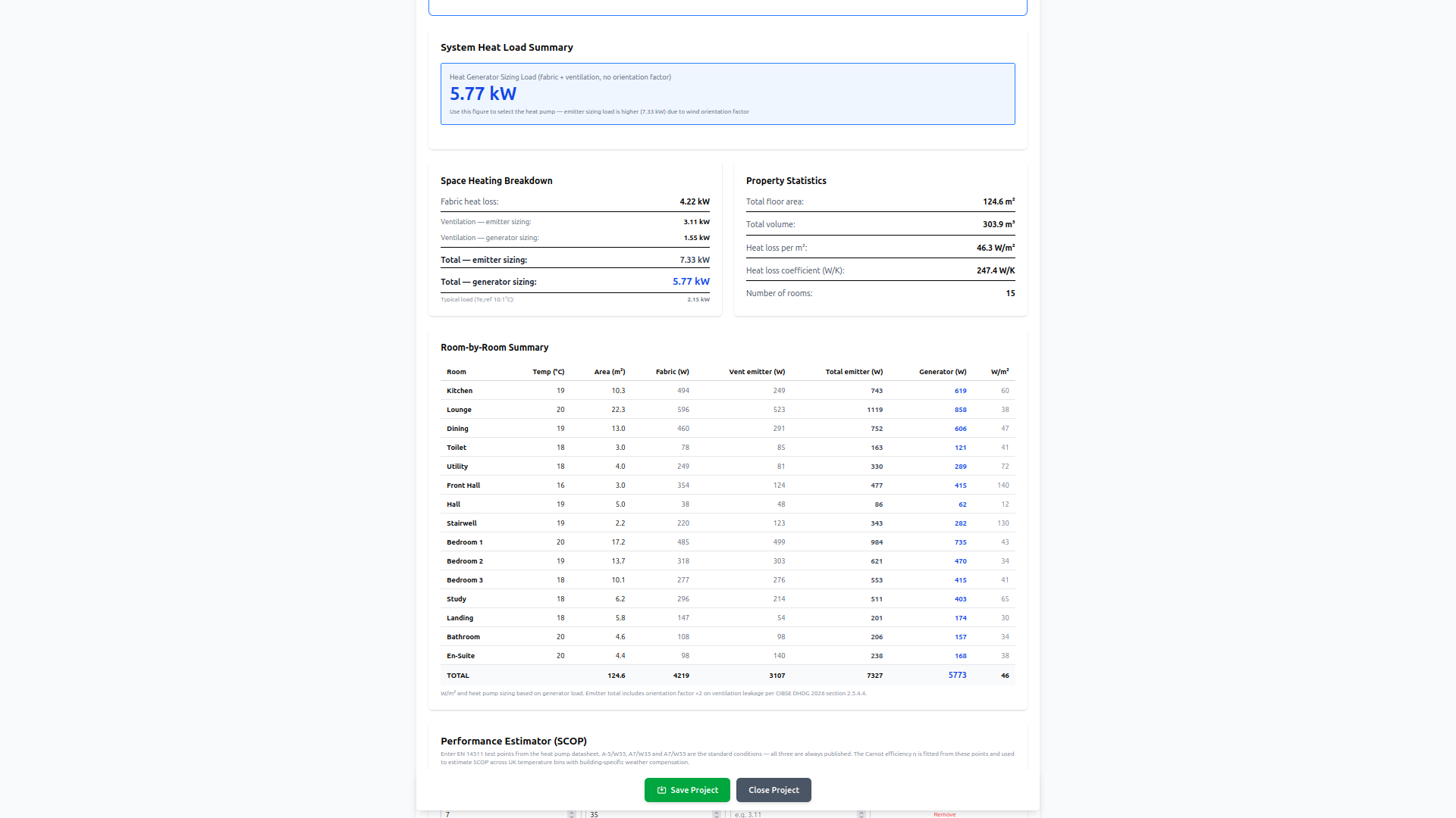

If you want the BUS Grant, then you have to have MCS sign off. The important thing to understand is if the 'designers' have actually calculated in the MVHR into the heat loss. Most don't as they either don't have the understanding or the tool they use doesn't use a method that deals with whole house MVHR. For example, the new 2026 CIBSE Domestic Heating Design Guide method specifically excludes whole house MVHR. So check this before making a decision on the heat pump. You can use my tool at https://openheatloss.com as this does cover the BS EN 1281 standard for whole house mvhr. 105l may be okay, but it's important to know the minimum modulation of the heat pump first. Low temp running loves lots of volume. The Panasonic wifi connection is required for the 7 year warranty on these pumps. But commissioning cannot be completed merely using remote access as proper commissioning involves a lot more than this and has to involve an onsite visit. Unfortunately proper system commissioning is often misunderstood and undervalued. To get it done right it takes time. This design has other advantages often overlooked. It has built in expansion vessel good for a system of 200l volume. It also has a backup heater available in 3 or 6kW size so if there's ever a breakdown you have backup heating for your house. Overall, using the bi-bloc unit can be neater and more space efficient than installing another monobloc with all the additional expansion vessels and controller wiring as this is also all contained within the bi-bloc unit, especially if the alternative heat pump also requires an external circulator. E.g. installing a Grant heat pump is a pia in comparison and that's an easy heat pump to install. -
