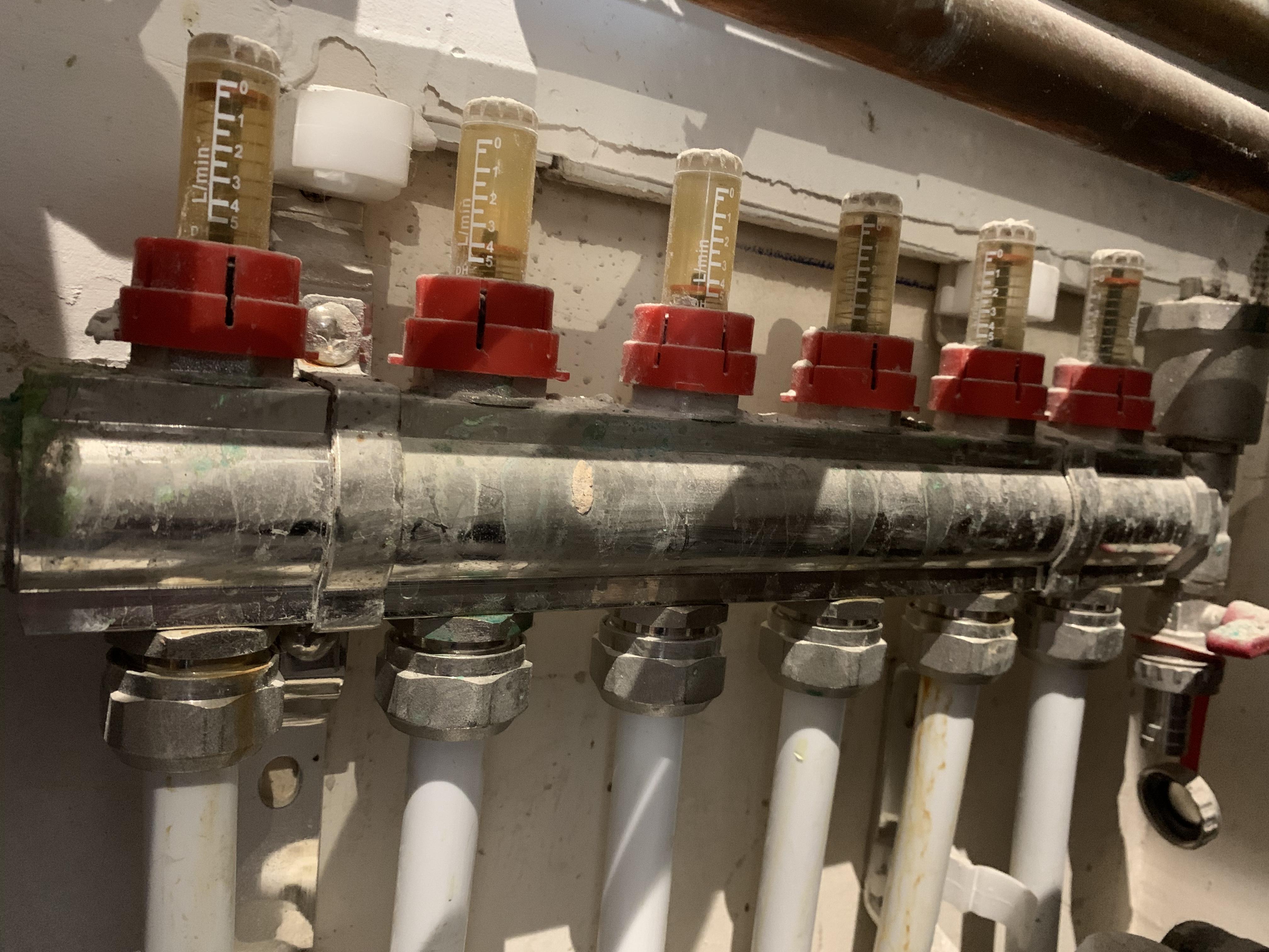

  1. Which caps now sorry? Ontop of the manifold outlets? No I have I’ll have a chat with the design see if I can get them. What will that say what flow rate to send around each loop?

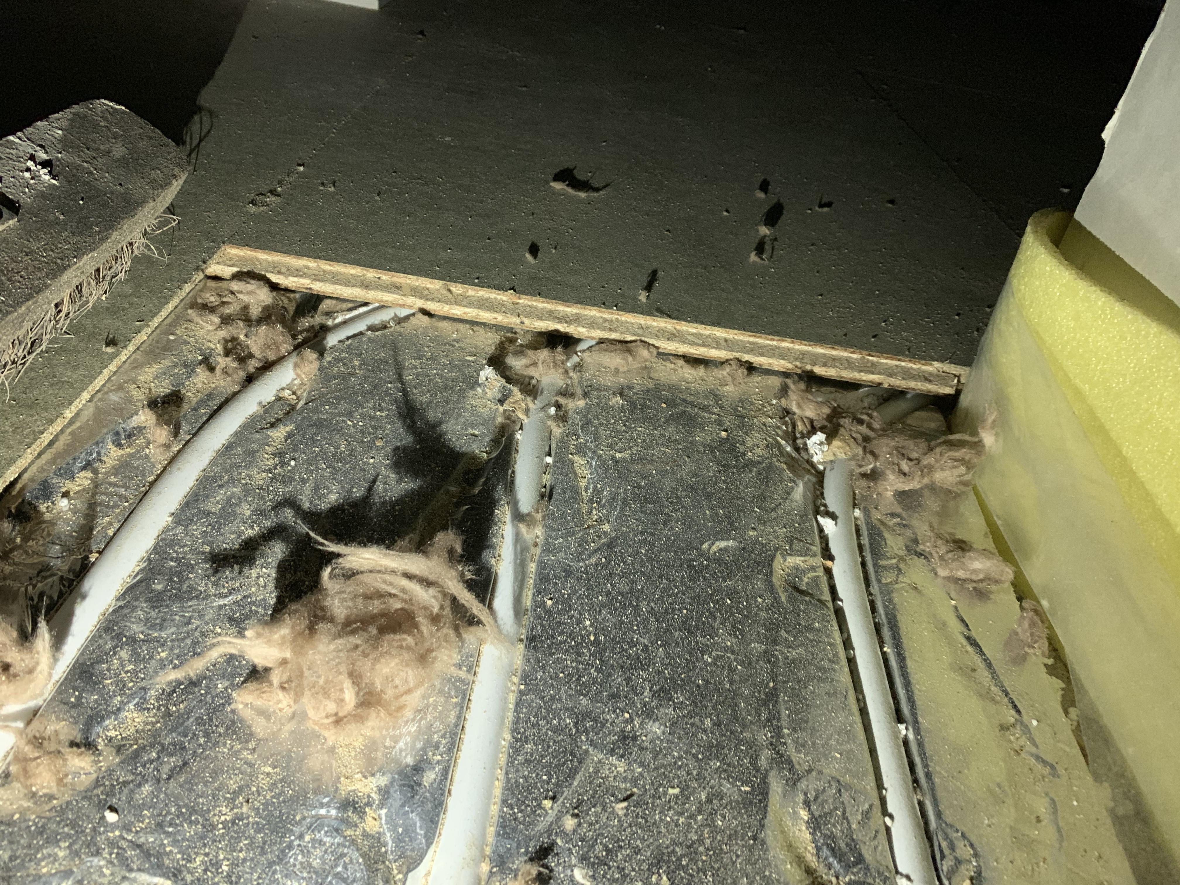

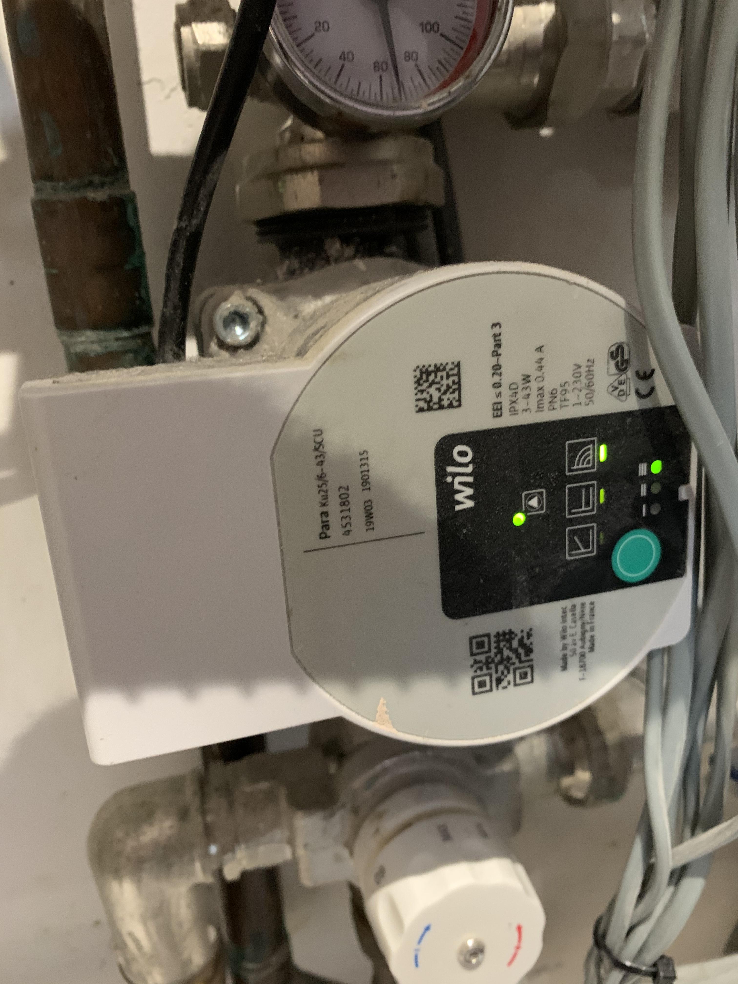

  2. I thought this we also have ply ontop so no wonder it takes a while to heat up! Guess there’s nothing I can do about that now though? Could we lay flooring and tiles straight ontop of the thermal boards that the pipes lay into? Thanks for the adjustment info, there was only two zones on at the time, should I run all zones then adjust the cooler rooms for more flow and the warmer zones for less flow? does anyone know what the pump setting is meant to be set to? There are multiple setting which can be seen in the photo? It’s on the highest most powerful at the moment?

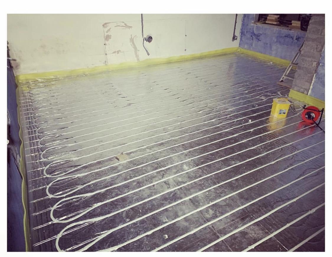

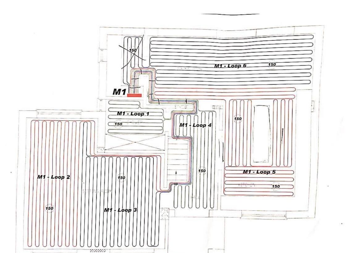

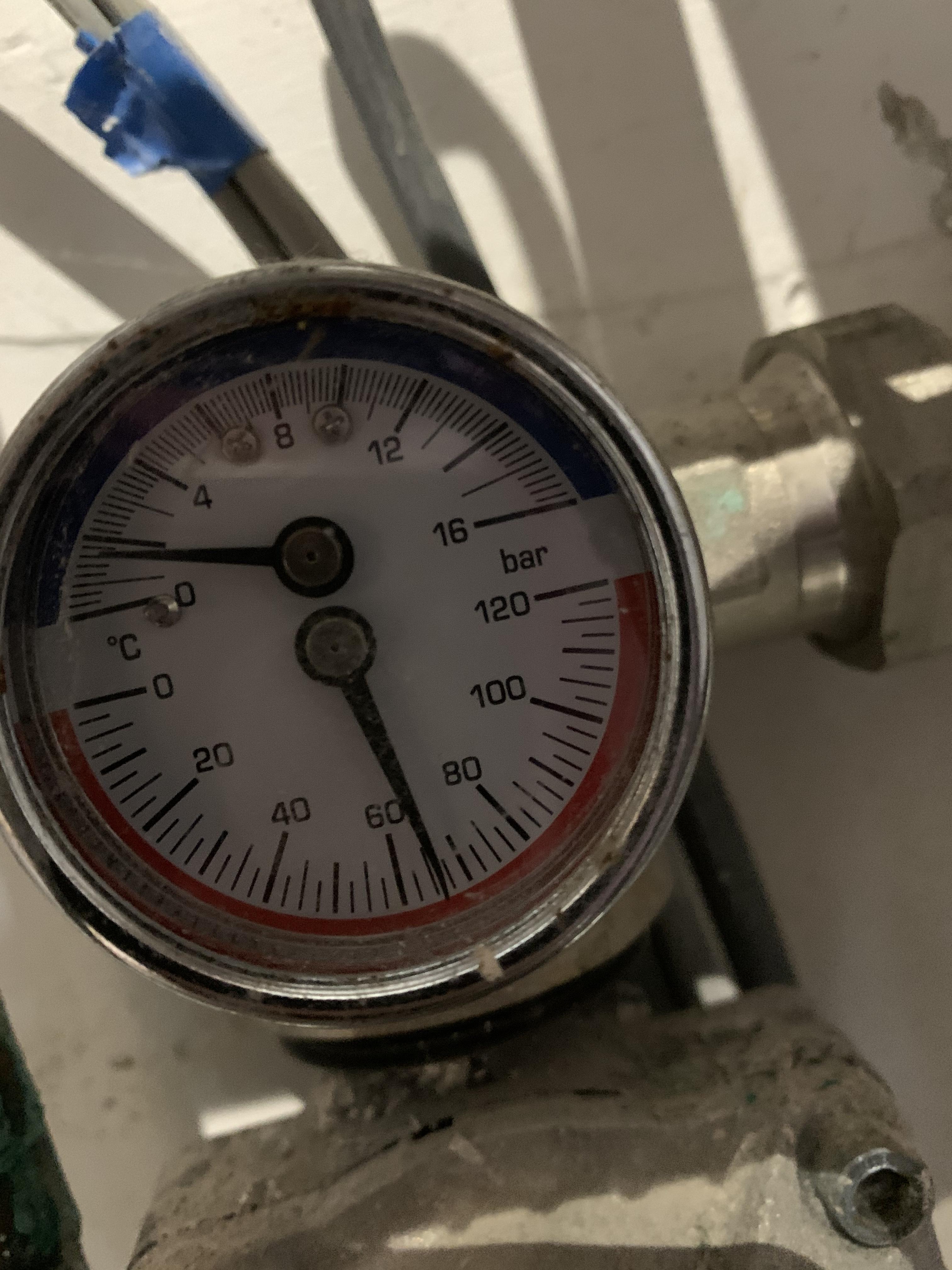

  3. Good evening all, I was after some advice please. We have an underfloor heating system installed with 8 zones. We are finding it takes quite a long time to heat under on certain zones. What operating pressure should the system be at? Ours is currently set to 2 bar? We are finding that front room is colder than the other rooms, the UFH is installed under floorboards in the insulation boards supplied, ontop of the floorboards we have tiles and wooden flooring. Is this right? Will the heat travel through this many layers? This is what was recommended at the time? Also what should the pump setting be set at? There are serval settings which can be selected from the front of the valve? Without leaving the UFH on all day being controlled by the thermostats it does take quite a long time to heat up? I’ll forward on the plans and the photos of you could get back to me that would be great? Cheers Ash.
