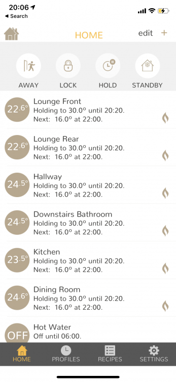

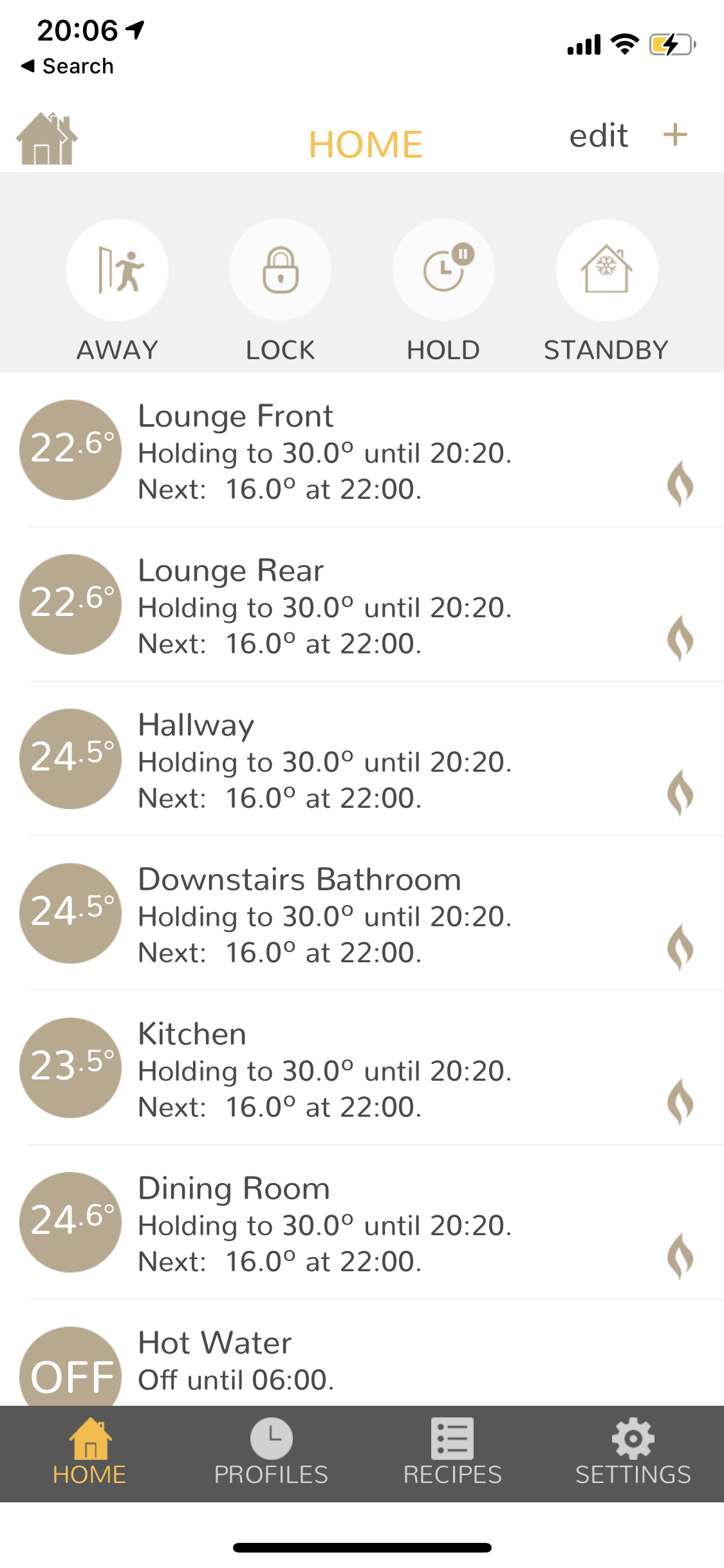

thanks for the info, I’ve attached the trends over the last week, baring in mind there are some sharp spikes where I have been playing around with it! Also I’ve attached the profile I’m using, we aren’t in the house during the days only in the evenings so I’ve set it to heat up as below? Would this be more energy efficient?- 57 replies

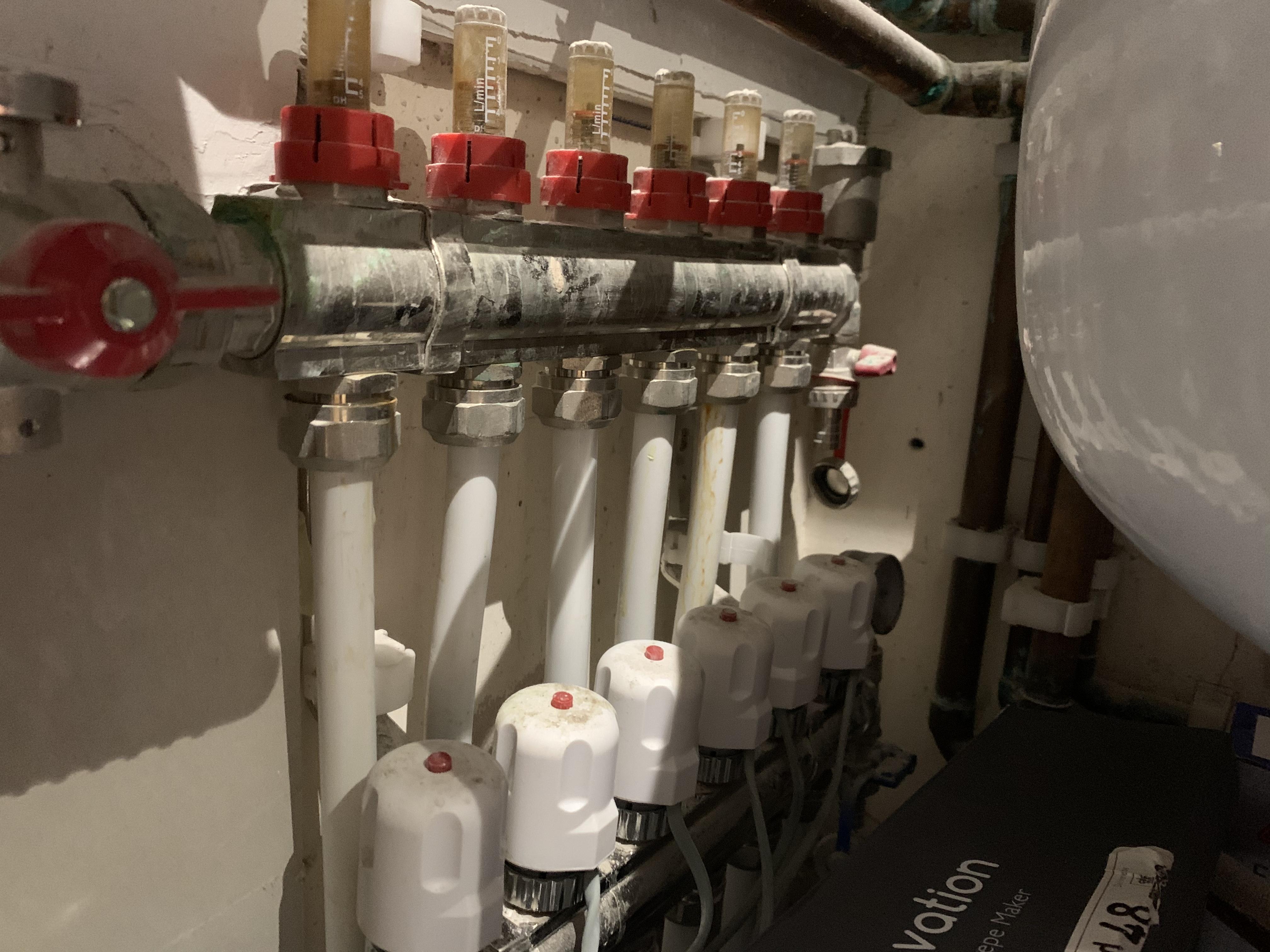

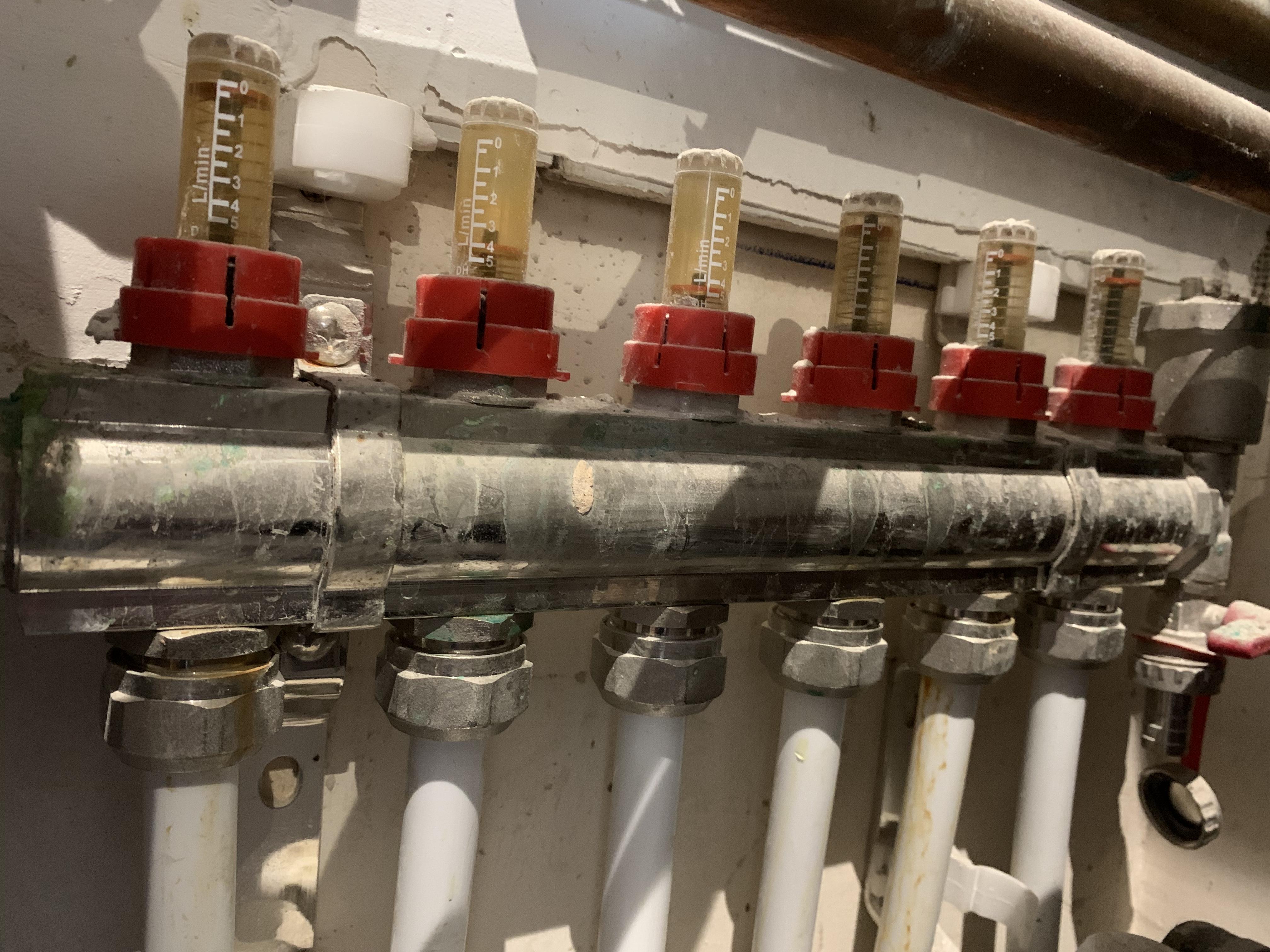

So the room has two loops in it. I can monitor that, the max flow rate I can get on the two loops to that room is around 4 l/min is that ok? That wound fully out. To get all the rooms to warm up the quickest wouldnt I just wind all the flow rates out to max 4 l/min?- 57 replies

Heatmiser neo stat v2, UH8 system, individual room wired thermostat's.- 57 replies

Im pretty sure they are 230, just to throw this into the mix, the plumber fitted a rad also down stairs with a separate electronic valve, this is wired off the hallway thermostatic so operates when this zone is called for heat, would this make a difference? I did read too much flow can be just as bad, I've wound the zone 2 and 3 all the way out for maximum flow, perhaps ill try throttling these back first. The installer did say going through 3 layers (floorboard, ply and the flooring) would reduce the heat but you'd think they'd be hotter than they are, the only other difference is the warm rooms hav tile flooring and the cooler room has laminate, this has underlay also?- 57 replies

Yes each room has its own thermostat. Only to test its not always set to 30'c. Ok do you need another system or does the actuator do it itself? there only trade prices on the link, any idea how much these would be? Cheers.- 57 replies

No it’s the sitting room loop 2 and 3? It says there’s carpet there on the design but we went with wooden floor, also it’s the part of the house without anything built on top? I’ve wound all other loops low now and kept the sitting room loop 3 and 2 up high to see if it makes a difference?- 57 replies

Here are the pipe length and flows. 3033REV-3-Ashley-UFH-plans-Design.pdf- 57 replies

Brilliant thanks, this was with all zones online so I will try and adjust the zones which don’t have enough heat.- 57 replies
