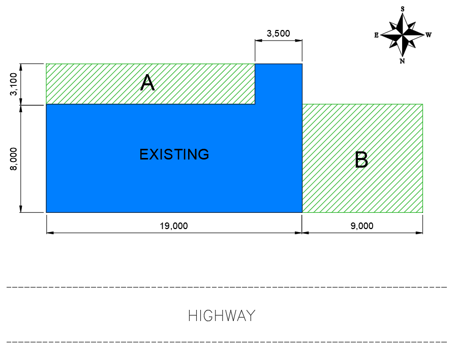

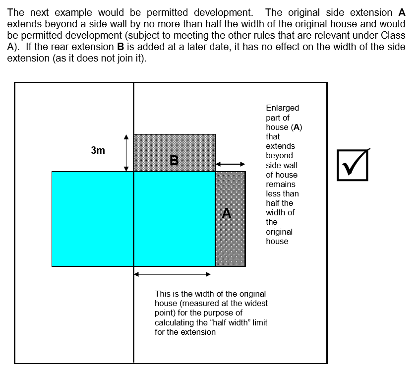

Thanks all for your valued input! We have come to the same conclusion; that the small protruding portion of original dwelling creates a rear & side PD extension issue, which in our instance hinders a rear full length extension. Should it not have ever been there, or have been a previous extension to the main dwelling - we could have extended fully along the rear without challenge, what a silly quirk! As such we are revising our scope to remove extension 'A' altogether, and increase the size of extension 'B' to finish flush with the rearmost section of the house. As we see it this would be fully compliant with PD for a side extension as it is less than half the width of the existing dwelling, and would still give us a similar square meter-age overall. Is this how you see it too, we would be interested to know? Thank you
Hi there We joined the forum yesterday and used our 'introduce' entry of the new members group to outline a question we have over permitted development rights and how rear and side extension potentially inter-relate. In hindsight, we probably put too long an entry and over-complicated our question, so we felt it was probably better to refine our ask and add it to this more specific group. So here it is.... To help describe the question we attach a visual representation of our wish here. extension? Basically, can rear extension 'A' cover the whole back part of the property as it does not join 'B'? In other words, as 'B' uses the full half width condition, does this use up allocation for 'A' in the rear If it helps, our longer entry posted yesterday explains all other elements to our plot to pre-empt other questions which may follow to help get an answer to this. Really grateful for anyone who can help us understand the 50 page technical guidance issued around permitted development rights. Thanks in anticipation.

Hi all We are keen forum readers on just about every topic for every purchase we make and contribute where we can. As we are just about to embark on our second major house renovation, we feel we could do with a little more peer support so joined you in this community so a hello from us! Also, we have an immediate issue which we go around and around in circles over and that's permitted development rights and prospects for our bungalow and the inter-relationship with side and rear extensions that we plan to do. We read the 50 page document Permitted development rights for householders - Technical Guidance and think one way and on another read we crack something else and then doubt ourselves of what we thought we already knew. Our main question below relates to whether the rear extension we plan to seek to do under PD rights can cover the whole rear of the bungalow. We include a drawing to show layout and the proposal. 1. Our existing detached bungalow is generous in it's width (over 19mtrs) and we benefit from no near boundary or near neighbours in an acre plot. It's orientation to the road and our principle elevation means we can hopefully capitalise on it's orientation. It's rear is south facing towards the view. We understand that a side extension (which we show on our drawing as 'B') can be single storey and up to half the width of the dwelling (4 mtrs max. height). We've shown 'B' as being therefore 9 mtrs to maximise that half width and also made it as deep as the existing dwelling (happens to be 8mtrs). We'd also like to complete a rear extension, shown as 'A' and though we realise we could gain up to 8 mtrs in depth (providing we do the neighbour consultation) we have for neatness sake only taken it out as far as the existing rear section. Rear extension guidance doesn't appear to limited to half width provision like side extensions do. Is that correct? In our example, proposed extensions 'A' and 'B' don't join. They're separated by the original dwelling-house existing stepped out section (the 3500x3100mm part shown also in blue). This was not a previous extension (i.e. it is the original dwelling despite appearances) so we understand doesn't need to be deducted from our PD allowance. However, we wonder that as the stepped out section has both a rear wall and a side wall, will 'A' rear extension be curtailed to forming part of the whole calculation for half width, if we also build 'B'? The closest example that matches our floorplan in the document aforementioned is on page 28 (see also attached), which shows it is ok for PD rights as 'A' and 'B' do not join. That example would appear to suggest the total width is greater that half, whereas earlier examples in that document show that if these were to join, the total of them cannot exceed half width? 2. Another curiosity is whether 'A' and 'B' have to been constructed at distinct and separate times for PD? Is that right and if so, how great a pause in-between builds is required? This seems odd to us. 3. There is also the prospect of making 'A' deeper, coming out by either the balance of 4mtrs (so 900mm) and carrying along the whole back wall or if we want to go full steam ahead, the 8mtrs with neighbourhood consultation? We understand that no more than 50% of the curtilage can be built on, including the original dwelling-house in that area, but with 1 acre that's an issue for us. However, we've read conflicting issues over whether you can only extend by a percentage of your total area of the dwelling-house. Our proposal could end up being over 50%, particularly if we make 'A' deeper. Is there anything like this please which limits how big we can go? We're also aware of the over 100sqm issue for CIL purposes, but that's the only square meter aspect we've read about. We're attempting to construct what we can under PD rights. Saying that, if planning permission gives us a better house ultimately, we're not closed to this route. It may be, that as we're currently pebble-dash with ugly red concrete roof tiles and double glazing which we'd want to replace (with bi-fold and picture windows within the new extensions facing the view) that we will not be able to complete the build effectively enough under PD, so are prevented when looking at those class matters too. Anyone who is interested in this area and puzzle and wishes to help answer this would be very welcome....Thank you!
